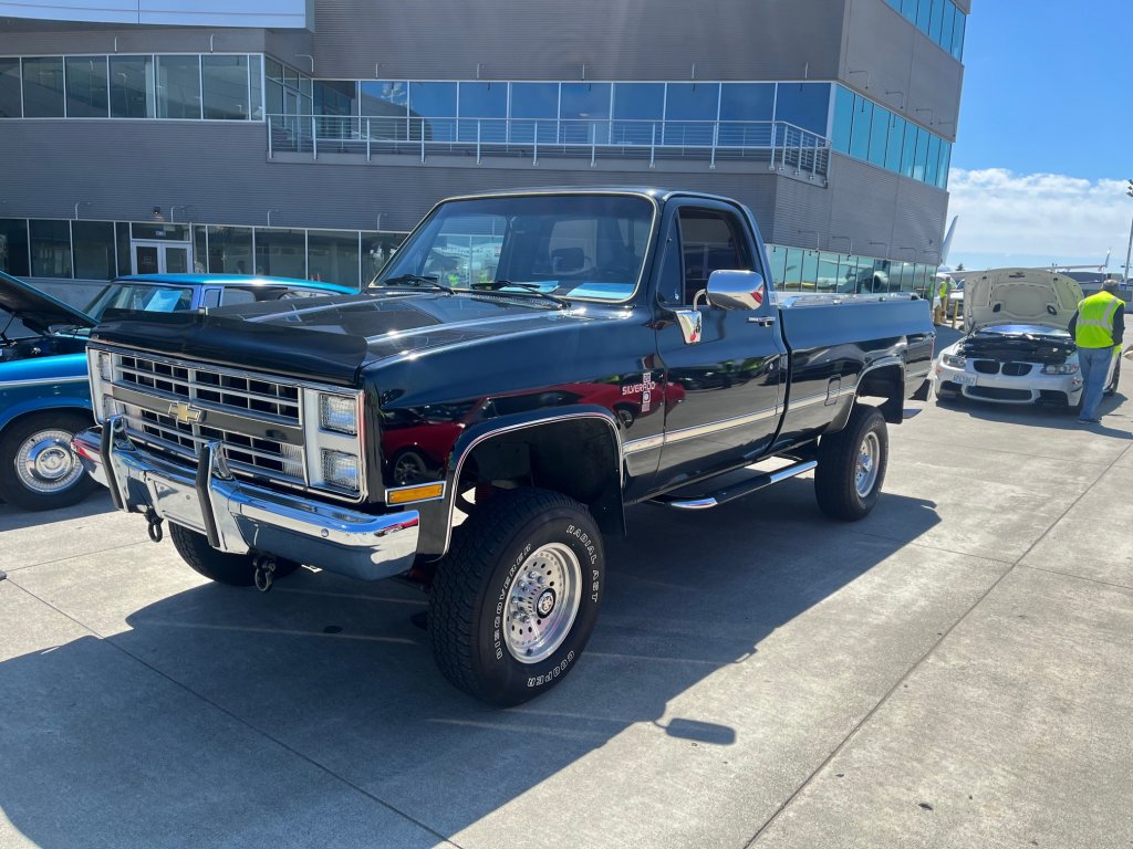

I drive my 6.2 daily and have'nt had any issues with it as far as parts wearing out. It has the Banks glow plug conversion on it so they don't come on unless I turn them on. All the comments about sluggish are spot on, niot fast enough to get out of its own way but I'm never in a hurry to get anywhere anyway so its really a matter of what feels good to you. I love driving mine.

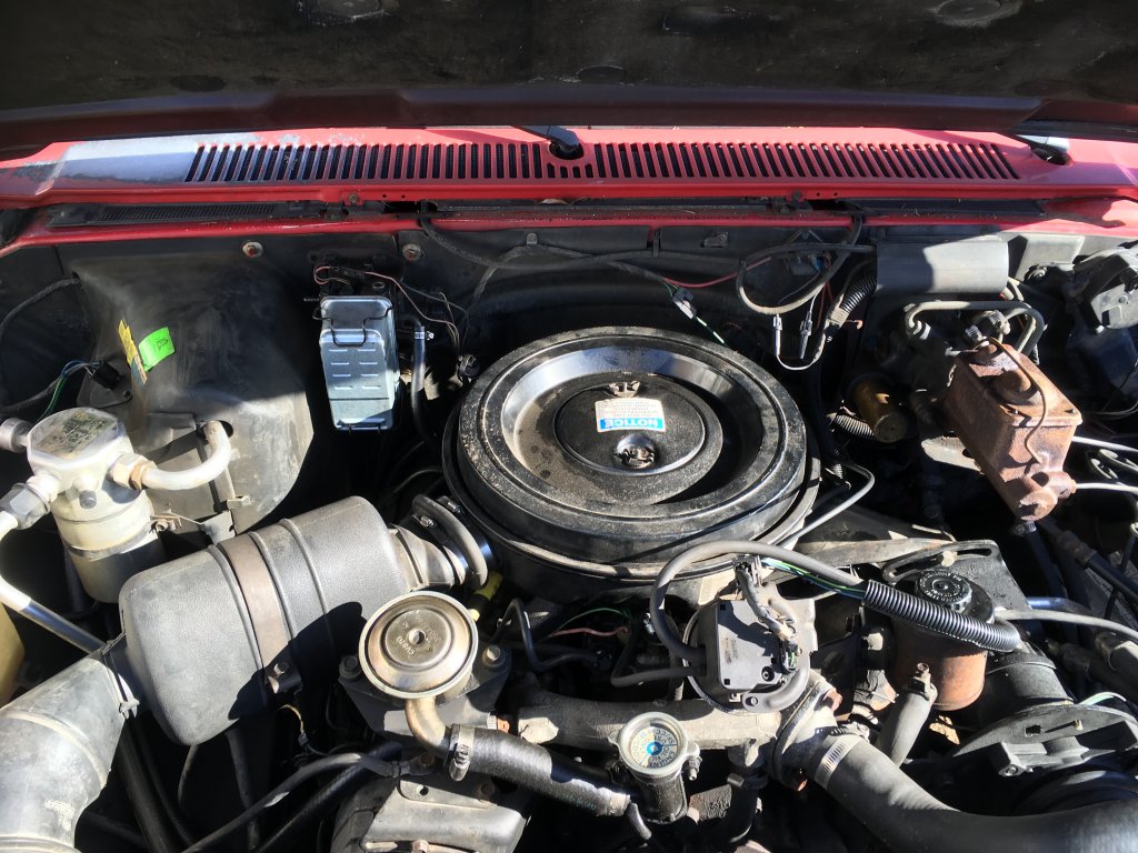

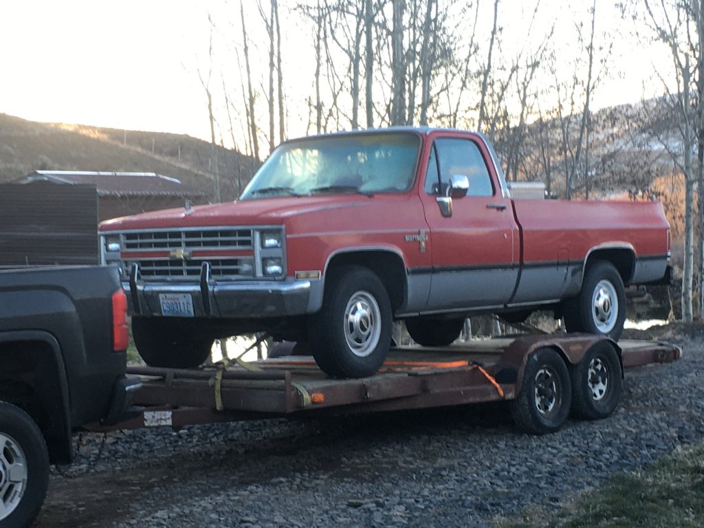

I have a 85 6.2 that I bought a few years ago, and have been tinkering with it to no avail. New glow plug controller, rebuilt fuel injection pump, new block heater. Gets fuel to the injection pump, weeps out the fuel lines when I crack them open, but no start so waiting for warmer weather. Want to get it running and reliable, so I can tear down my 73K20 and finish the restore. A well optioned interior with the center wood cup holder, (cool man,) cruse, perfect no rust body. I have a 6.0 LQ4 with a 4l80e would make a sweet swap, but want to get the diesel running. I do not like working on Diesels...
