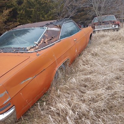

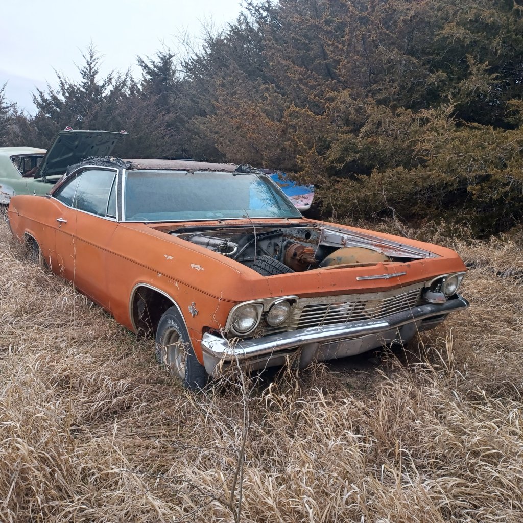

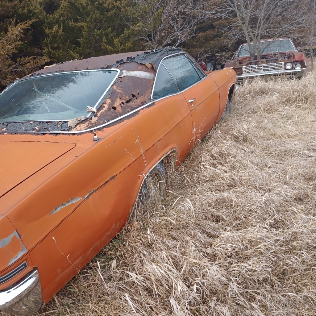

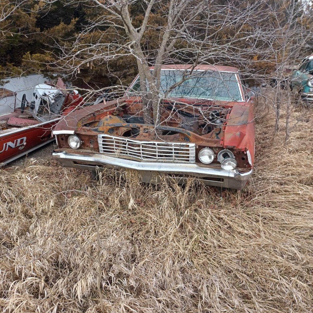

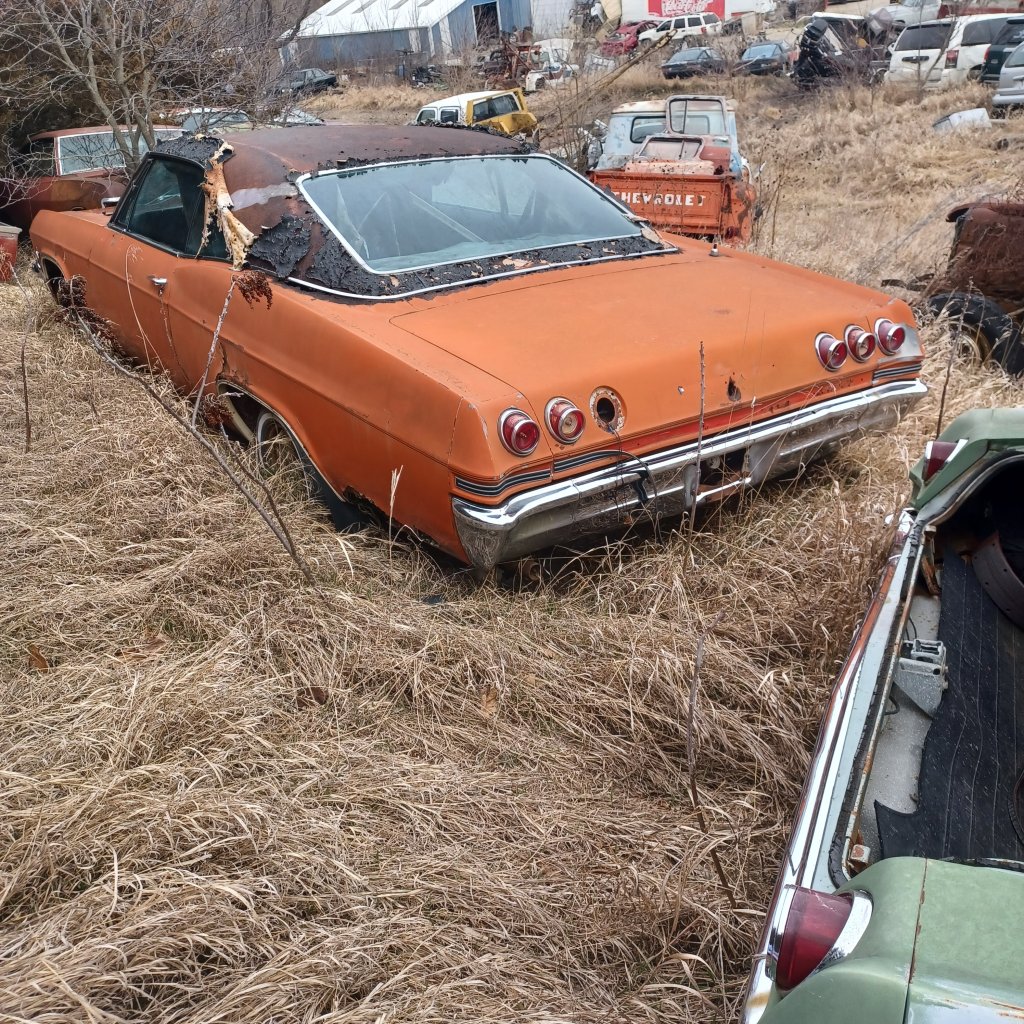

The cars came off the assembly line rusted out in Kansas. Speaking of which I ran across 2 real deal Impala SSs a 1965 and a 1967 they are so stripped and plenty of rust but real SS cars 1500.00 each IDK how firm he is. You would definitely have to have a beater 65,66 or 67 if any of you want to save one of them.

I had to drive 200 miles to see those.Tiny mom and pop junkyard in the middle of no where.Those two and 2 early 70s cutlass were the only old cars.
