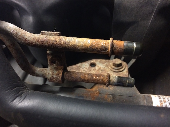

Hey guys 6.0L swap into my 87 V20. I have a brand new 87 fuel tank, and brand new 87 fuel sending unit with the 3 outlets. I also have the bosch equivalent of the AC Delco EP381 fuel pump. My intake has a send and return line. I have added a photo hopefully it uploads okay. My question is can someone link me a picture and part number of what regulator/fuel filter i need? Just a little confused as i see most who post on here have a single fuel line on their intake. So i just need to know what exactly i do need. Besides all the -6 AN fittings and braided line. Do i need anything else to complete my fuel system. I take it i need to order the 6pin selector valve from LMC truck, or is that not required? Any insight and helpful info would be greatly appreciated! Cheers from Canada!

I guess I didn't do my research, so my regulator is in my fuel rail. So I should be putting a fuel filter inline somewhere? And does anyone have a certain fuel filter they would recommend / Part #

so your fuel pressure regulator is on the engine? If it does you should have two lines going to the engine ...feed/return. If so just put in a filter. Look for what ever vehicle it came out of on Rockauto (we get 5% discount on top of the savings). If your rail doesn't a pressure regulator, then you'll need wix 33737. It's a fuel filter and pressure regulator in one, has return line built into it. I say that brand because folks all over the internet recommend it. I'm sure there's cheaper.

Okay thanks. Yes I do have two lines on my intake. So I guess i just need to put a fuel filter in line. thank you
