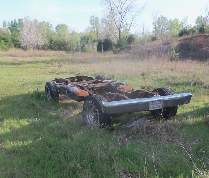

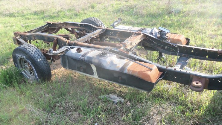

I have a 1975 3/4 ton 4wd gmc. I do not need 4wd do do have to pull heavy trailers so the 3/4 ton suspension is a good thing, The truck has lock outs on front so my thinking is put the lockouts in freewheel put in a turbo 350 from a car score a drive shaft from a 700r4 2wd truck and get on down the road.I am concerned about pinion angle 2wd vs. 4 wd anyone know if they are the same? What else am I not thinking of? Thanks
I was going to do it to get better milage if I can just spin the lockouts pull the front drive shaft run in 2 hi and get similiar milage thats what I'll do I thought those old cast iron transfer cases robbed horse power and were gear reduction.
Okay swapping to 2wd sounds maybe pointless I was going to pull the 4x transmission anyway because it has a pretty big torque conv. seal leak. and a bent flex plate. The truck has no A/C pwr steering is only acc. no exhaust yet I'm thinking it would probably be easier to pull the engine than the trans and transfer case. Anyone?
