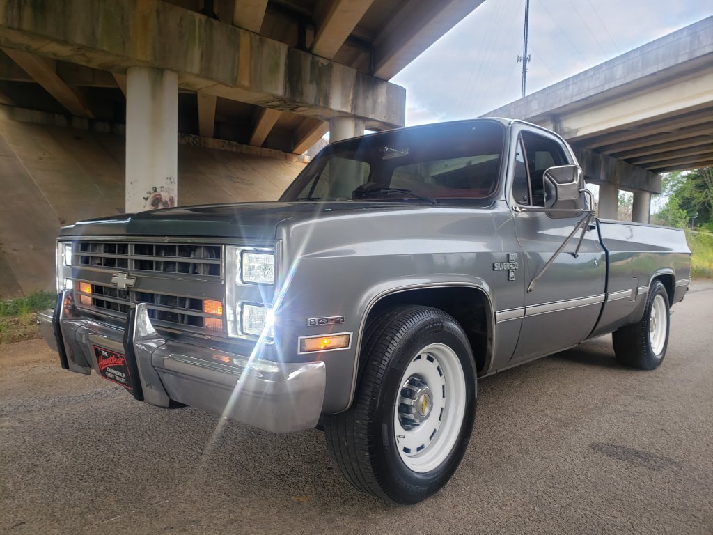

This is my tow build here for my 1987 R20 pickup. I have a 20ft trailer and a 2000 Z28 that i will tow on occasions or as needed. The truck is a camper special model. The truck has a 454/400 setup right now from the factory but it dont handle the weight of a trailer like a big block should. So i want to do a 489ci build that can run on 87 octane and make as much TORQUE as possible under the curve. At 70 mph my truck is at 3100 rpm or so with the 4.10 gears . I have several questions. I have LS knowledge but not big block knowledge.
What heads , cam and intake should i look into ?
Is the Vortec heads better than the peanut heads ?
Who port cast iron heads?
What compression should i be aiming for?
After digging and digging for info i did come across a (article) hand ported vortec headed 489ci engine that made 420hp/555TQ with a 204/214 crane cam.
Should i copy that combo ?
I want/need the truck to pull my car with ease up to LS Fest yearly in Bowling Green Kentucky which is 255 miles each way for me.
