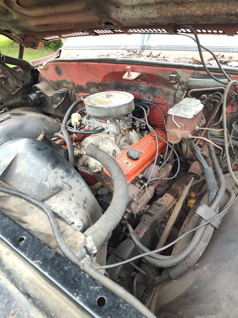

Hi my name is Justin I'm new to the forum thanks for having me here. Right now I am just looking for some advice I recently found a 1979 c30 dually manual trans with a dump bed Vortec block vortec heads carbureted intake HEI distributor with an Edelbrock and is solid and very clean by the way. The post that I found said that it had the top end redone but now has no power. So I drove over there with the car that he wants for the truck which is a 09 G6 I definitely want to trade cuz why not that's a great deal. The truck started great the carburetor and choke operated perfectly and idled fine a side of there's a bad misfire and smoke rolling into the cab that smelled like burnt oil. He told me that the guy he had working on it said that there was a cracked head so he went out and bought some vortec heads lifters push rods and roller rockers that the mechanic couldn't get them to fit right for whatever reason. so the guy bought another set of heads lifters pushrods and rockers which apparently worked but when he driving home couldn't get it over 50 and it didn't have enough power to make it over a overpass but didn't have that issue before hand and he doesn't know anything else about it besides it's leaking oil from the back of the intake where it should of been permatex. I didn't want to mess with anything trying to find out what's wrong at his house cuz I'm on a tether i was limited on my out time. So the advice I want to get is after checking the obvious plugs, wires, distributor timing what could be going wrong with it that would not make it okay to drive 30 mins home as I do not have a way to tow it. At that point I would be worried about mechanical I don't know what was touched or done correctly. I'm hoping it's something simple or even stupid like crossed spark wires. I want to get it back to go back through it for my peace of mind and to fix the problem but not at the risk of ruining it. Any advice would be great thank you.

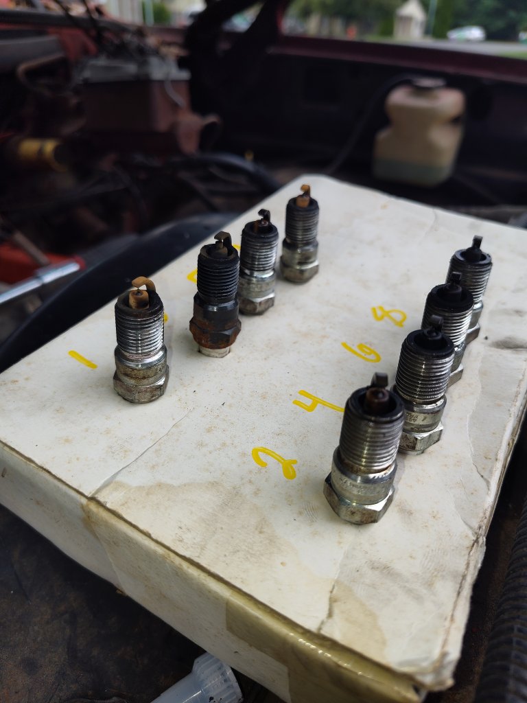

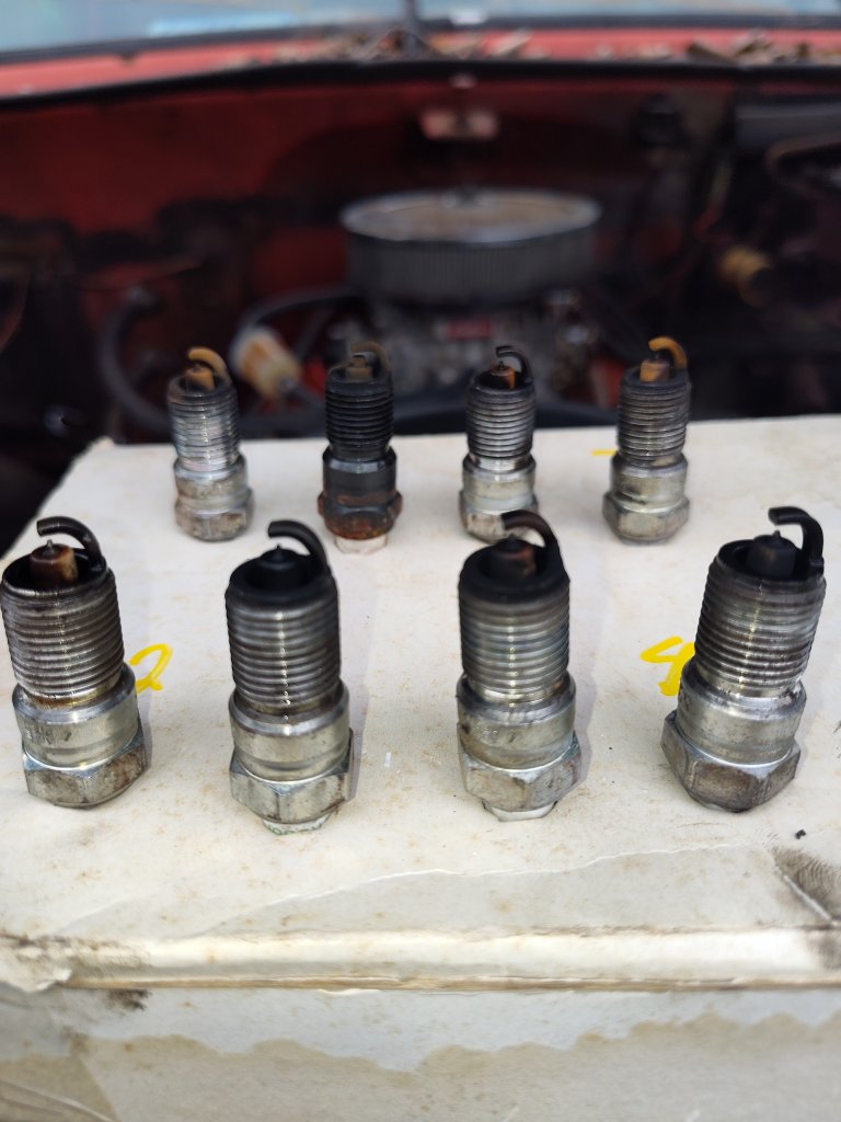

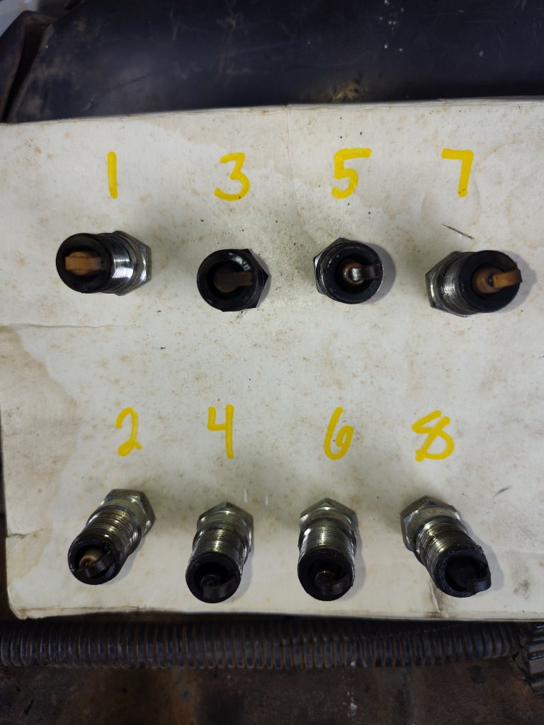

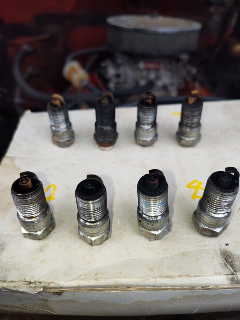

Alright....sorry it took me a couple of days to report I've been busy on it. Well I had to limp the truck home it took me like 2 hours and a gallon of oil. Before I left with it I checked under the valve covers and nothing was out of place and it did have self aligning rockers. It had a serious loss of power couldn't get it over 40 and hot boxed the hell out of it with burning oil coming from the intake leak. I stopped over and over to put more oil in it. I noticed the more I tried accelerating it would loose more momentum I let off a bit and it picked up slightly. One of the times I stopped I checked the wires. One and three were mixed up it helped a little but not much.
After getting it home first thing I checked was rocker movement they all were operating right when I rolled the motor so I tore everything down to re seal the intake and the guy that did it put those POS valley gaskets on it and the back was hanging out off the valley so new gaskets cleaned it up sealed it with a bead of rtv after inspecting the lifters and pushrods. The HEI distributor is brand new I bought two new fuel filters to put one before the pump and after the old was full of all sorts of **** so I opened the top of the carb and of course there was a bunch in there so I cleaned and blew out all the ports and put it on. Topped the oil off and started it. Started right up I moved the distributor from where I had marked it and gained more rpm so I still need to get it timed, I still hear a misfire. I gave it some gas and the engine started shaking pretty good which seems like a dead cylinder. I noticed the PVC valve keeps popping out and I have tapping coming from the passenger side and can really hear it with the PVC out. Touching the valve covers it feels the strongest over number four I pulled the plug and the gap seems to large and it's black its not a dry sooty look and it's not real wet and oily. So it's got me thinking it needs new plugs and a valve adjustment. I'm gonna pull the rest of the plugs and mark them to see what they collectively look like. Get new ones check the valves for lash over each cylinder while they are out. I can't find my damn gap tool I'm sure I will after buying another one. I'll put pictures up if the plugs. Just wanted some opinions.

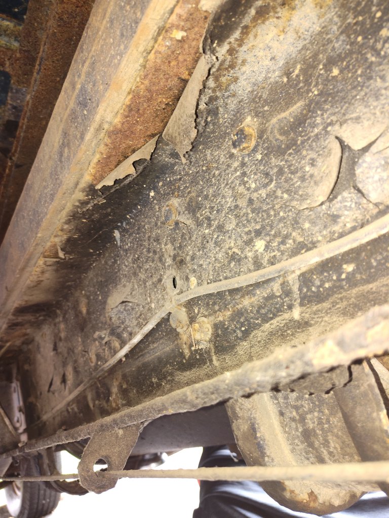

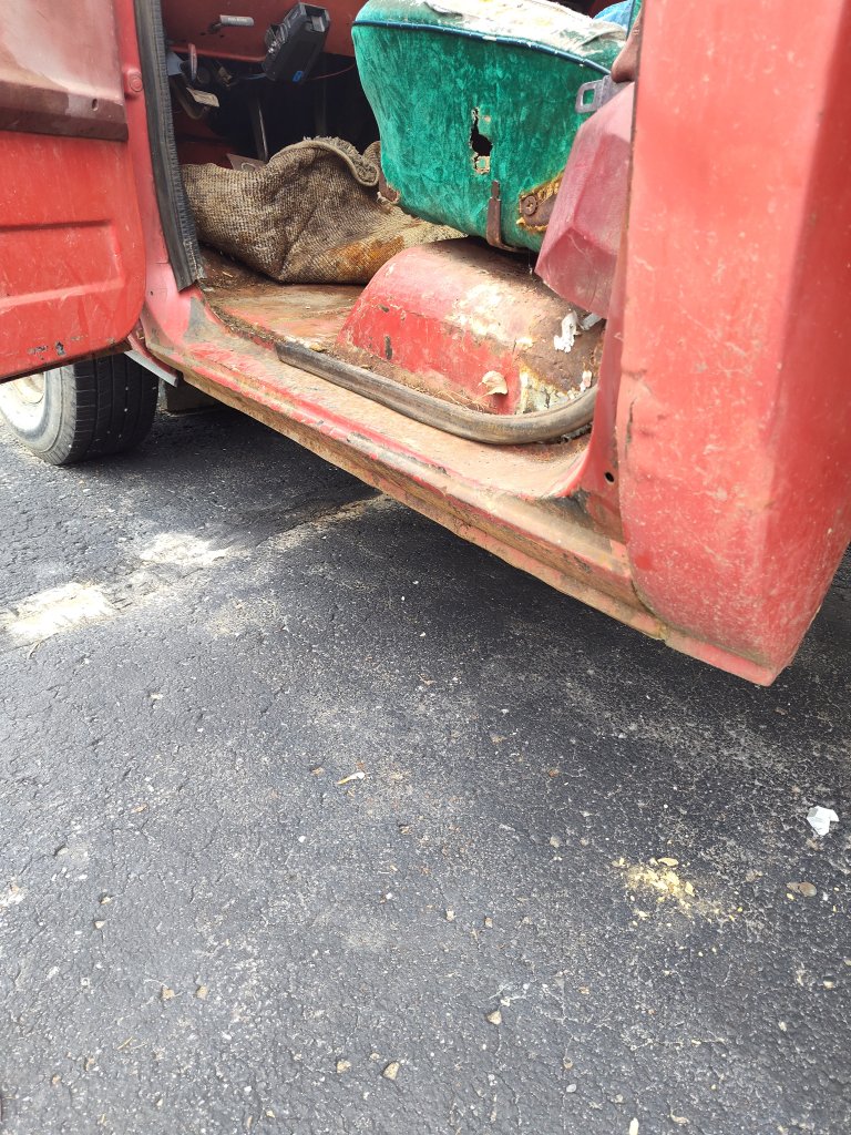

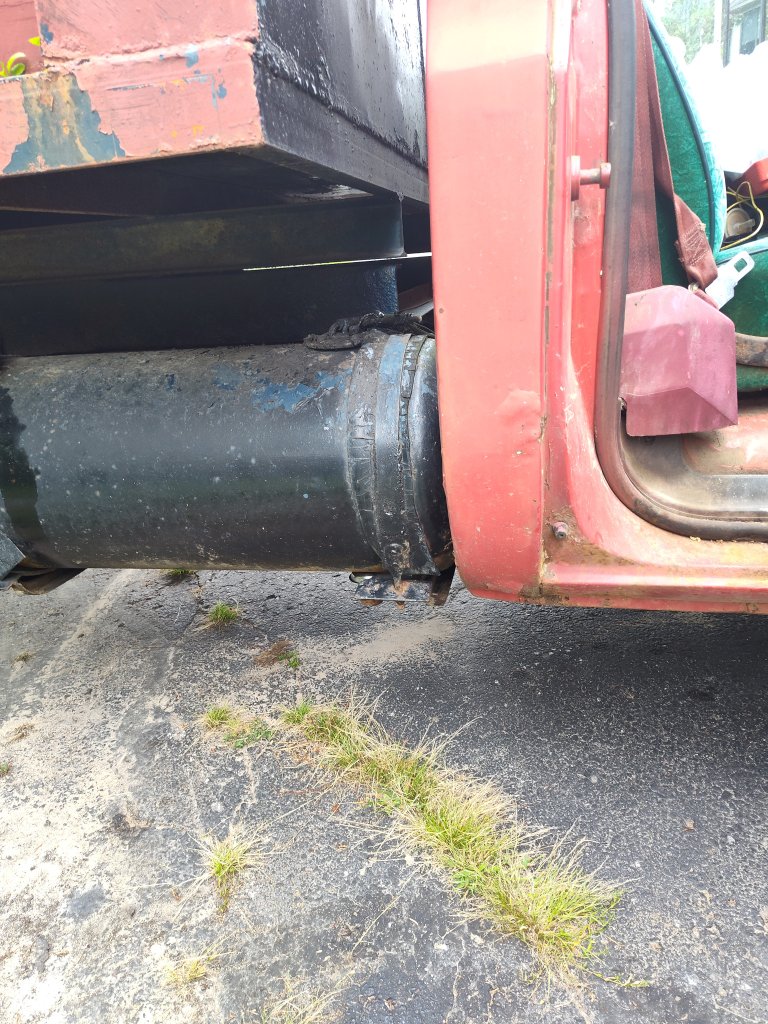

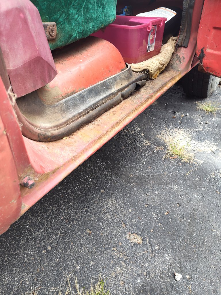

Right off rip I noticed a mismatch plug and bank two is running way rich. Probably need new wires as well a few of them are wet with gas. I also took the liberty of taking a few extra photos (for the critics) of the frame that still has black paint on it all the way back to the hitch and the solid floors rockers and cab corners. The hydro boost and brake system works flawlessly as well as the suspension and steering. Nothing needs to be done to this truck besides it's runnability issue which is completely well worth figuring out. If you disagree I respect your opinion but politely keep it to yourself.

Compression check, tune up, oil change, flush cooling system, change anything you can think of that isn't working properly and that hasn't already been changed. The pvc popping out sounds like blowby to me

Don't run iridium plugs. I made that mistake.
