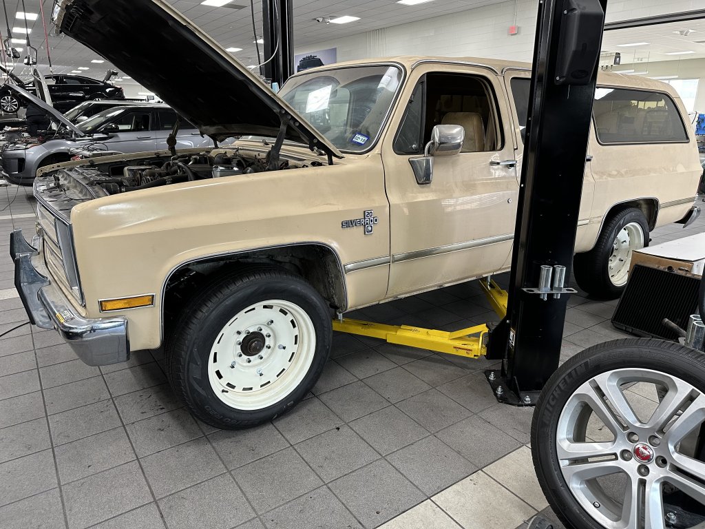

Howdy all!
I’m building an 85 suburban and it has a 454 with about 90k miles. We are pulling the engine tomorrow and are going to do a complete reseal. I would like to add a cam to give it more power but am not sure what to go with. It will be a daily driver, th400 trans, b&m torque converter 1800-2200 stall, Edelbrock Rpm gap intake, Holley sniper, Long tube headers, x pipe 2.5” exhaust.
Any recommendations?

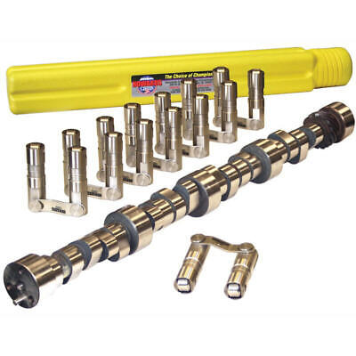

Let me know what your thoughts are on the lunati kit below:
30,298
27,900
What about this kit?
There's way more to it than just the cam. You are going to be limited in valve lift before the retainer contacts the seal, so you will have to measure for that. The recommended springs for any given cam may not clear your valve guides/seals or fit your retainers, so there is also that you need to figure out. You will also need to upgrade your pushrods to 3/8" which also means replacing the pushrodguide plates.
The 80's and 90's big blocks were designed with a valvetrain that is only adequate for the stock cam, with efficiency in mind.

The big thing about retro rollers,is they weigh more than stock lifters so you have to upgrade everything.

Thanks. I’m not worried about new push rods, I’m just curious if this is pushing the limits of causing valve damage. Lunati edelbrock told me it would work… ‍♂️

I wonder if this setup would be better than the lunati?
