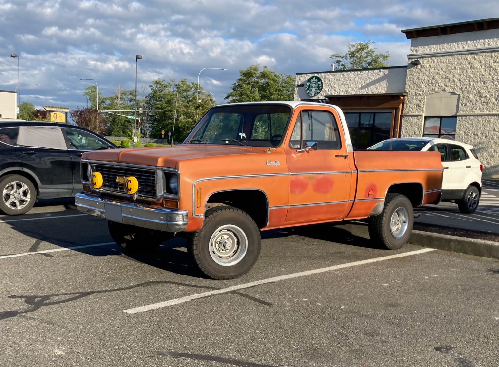

Here's a picture of the truck on a recent grocery run. Needs some paint, but it's pretty solid.

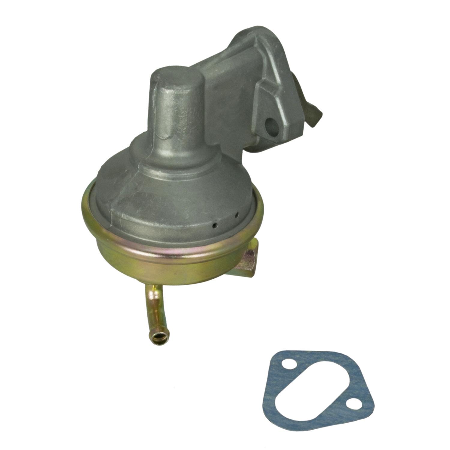

The 454 I have was actually swapped into another K10 before, but it was missing a fan shroud, had destroyed motor mounts and had some other issues, I'm just trying to make sure I do this swap the right way. It came with the low profile fuel pump and all the accessory brackets.
