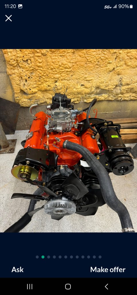

Howdy to all Squarebody owners just wanted to share my opinion in regards to the 350 sbc or Ls?
Well for starters let's just say I'm not a fan of Code readers or having to hook up a laptop to tune in vehicles I have owned a few vehicles and most of them had 350's in them also had a few with 454's as well I myself would go with a 350 small block I have 2 C20's both with 350s like that everything is affordable & lots parts availability Etc. But if you want a monster for towing or moving big items put in a 454 big block just my 2 cents
