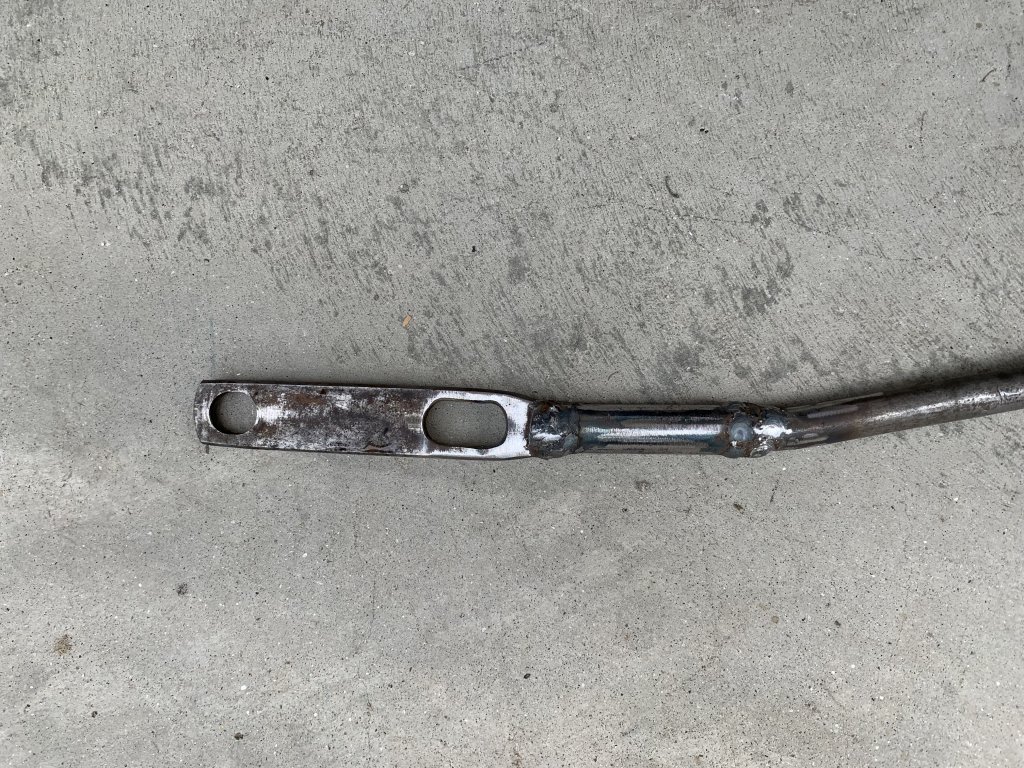

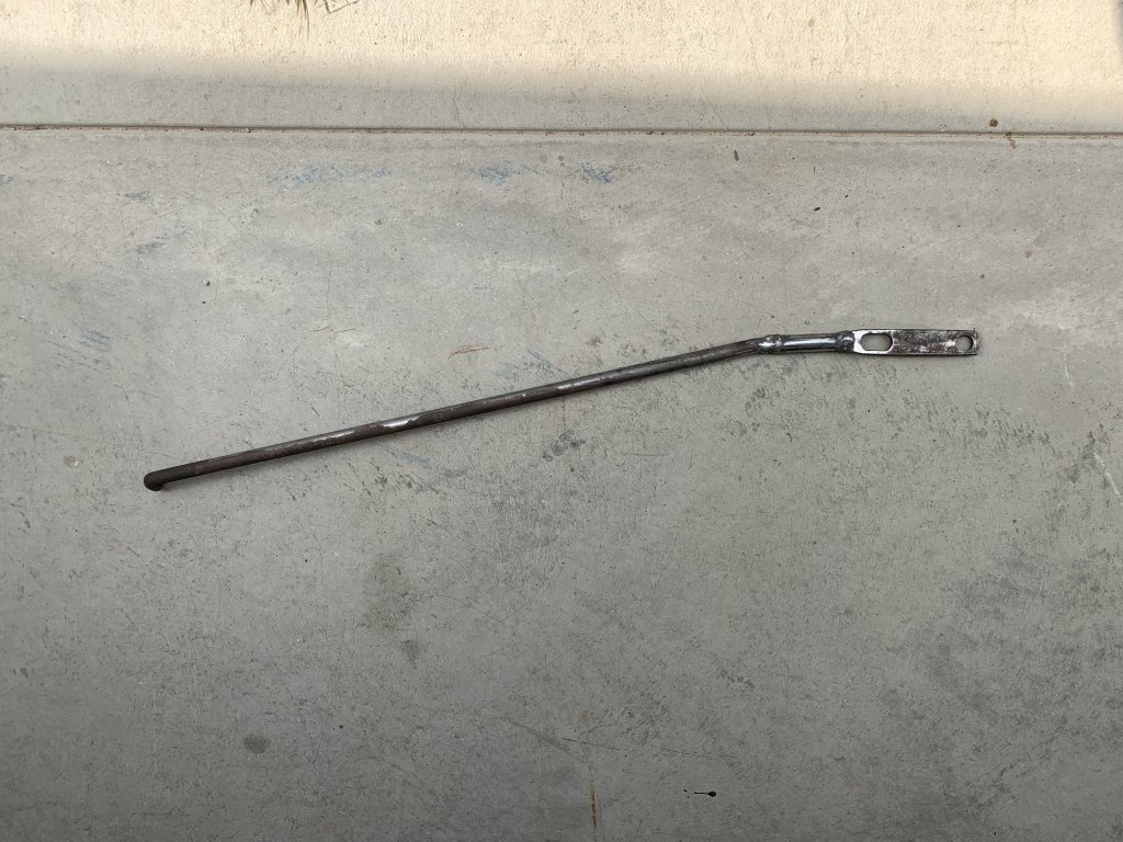

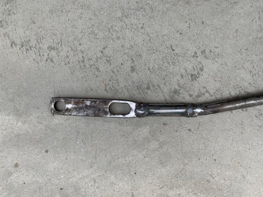

LS bellhousing stiffener rods

What everyone is missing here is that all the later model drivetrain pieces that did not have side braces came in IFS trucks that don't have plunging driveshafts. The strut rod is there to keep driveshaft plunge forces from working on the adapter and the back of the transmission. It's not a bellhousing brace. It is nice that the later trans housings and adapters are generally beefier than earlier stuff but if you end up with a sticky front driveshaft on a leaf spring suspension, something is going to move and with a side brace, at least the trans tail will live for a little while. That side brace is a good idea.
Don't confuse this will the side brace going to the frame rail. It served that same purpose but also was a problem with frame flex and motor mount wear. Those side braces are a bad idea.

So side brace #1, or strut rod as you called it, is the long one from bell housing to the tcase (good idea)
And side brace #2, going to frame rail, would be the two rods going from bell housing to motor mount plate (bad idea)
Am I reading you correctly?
That is correct, sort of. You put 2 separate things in #2. The side brace to the frame rail is essentially an angle iron with a couple of bushings that bolts to the side of the T-case and the bushings attach it to the frame rail. These were in the earlier 70s trucks and were a bad idea.
The rods from the motor mounts to the torque convertor cover don't hurt anything but real world use indicates that the bellhousings don't break often at all and those rods are generally lost or don't fit with changes. If you have them, it doesn't hurt to keep them. If you don't have them, I wouldn't (and don't) spend any time putting them on.
