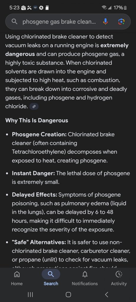

Don't use brake clean confirming vacuum leaks. Burnt brake clean is phosgene gas. Not all brake cleaners,but some so just get in the habit of not doing it for safety sake. Use carb cleaner,intake cleaner,oil,or propane.
