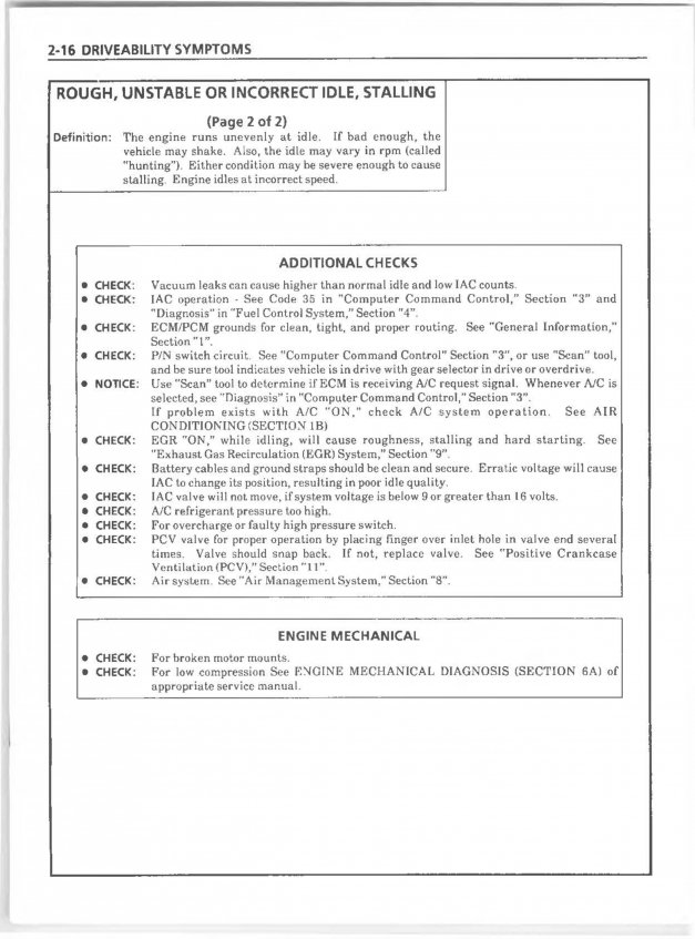

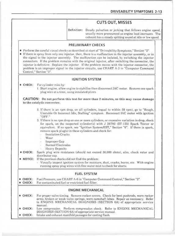

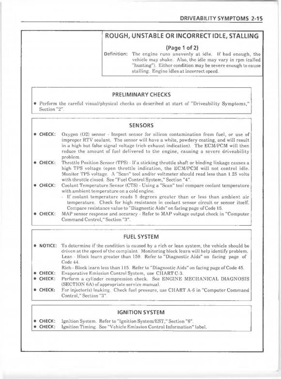

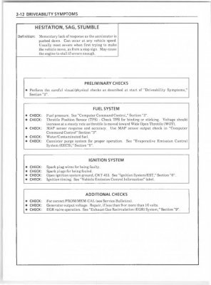

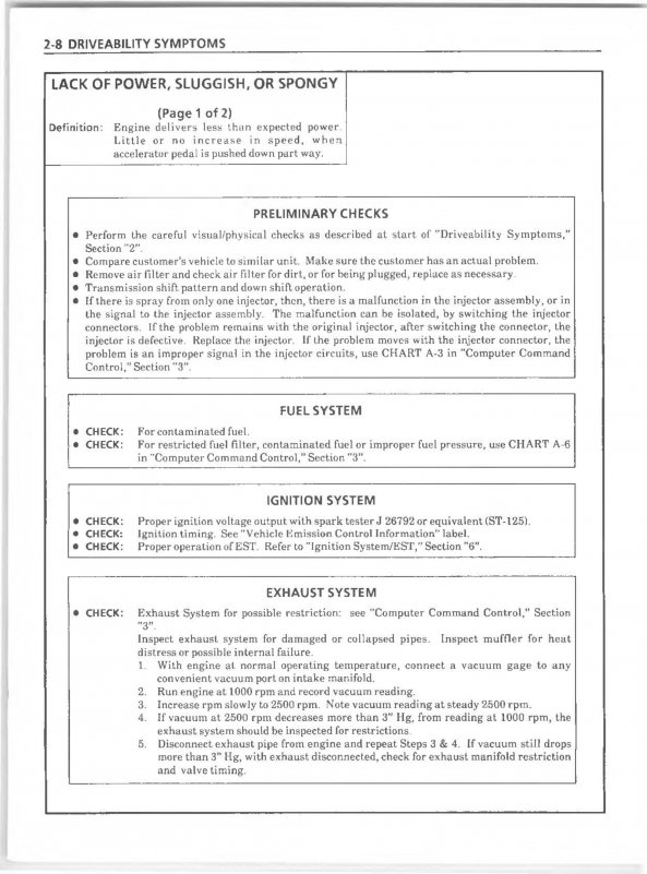

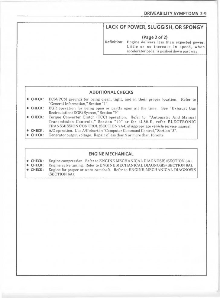

You might want to read through these (from the "1991 GMC Light Duty Truck Fuel and Emissions Including Driveability Manual") - at least as a check list:

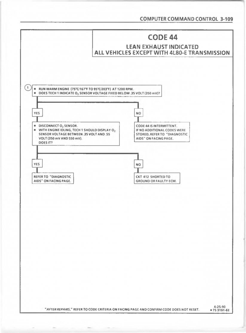

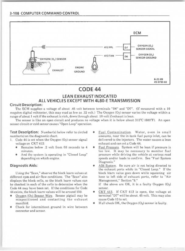

Poor idle and code 44:
