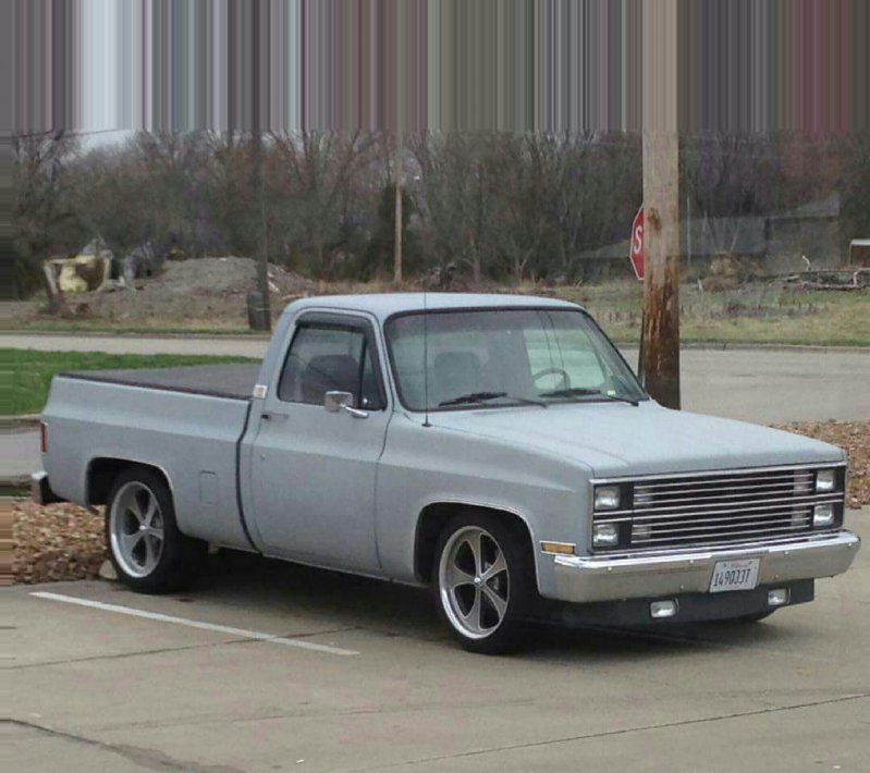

I'm running 245 45 20 on front and 275 45 20 rear
