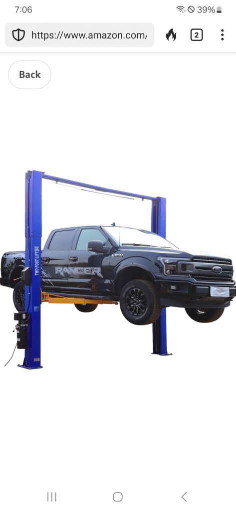

One of the 2 posts I was looking at.
Fode ranger picture doesn't instill confidence lol

2 post with crew cab will work. Hoist needs to be high quality. We raise them all day on a Bend Pak. For added stability quite often we add a stand to the rear. Just be sure to remove it before lowering the truck. Have seen that done, it usually isn't pretty.
A 4 post will also work but to remove the tires a cross jack is needed. Price those out, decent ones are expensive. Hoist also takes more room if that is a concern.
A friend bought a 2 post 15k Mohawk on the government auction site for about 1/2 price. Will raises his crew cab diesel without any problem, hoist is expensive new.
Another consideration is floor thickness.

Two post is plenty, as noted, if you have the floor for it. Here's my old 3+3 camper special dually without the outer tires on it.
4,660
15,396
Personally, if cost were no object, I'd go 4 post with 2 slider tray jacks to have the ability to do it all. But that is like 1/3 more, my buddy just priced all that out. I've never worked on one but I've done alot of work on a 2-post and it can get sketchy. Our '07 Duramax fell off our 2-post at work when one of the arms slipped off the frame, thankfully the running board caught it.
If you go 2-post, I'd highly recommend those U-channel feet/adaptors. That's the only way I'll use our 2-post now since that gives you a second layer of security from the arms swinging. Also, get 2 stands so you can have one front and rear for super long trucks/heavy work. I always put one front and rear when I'm doing more than changing oil, just in case.
