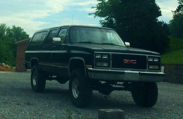

heres a photo...
Heres a pic of the Suburban...

That's looks really good to me. Looks a little low in the rear though. If you measure the height from the front axle to the bottom of the orig bumpstop bracket on the bottom of the frame that will usually give you an idea of the lift, I was told stock is like 8-9 inches, mine measures 15 inch which is 6 inch lift. If the bushings look mis aligned or out of shape,,,bolt not in center of spring eye, they could be bad, might be poly too, if they squeak or theyre a color other than black there poly, poly could be black too,,,
