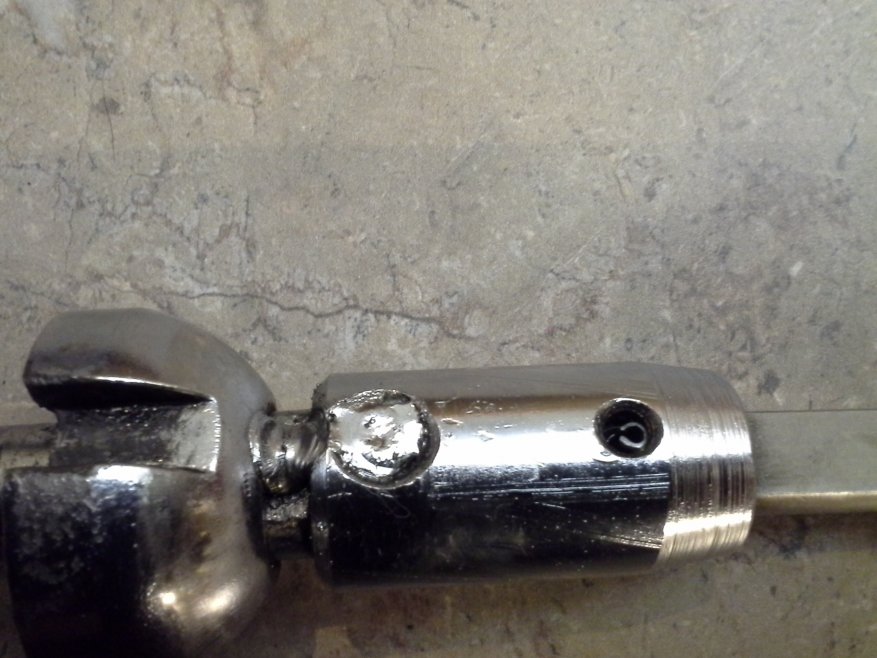

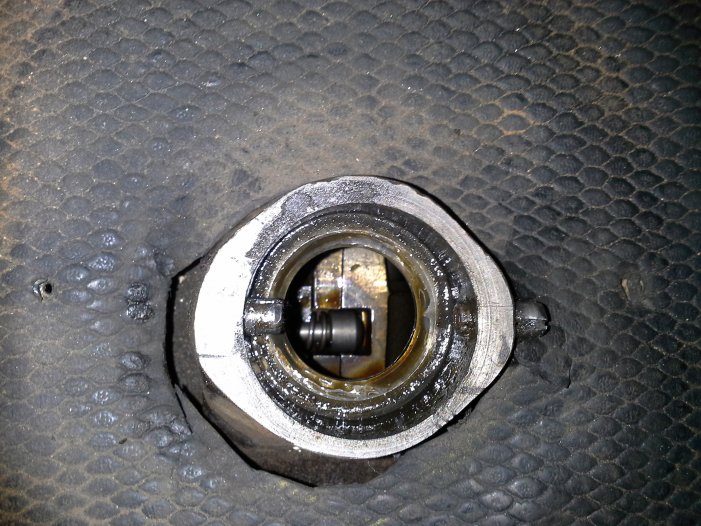

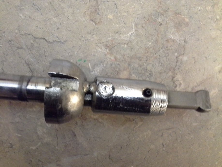

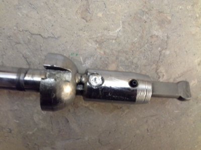

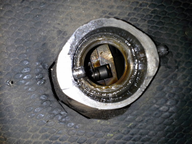

Pics..
See the pics. There are cracks in the tack welds. A lot of play in the shift pin on the shifter, too.
Thanks

Georgeb
Apr 30, 2015
3,259
214
Wisconsin
George
2003
K10 Burb Z71
Looks like the retainer clip on the reverse detent let go allowing it to push too far out. It wont go back because the reverse gate is not all the way back in position. Idon't think you can fix it without pulling the cover off the tranny to get at the plunger and replace the clip. If you do need to pull the cover you will at least need to move the reverse gate and put the shifter gack in so you can place it half way into reverse so the reverse shift fork has clearance for removal. I don't know if you can move the gate half way without the shifter. @GEB has more experience with this than I do. I have no fear of pulling one apart but would have trouble describing it.

If I put the shifter back in, I can get it to go into reverse or 2nd or 3rd if I mess with it for 5-10 minutes. Then as soon as take it out of that gear, I start the process over of not being able to get it over to 2nd, 3rd, or reverse unless I fiddle with it.
Georgeb
Apr 30, 2015
3,259
214
Wisconsin
George
2003
K10 Burb Z71
That is because of that plunger with the spring on it. It is hitting the reverse gate all the way to the left side in your pic.
