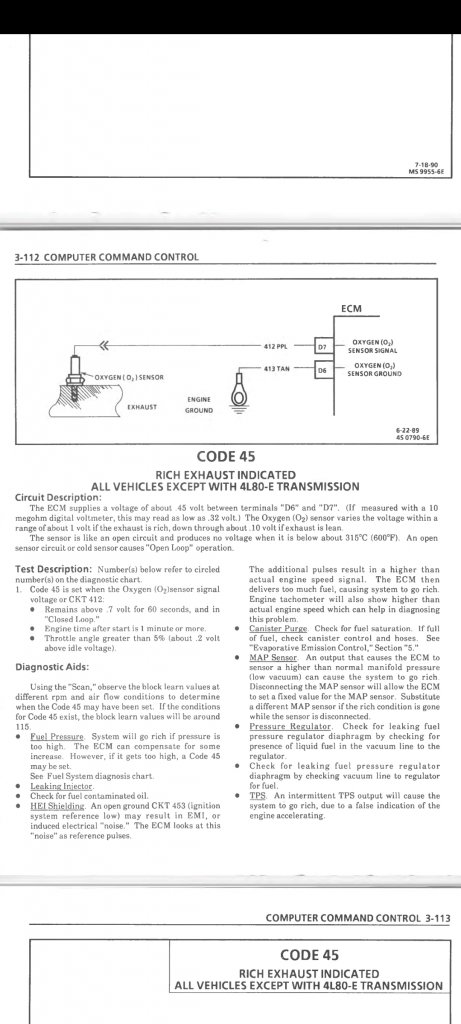

Lines match the picture, I know it’s running rich in general.
check your injectors with key on but no crank. make sure no fuel is dripping in or leaking under that condition. then check injectors with it running to look for a nice cone of spray.

check these things if you think it is rich.
does the idle stumble cold or warmed up or both?
Both, but only on restarts. Starts up fine cold. Even if all I do is run the truck for less then a minute. Sometimes reving it a little helps
