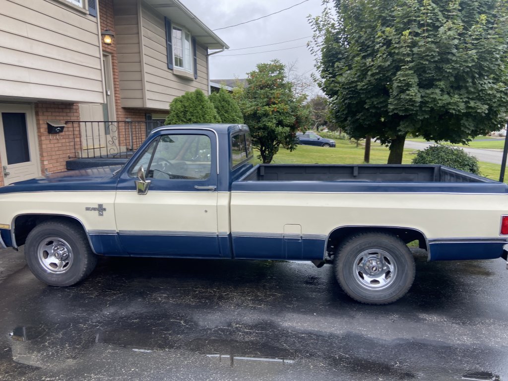

Well, I did the vac advance to full vacuum test and brought it back down to 12° initial, tinkered with the idle mixture screws a little to make her clean up a bit also did an oil change. Was quite a bit low. Didn’t realize how much she burned during this process. and wouldn’t ya know the next morning, and the morning after, and this morning, I was able to hop in er and go. Like a BEAUT! Not sure if maybe something was blocking the vac advance… Or the holley just wanted a better mix… Or the oil being low made her grumpy…. But she’s happy far as I can tell. So I spent my Saturday off whining up the wheels, gave her some wax, and she’s shining bright now! I think it’s taken care of for now. Still not sure exactly what did it, but… it did. Lol! Thank for all the help!! (It just rained when I took this pic just now so some of the cleaner I used is coming out from behind the chrome.)
