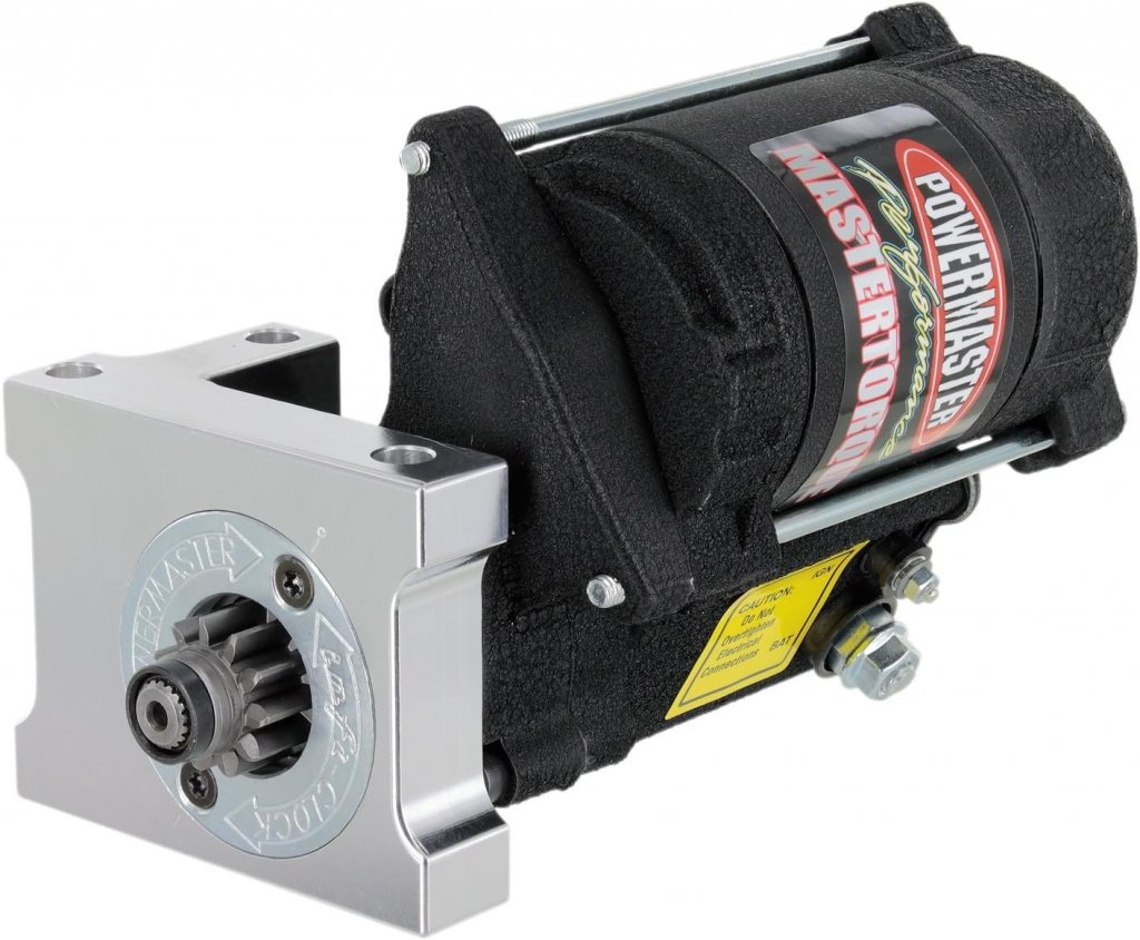

"Heat soak." Universal GM starter problem in the summertime down South. Since we're among friends, I will admit to having urinated on stuck starters in a pinch to free them up. (Civilized people also use water.) It works, but gets tedious. And it's not really a fix.
The best solution I ever found was a Mean Green starter, which is a type of hi-torque mini. They're rated to turn over rail dragsters, so a small block is no challenge at all. These days I think they cost about $400 (ouch!) but it'll fix the problem for good.

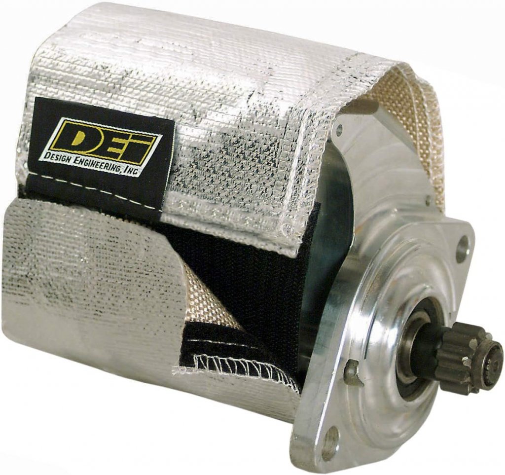

The '73 3500 did this to me multiple times until I installed heat shields on both the solenoid and starter.

I installed a starter on my 454 (early 70s LS5) with a Delco Delphi one for a 99 Suburban from Oreilly. Also used the slightly shorter mounting bolts. Starter P/N R613326B. Dorman P/N for bolts was 678-107. Everything bolted right up and works beautifully. Starter is a small permanent magnet gear reduction unit. I also wrapped it in an insulating blanket although that was probably overkill. It’s worked flawlessly thru the summer heat.
