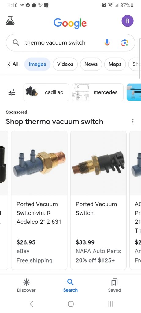

You know I was making some assumptions at first that I shouldn't have. Do you have any thermo vacuum switches on this engine. 1 should have manifold vacuum to the efe(exhaust flap) if it is connected to manifold but not the vacuum servo you will have a vacuum leak until the vacuum switch closes. Another possibility if the hoses are m8srouted the egr could be getting vacuum during warmup

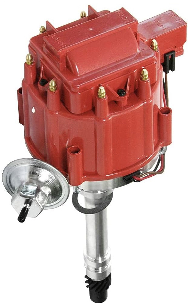

I’m still at work so I can’t check the actual model but it looks like this one and the rotor on the inside is a red brick of plastic. Not the kind with the two metal “crab claw” centrifugal weights.

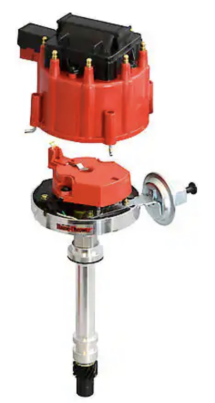

This type of rotor

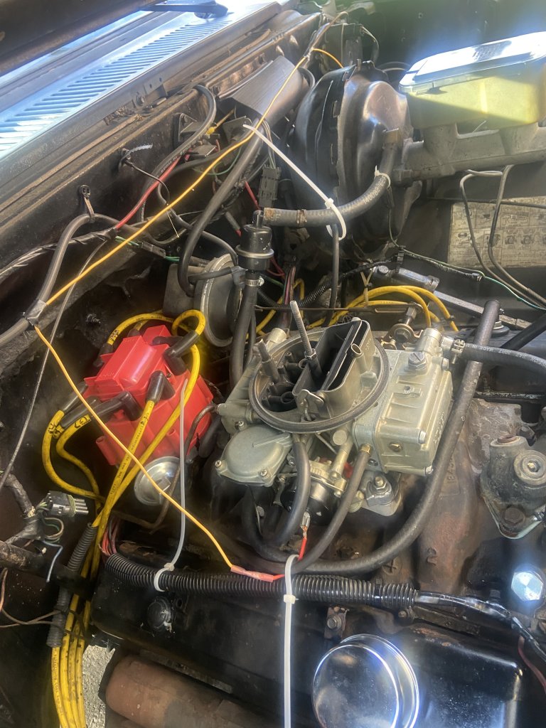

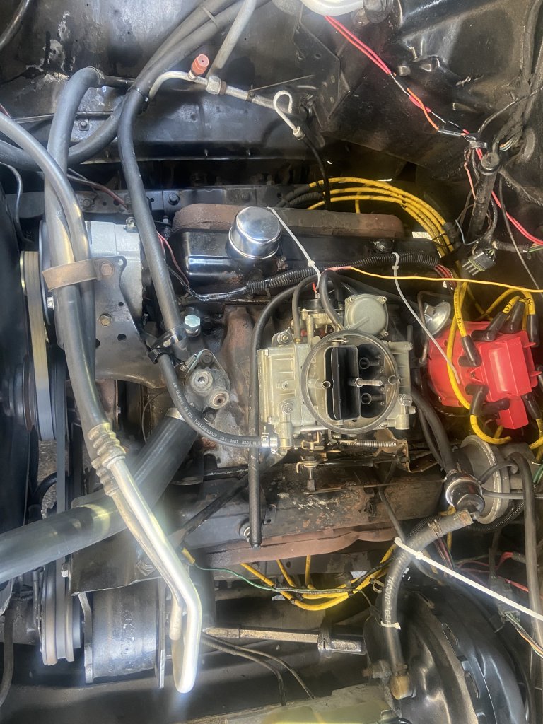

About to try the vacuum advance to full manifold.
Davidj
Sep 19, 2023
43
33
greensburg
Silverado/c10
350cfm

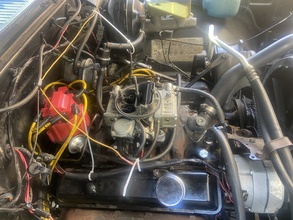

Yes, vacuum advance to full manifold increases idle significantly. I’d say probably 200 rpm increase. Here’s a better pic of the full deal.
