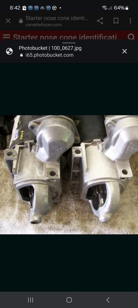

Not saying this is your problem,but it was a problem for me once,it was a real head scratcher. Look at these 2 nose cones one has a recessed area right around the bolt holes,one doesn't. I had a block that was thin enough at one edge,you'd put a starter on it would work fine short term,then walk off the edge of the block drop that recess over the corner then, I'd break another nose cone.Went through a dozen starter boxes until I found one without the recesses,problem solved. It's worth looking at.
