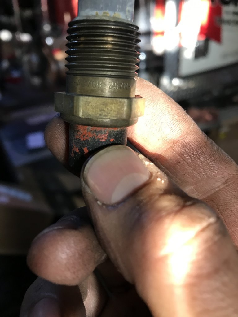

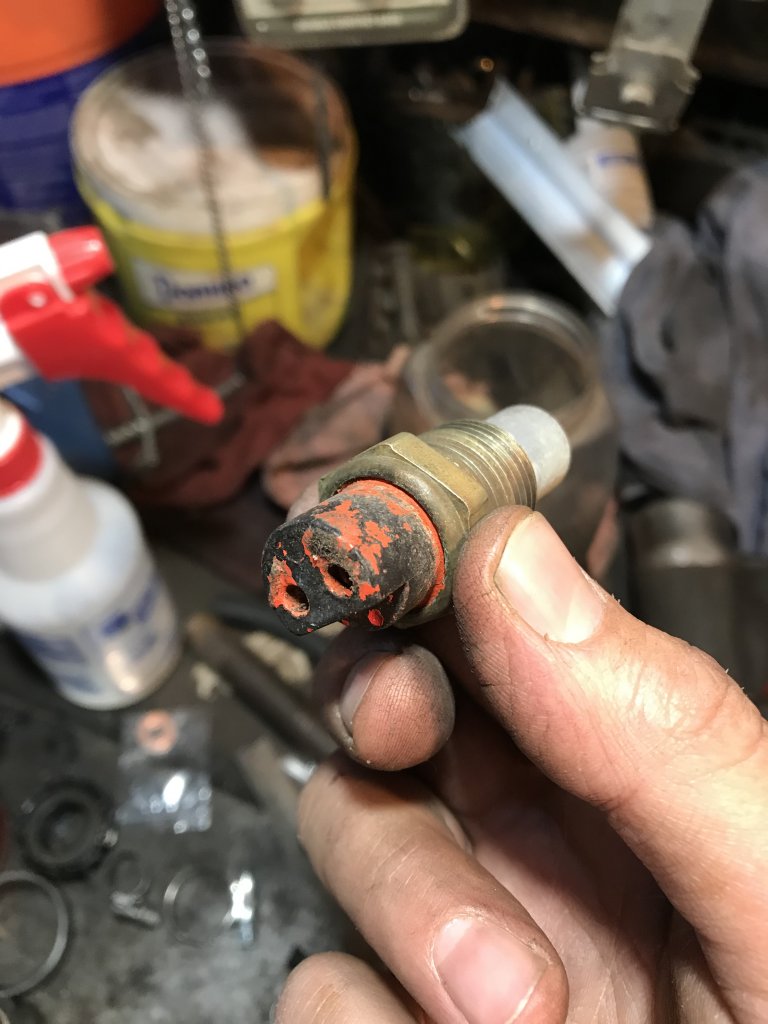

Hey guys. I need a known correct number for the temperature sensor for my 76 gmc. It’s for the gauge. I looked it up on maps, bought it and installed it only to find out it pegs the gauge to hot when it’s cold. Unplug the sensor and gauge returns back to to wherever the gauge wants to. I know my cluster is good and gauge is good. Napa is notorious for being wrong especially with the temp sensors and all the different resistances throughout the years of these trucks.
I have the sending unit that came out of it buts like nothing I’ve seen before and don’t think it’s correct.
I should add that there is only the single wire coming from the cab for the gauge. That’s all good and I know works because again, if I ground it or just hook it up to the sensor it pegs the gauge. I did NOT test resistance of sender because the engine was hot and I was in the middle of tuning the carb. I’ll check if the sensor is dead shorted and then I’ll know if it’s just a bad sensor.

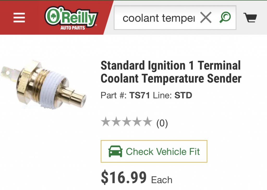

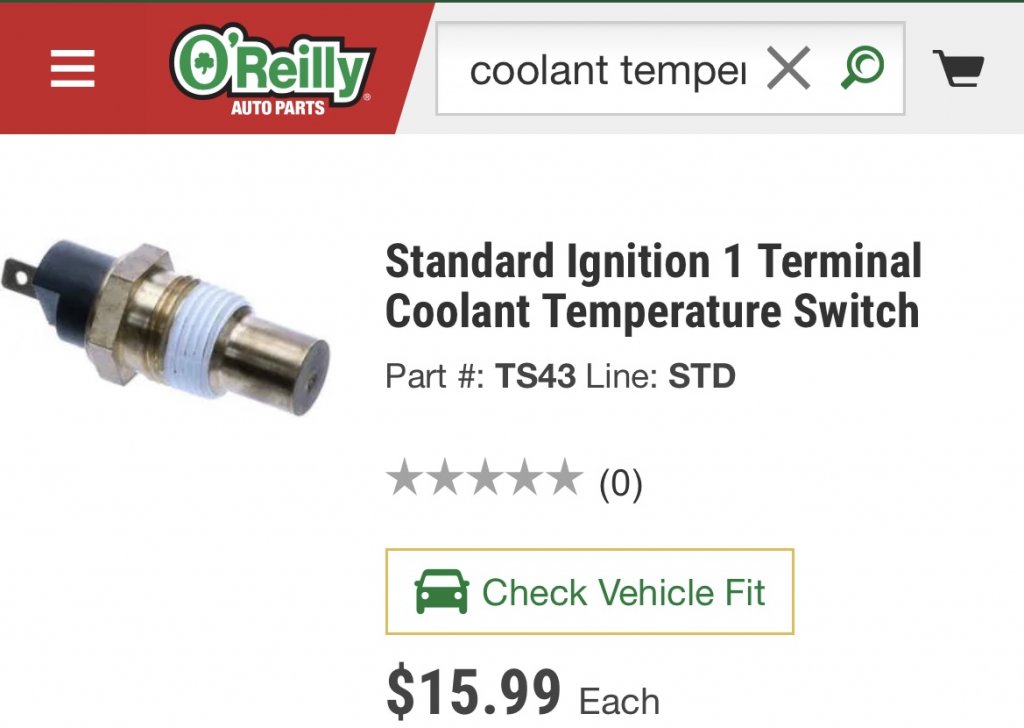

Are you sure it’s the sender for a truck with gauges and not the switch for trucks without gauges (idiot lights)?
The SENDER is for a gauge, the SWITCH is for an idiot light.
Very similar and easily confused (I’ve made that mistake before).

The part number I got was listed for a gauge. Totally understand how it can be confused. Not saying that the part isn’t listed incorrectly. I’ll ohm it out tomorrow to see if it’s a dead short or not.
But, if I were to put a switch in there instead of the sending unit, it wouldn’t peg the gauge when cold or even operating temperature. It would only let the gauge if it overheads, closes the contact to ground then the gauge would peg. I still think it’s a wrong resistance sensor but have nothing known good to compare it with. All of my other squares are from the 80’s and I know they’ve changed by then

Since you mentioned that you’ve received incorrect parts from Napa in the past it’s just the easiest thing to check. On my 1980 K25 454 I use that sender I posted, part number TS71 and it works fine for me. I don’t have much experience trouble shooting temp senders. I read another post on here that @Bextreme04 replied to and he seems to have some expertise with it. Maybe he can help you figure it out better than I can.
