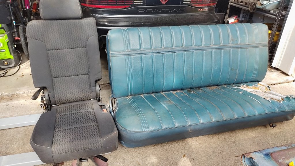

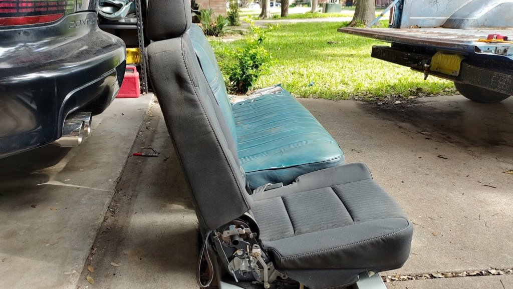

here is the the 40 split side of the seat next to the old bench
from that the new bench can recline quite a bit, but thats as far forward it can go without folding down

Thanks, that helps quite a bit. I'm confident in my ability to make a custom frame but I'm subscribed to see how you get it done.

heck yeah, hopefully I can get you part or hopefully all the way there
it is funny though to see the difference in design of these seats
the new seats are super beefy and use giant bearing surfaces on the screws
the old seats are pretty thin gauge brackets and 6 smallish (5/16?) screws

New seats are designed to restrain the passenger in an accident, the middle seat has a shoulder belt attached to it and the other two seats have the short end attached to the seat frame. In old trucks all of the belts bypass the seat and attach to the body and the belt bears the burden of restraining the passenger.
