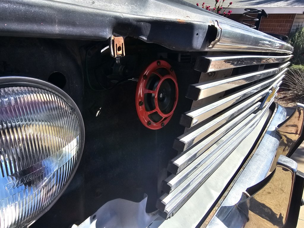

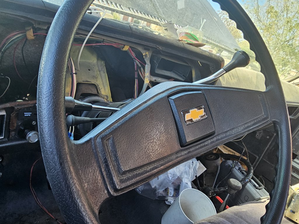

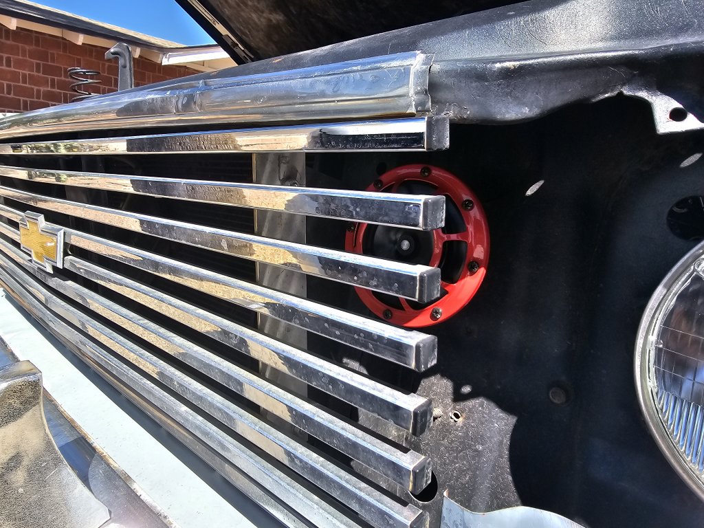

I got the shift linkage put back together this morning, as well as the steering wheel with horn contact parts and installed two new Hella horns

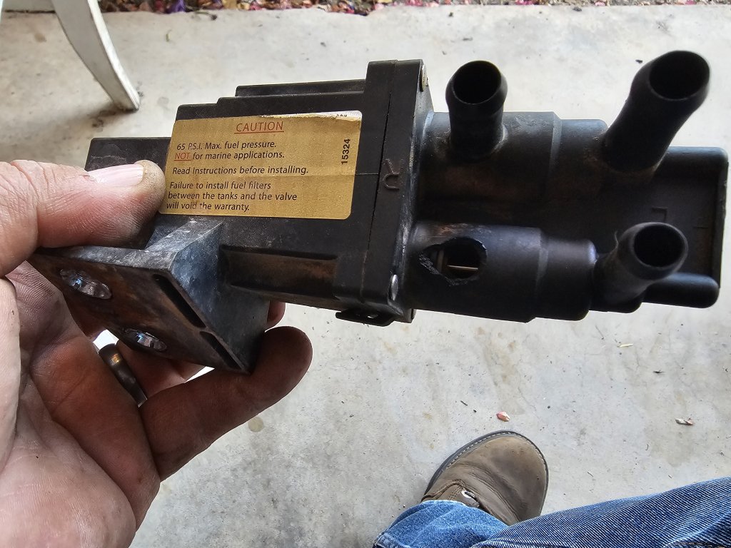

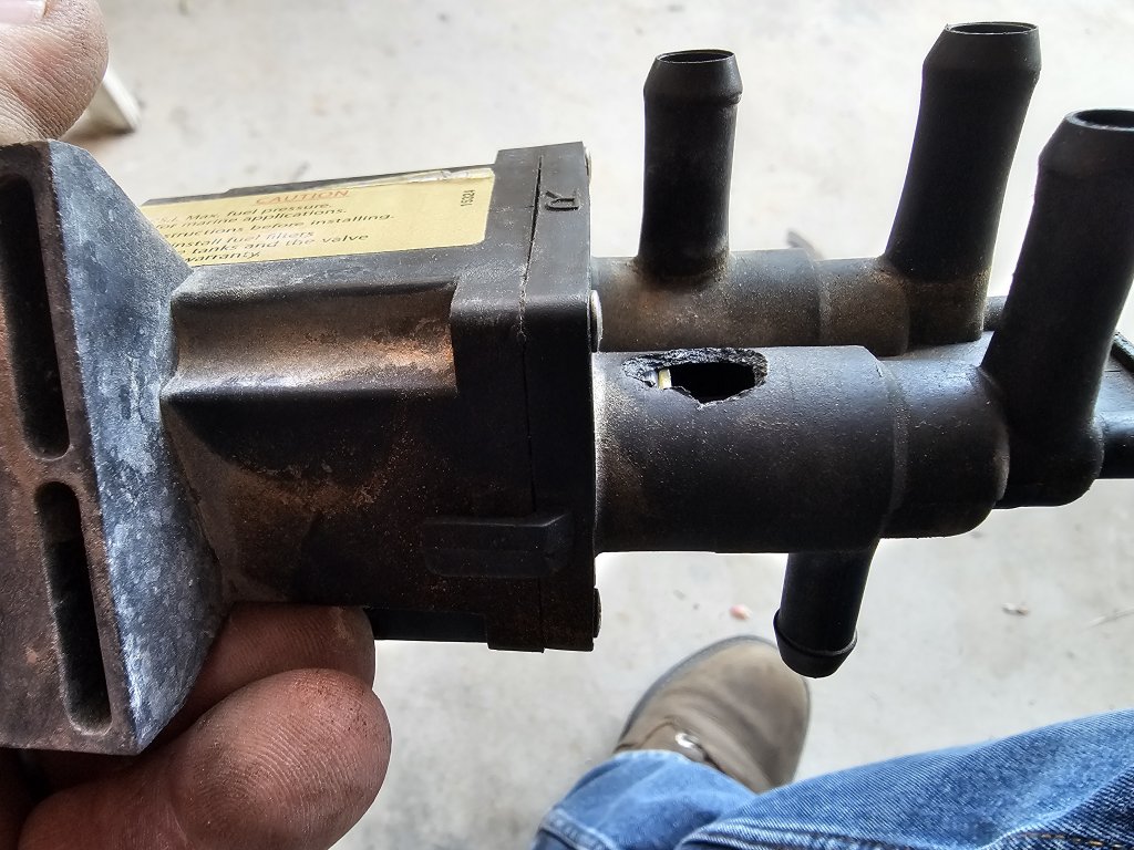

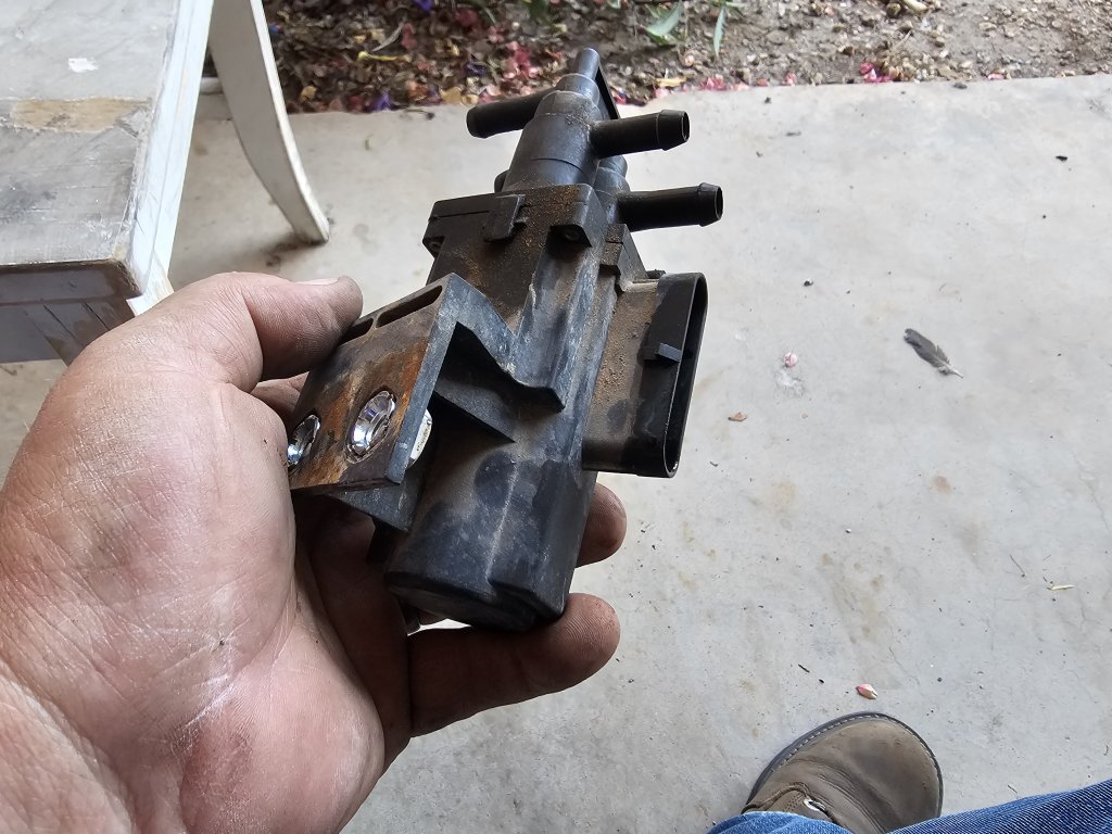

Few updates. I had to replace my six port fuel selector valve in an attempt to troubleshoot why my unselected tank starts spewing gas, but replacing the valve resulted in same problem. I wasn't planning on replacing it, but I broke off one of the ports trying to remove a fuel line. Nice $100 mistake there.

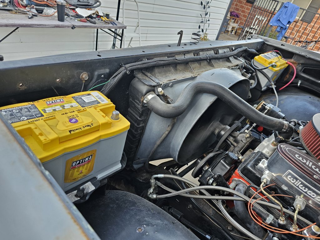

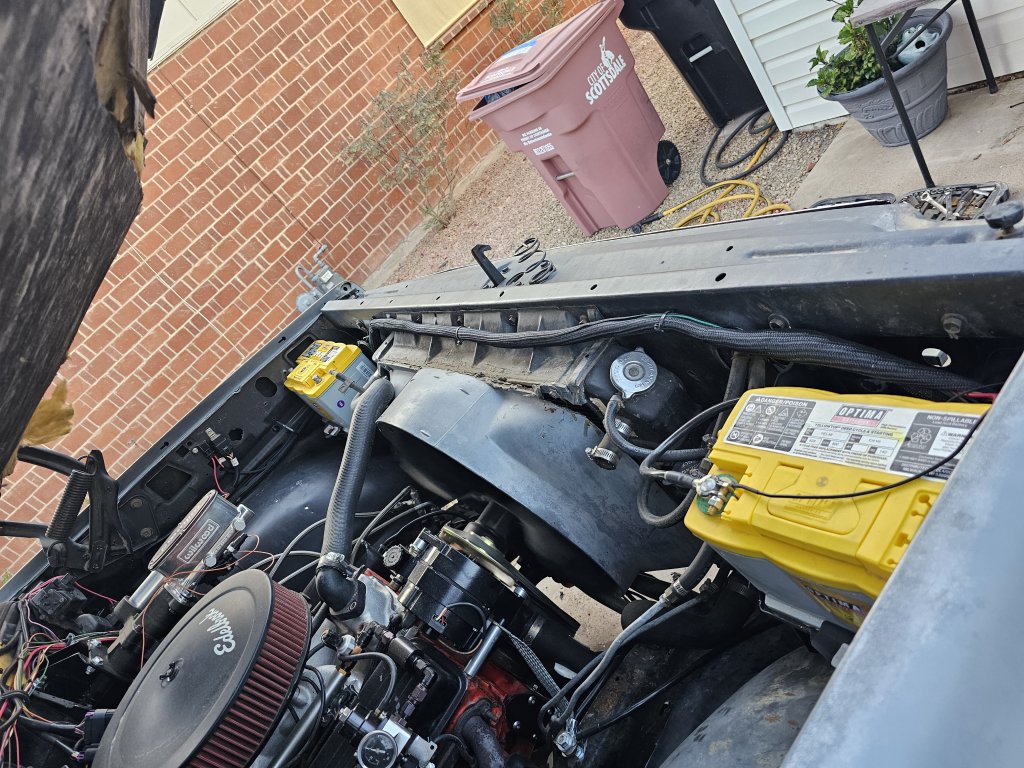

I did get my second battery set in place but still need to pick up a battery isolator and wire it all in
