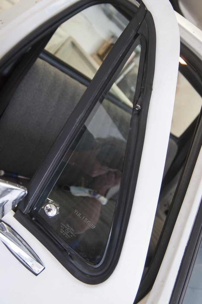

One of the largest hurdles in my resto of my 84 C-10 would be.............vent windows!!
New replacements are few and far between, especially the driver's side.
Those that ARE available will require a second mortgage on my house.
Used ones equally scarce.
The reconditioning program is very pricey,too..
Eliminating them with a single side glass is a viable option, but expensive and experiencing scraper shortages........
What are the tricks to restoring the originals???
What to do, what to do???
7,717
13,732
Auburn, Washington
Do a little reading on here. There are several threads including recent ones.
I just re-furbished mine. Not difficult from a technical standpoint. Just time consuming and tedious. That’s why the new/rebuilt ones aren’t cheap.
$40 for new seals.
$20-30/ea if you need to replace the locks, but there may be rebuild parts available for those for less $.
There are a bunch of videos of the process as well.
Tricks?
After doing mine, I split the frames into 2 pieces for painting. Later figured out that was not necessary in my case. However it did help me get the new seals in a bit easier. But required reattaching the 2 pieces. I used small machine screws and nuts with loc tite in lieu of smash rivets. Worked well (as long as it holds up which I’m fairly confident of).
I also removed the pivot bracket from the front frame. Also not necessary in most cases I believe. I didn’t get smash rivets for this either. I pop riveted them back on. Had trouble finding the right size rivets.
Install and removal?
Watch your paint. If it’s nice, tape around the areas likely to get scratched.
When re-installing it appears the rubber lip gets tucked “in” to the door window frame. Although some installs don’t do that. And it looks correct either way imo, I couldn’t get the windows fully back into place with the rubber “out” , not “in.”

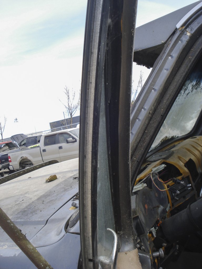

after trying jobber seal of all kind (one piece or tow pieces) that still leaking air on highway... i réuse an old pair of a OEM 91 Crew cab found at junk u pull for cheap that now seal tigh! ;)

in is 2 pieces..out is one piece rubber ;)
