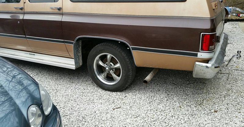

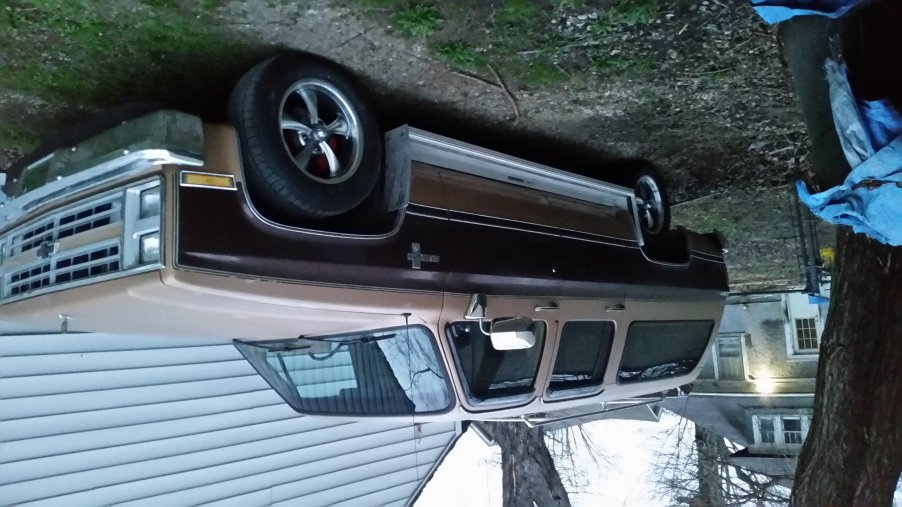

New Shoes
31,892
32,685
Boy, them tires really stick to the road, lol. Are the running boards coming off next?

It's easier to change tires if the truck's upside down.
I'd love to ditch the running boards but it's a family hauler and mama likes 'em.
31,892
32,685
The boards looked good with the old wheels and tires, but they seem a bit out of place with the new ones, IMHO. But maybe it's just because I've never seen that combo yet.
