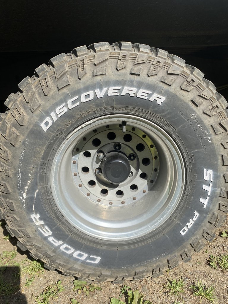

Hi all, hoping to get some input on a weird situation that happened this week. Husband was driving our truck home on Thursday and the wheel almost fell off after he crossed some rail tracks (set into ground, just a small bump). He got out and picked up the lug nuts and thankfully made it home. There was just 1 nut holding the tire on and the 2nd bolt had broken off inside the wheel. Needless to say the wheel is messed up. The bolt dug into the aluminum wheel and the rest of the lug nuts won’t tighten down properly. Additionally 2 other tires had loose nuts as well after inspecting them.
We got an alignment at the end of March at Les Schwab after getting some front end work done, the manager said they did not have to touch our tires to do it. However I’m having a hard time understanding how 3 tires could have loose nuts all of a sudden. Is there anything that could cause this? Our buddy did the front end work and we can’t really imagine him not tightening things down. After we got the truck back it felt good driving it over to get aligned, after the alignment it felt like the steering was a lot looser / worse.
For context the truck is my husbands daily driver, about 8-12 miles a day for work. We did haul a small load of fence posts and some concrete in the bed over the weekend but that couldn’t of been more than 400 lbs for a 1/2 ton truck…
Now that the wheel is messed up we will have to haul it somewhere to get it fixed. Photo is from when we got it home, you can see the final lug plus the one that broke off inside.
Hoping to get some feedback or any ideas of what could’ve caused this. Thanks all, I appreciate any help!

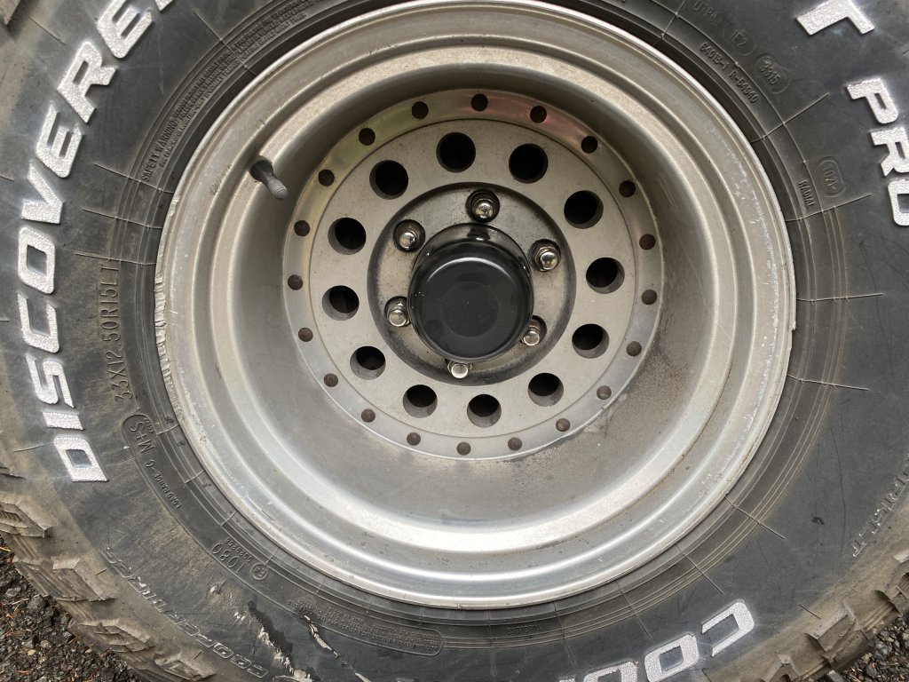

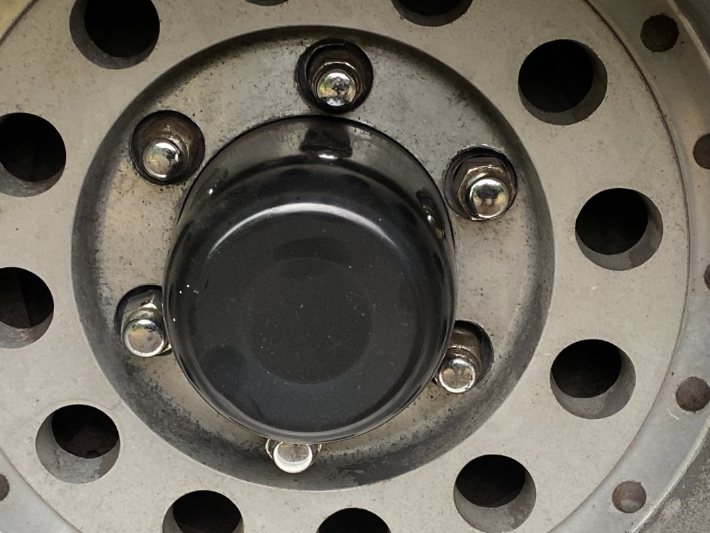

Thanks so much everyone for your information! This forum is always super helpful and I really appreciate how quickly you all respond :) I am hoping that the lugs just backed out/were wrong/ there was an underlying issue because it’s pretty scary to imagine someone randomly being malicious and sabotaging a vehicle!
Anyways update is that ‘problem child’ got towed today over to our buddy’s so we can hopefully get the wheel fixed and the issue resolved

Ya I hope you’re right. And to my previous post, it would be very odd that someone messed with your truck. If you’re pretty confident that didn’t happen then the common thread is likely the rims?
Not a lot of reasons 3 out of 4 wheels could come loose.
