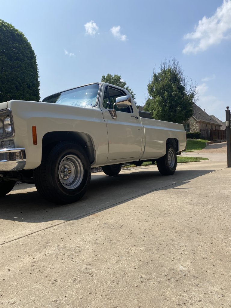

Fire truck,
Great help with the instructions on how to measure for offset. Thank you..
Randy and Easton
