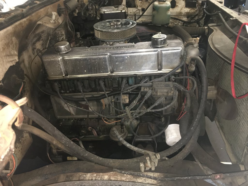

My C30 has over 96k miles, and the 292 six under the hood currently has 40 weight Valvoline race oil in it, but it's time to change it out. I've had someone tell me that too thick of a viscosity may wear out the oil pump quicker, but I'm not sure.
What's the best oil viscosity for an old engine in the midst of the constant weather changes of Texas?
It might freeze over and snow in a few months, but after spring, the summer gets upwards of a hundred degrees.
I would appreciate any advice!

Any 5w/40 or 10w40 will be fine as long as it has high zinc for your flat tappets. It may be easier to use an additive if you can't easily find the high zinc oil. I use VR1 10/30 here in southern Arizona. Oil will not hurt your oil pump regardless of viscosity.
