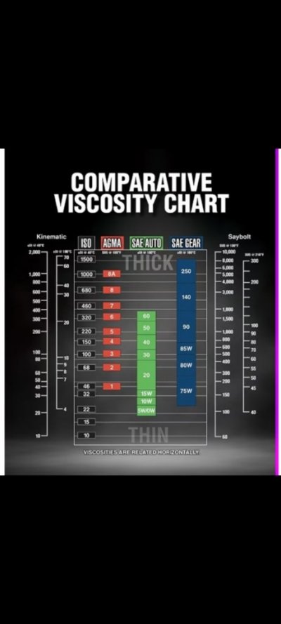

FWIW viscosity ratings on gear oil is not the same rating as motor oil. I think 90w gear oil is the same viscosity as 50w motor oil. Not picking on you Kev, just sharing info for you and anyone else that wants/needs to know.

I always thought that viscosity index ratings were based on the same criteria, different oils are different thickness and flow accordingly, and the only constant that doesn't change is gravity always applies.
4,056
5,891
What you said makes sense to you and me. But not engineering geniuses. IDK why.
