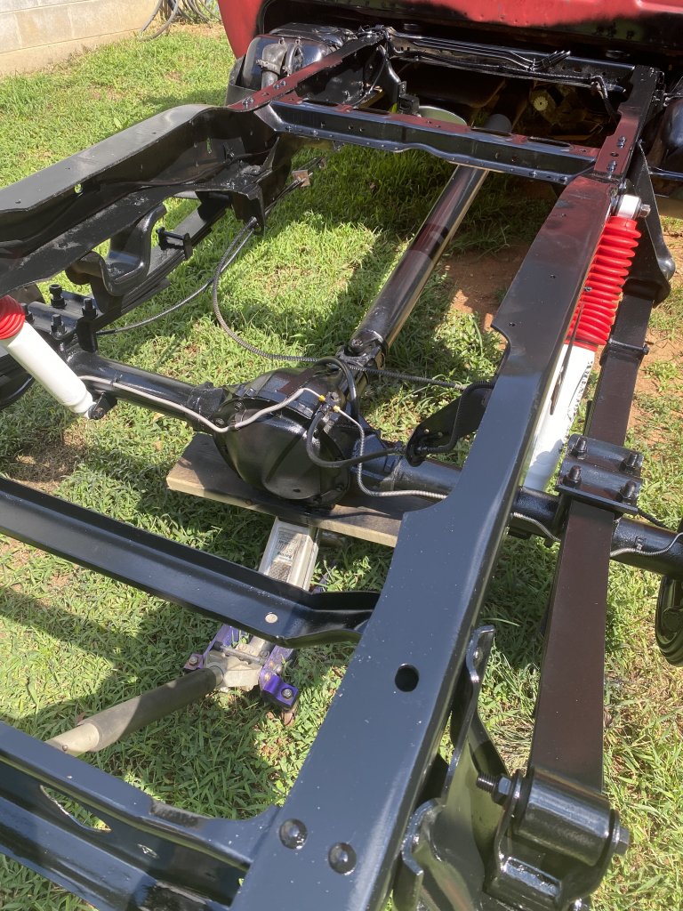

Finished up some frame painting on the frame , installed my rear shocks . Replaced my rear brake lines , with SS
Next run the rest up toward the front . That should be fun . Got them from U line
