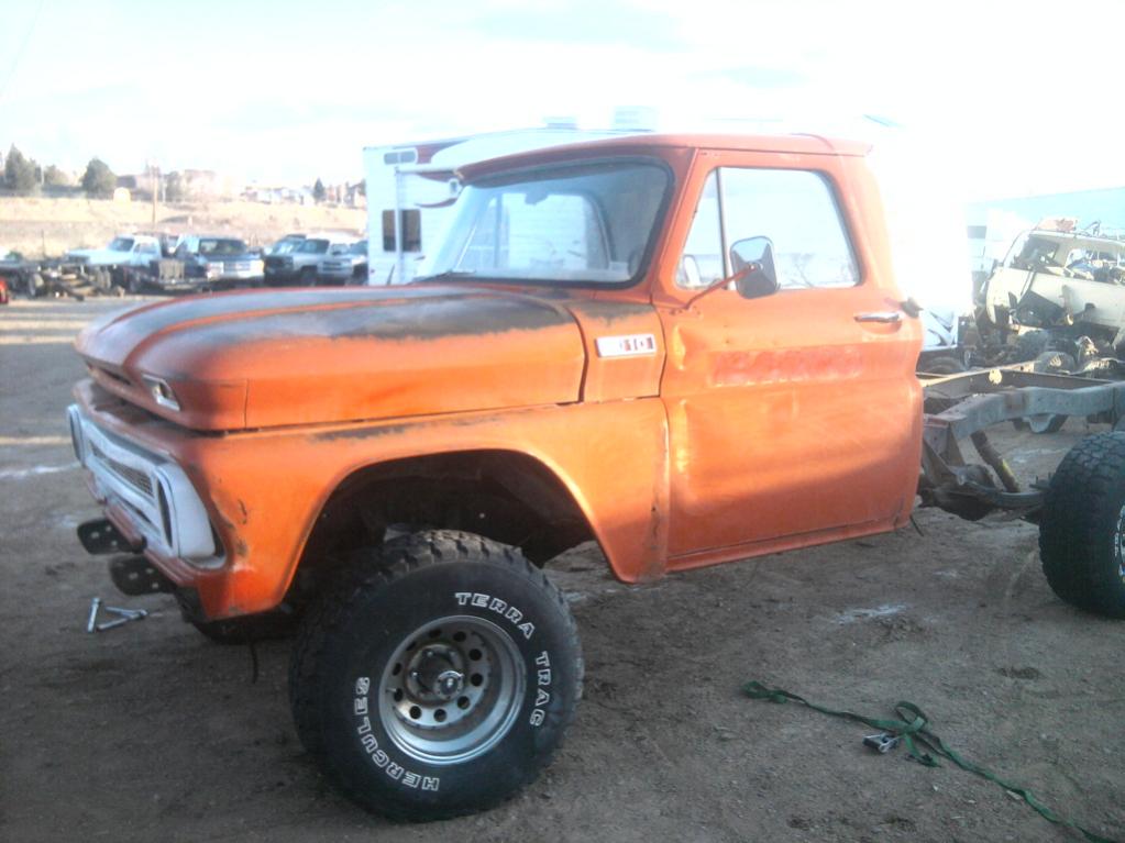

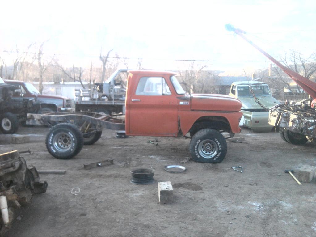

this really does not qualify as a square as it will only be using some square drivetrain parts.
but its what i worked on today
71 chevy 4x4 chassis 65 c10 body
got the cab and front clip sit on the frame and bolted up some wheels

Nice !!! So how well does that body match up and bolt to that chassis? I'd sure like to find out how to go about getting one of those bodies on a squarebody 4x4 chassis.
kleedus
Jan 25, 2012
1,726
176
wyo
Ray
1960 threw 91
c10 to k30
350 threw 454
actually its almost a bolt on swap
the 63 to 72 frames are almost the same
in 67 they changed it a little bit the changed the steering box mount so a power box will bolt on
with the body style change in 67 they changed the rear cab mounts and the core mount changed a little. the front cab mounts are the same and the bed bolts on the same
to put a 63 to 66 body on a 67 to 72 frame you need to use the rear cab mounts off the older frame and use the body bushings from a 67 to 72 truck
the front frame horn needs swapped (cut off old frame welded to new)so the bumper will bolt on
and on the older truck the radiator sits in a cradlle on the front frame x member it can be swapped to the new frame as well
this is actually the second swap like this i have done
60 to 62 trucks had a different frame all together they will not even bolt to a 63 to 66 frame without some modification but it can be done

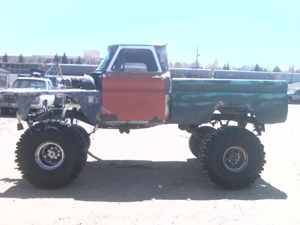

as far as a 63 to 66 body on a square frame it can be done i am doing it to my mud truck kleedus i have a thread on it somewhere.
the 60's wheel base is shorter than the square is so the frame needs shortened and body mounts swapped.
i am not shortening my wheel base cause it is lifted 15'' and running 44'' tires it looks ok without the wheels centered in the wheel wells.

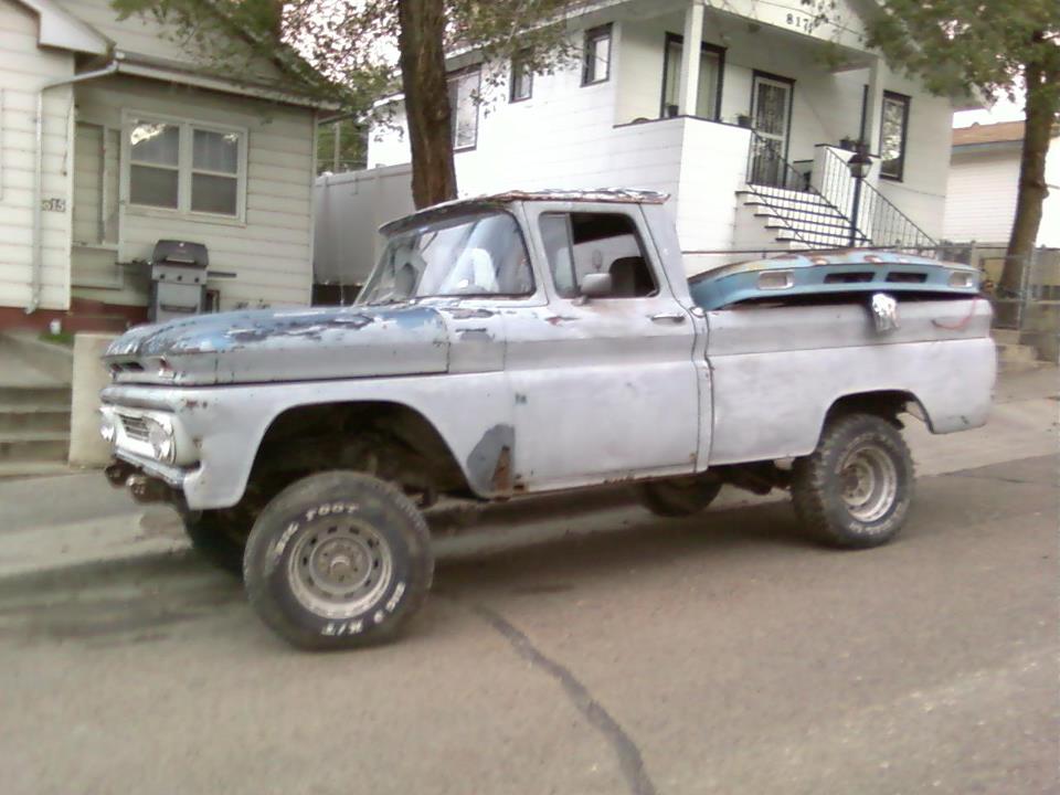

if you want to make a 60's truck a 4x4 find a 67 to 72 truck frame its really a easy swap and it takes someone that knows there **** to know the difference.
the grey truck was my first 4x4 swap with a 71 chassis the other picture is kleedus on a 87 frame
