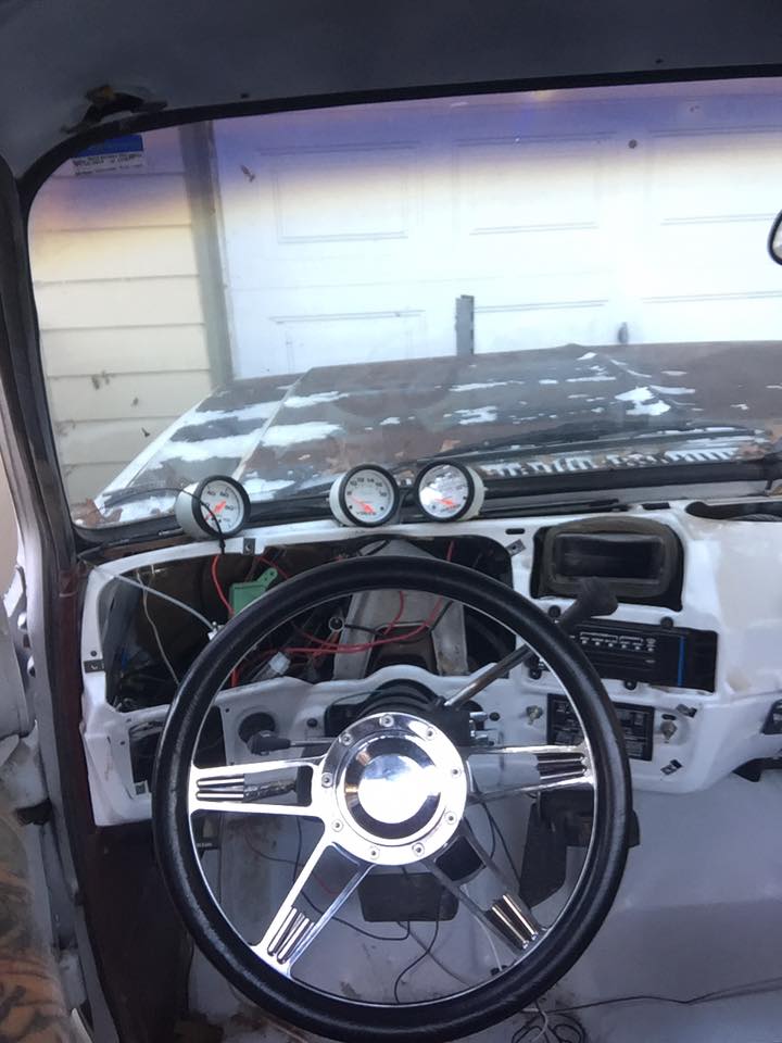

installed a $50 billet steering wheel not "show quality" but better than the stock one. didnt even need my fancy wheel puller neither to take it off, just a little will power and off it came.

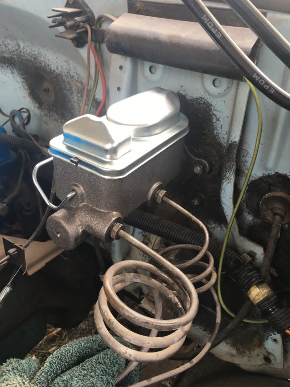

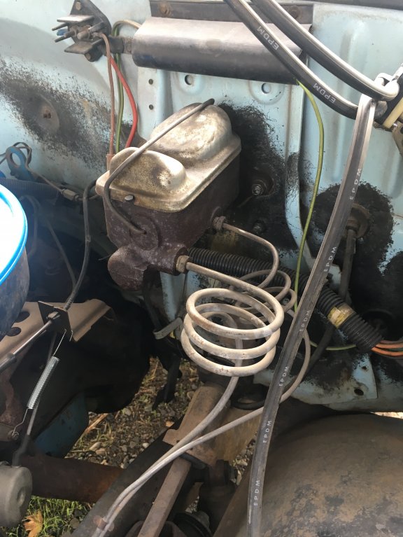

Replaced the leaking Master Cylinder and flushed the entire system. The brake fluid came out black, it had been so long since it was last done (probably 10 years ago at least). Took a whole large container of DOT-3 to actually get all 4 lines to bleed clear.

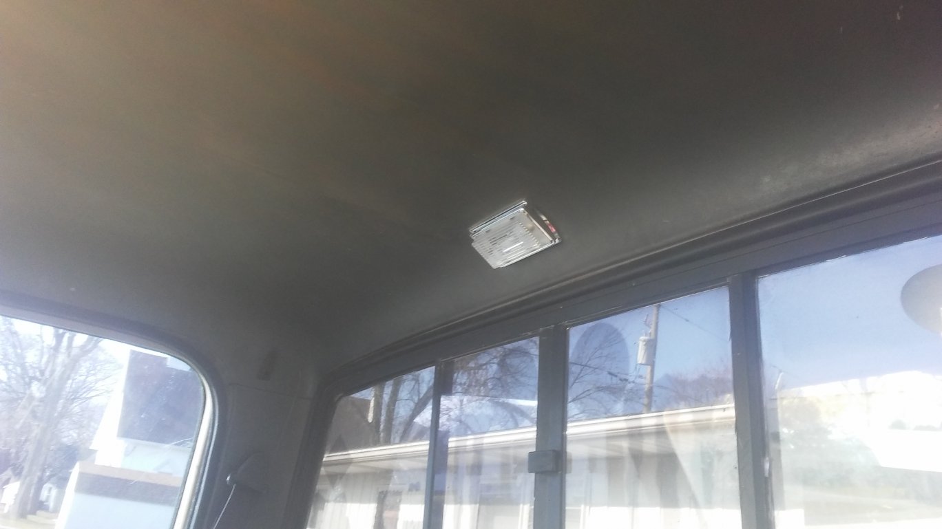

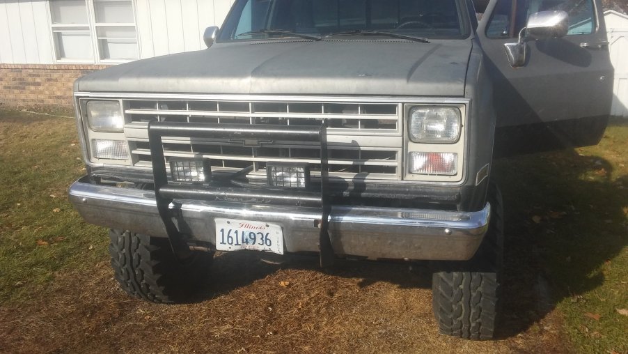

Lighting nothin fancy but giving credit to lmc for a nice dome light and running/ turns

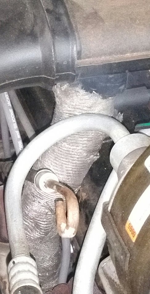

My 90 1500 4x4 has been knocking and pinging like an old Benz diesel. Under and load it sounded like crap and ran the same. Headed out to the lake in western PA last weekend it couldn't climb the hills eas of state college and I almost caused a pileup as it went from 75 on flat ground to 45 half way up. On flat ground it flies but dies up steep hills. Friends have been telling me about sea foam to clear the carbon out. With the help of a buddy we ran a can through a vac port and she smoked pretty good. I ran it till the smoking stopped and let it sit overnight. Then I put a can into 1/4 tank and ran it through. I must say the pinging had been reduced, not 100%, and had much better throttle response. Only problem is I found a have head gasket leak? That caused the fluid to get into the exhaust and smoke. It eventually stopped. Will run more through the tank and go attack that hill again for a true test.
I would say it has improved the performance. I improved one problem but found another.

Tom, What vacuum port did you put the Seafoam in? If it is into the throttle body/intake that will go directly into the combustion chambers so that will smoke.
Not sure what other vacuum port you might mean.

When was the last time you hit ot with a timing light sounds like she maybe do

Yea it says on can to help clean up but running it in fuel tank will do the sam just not as high concentrate
