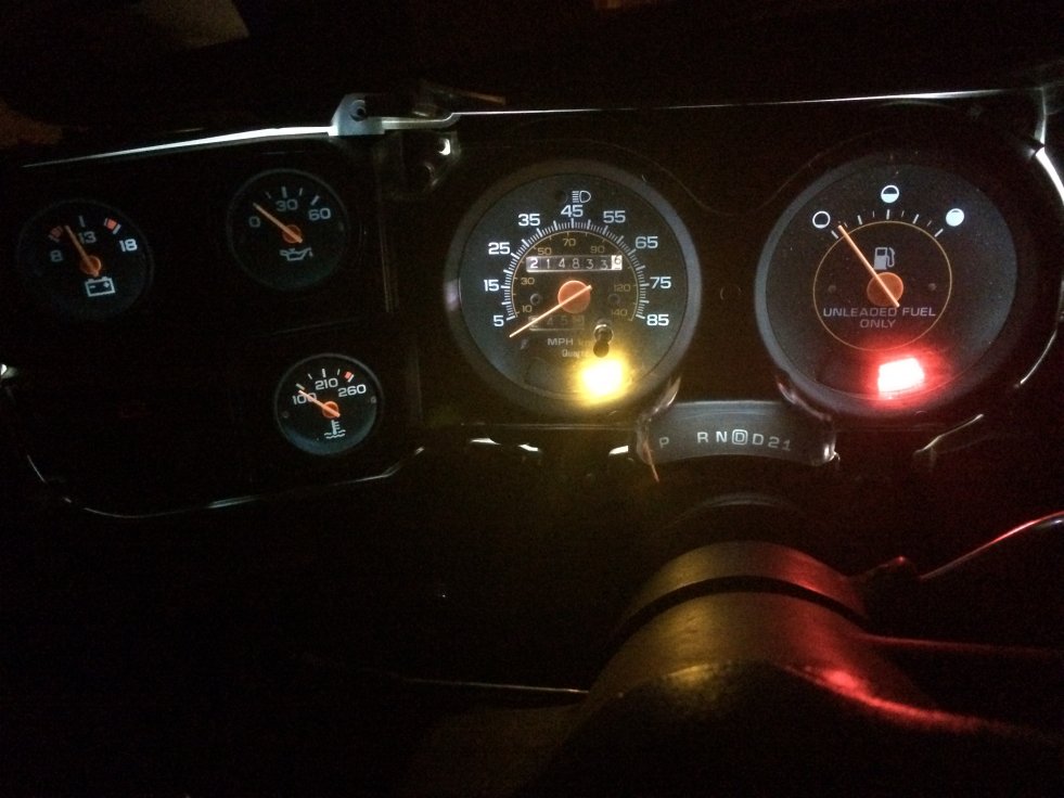

Installed LEDs into the 91' Burb cluster I put in my 88' for my LS swap.
attachment.php
attachment.php
