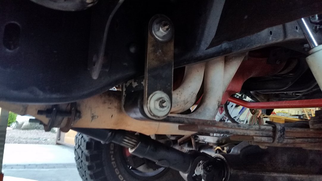

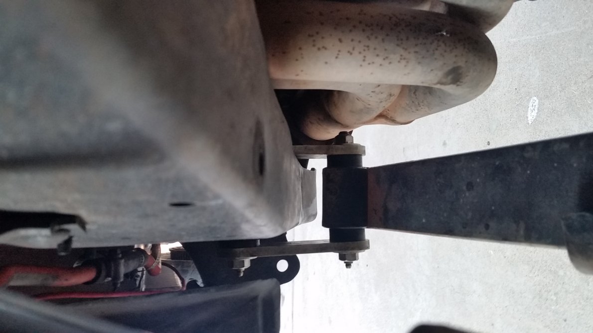

Put some ord greasable busings and new shackles on the front yesterday. The old ones were rotted out prety bad to where the axle was hitting the frame and moving around when stopping. The driver side frame mount bushing was wore through to metal on metal. Drives like a dream now, steers great. no wobbling or any of the problems i was having before.
