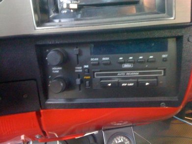

I found a pic of the stock 1.5 din in a square, wasn't looking, but did just stumble upon it

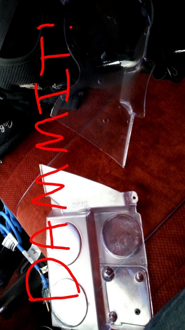

Broke my good cluster cover. 25lb backpack won :(

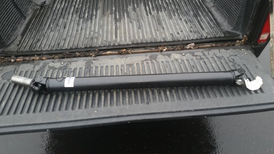

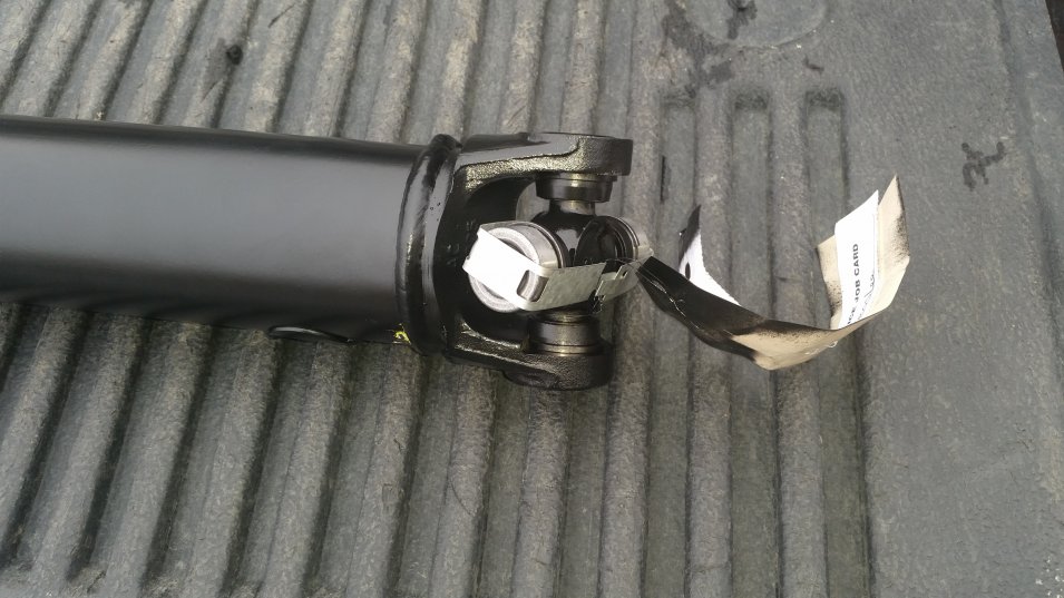

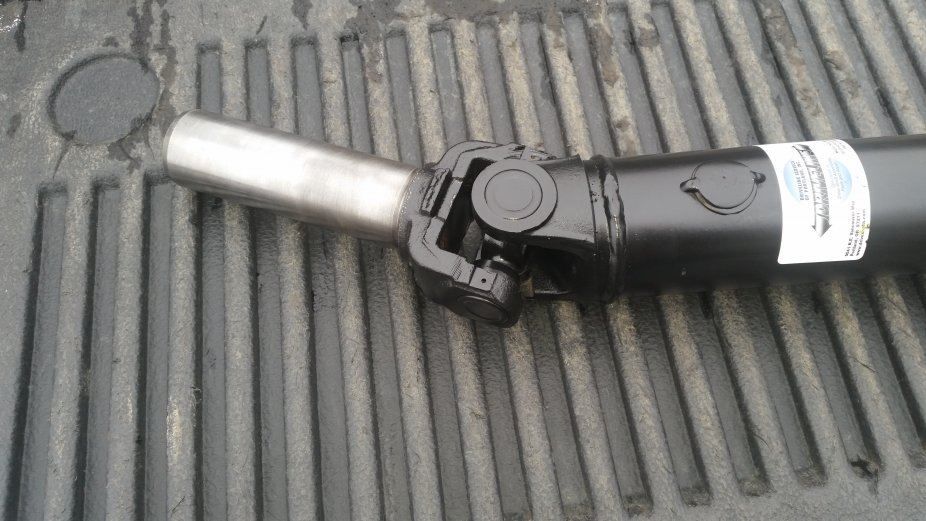

For Christmas this year, I got the shaft...literally!

Nice. Did you have it cut or lengthened? Or just new U joints and balanced? It's been many years now, but IIRC, it seemed like it cost me $80 labor to have a 2pc driveshaft balanced, carrier bearing pressed on and my U join'ts installed. No length mods made. I bet it cost alot more than that now.
one4fun
Jun 1, 2013
175
6
Portland, oregon
chris
It's a new shaft from yoke to yoke and two new Neapco u joints. Went with non greasable joints. Stronger and I won't have to worry about greasing them. The slip yoke is not new. The original shaft had yokes that were pressed and welded, so the tube ends were flared and would have to be cut, leaving the shaft too short. So, a new 3" diameter tube with .083 wall thickness, a bit longer so it's the correct length now. Brought my old one in yesterday morning, gave the length for a new one and picked up the completed new shaft, balanced and ready to install this morning. $305.
