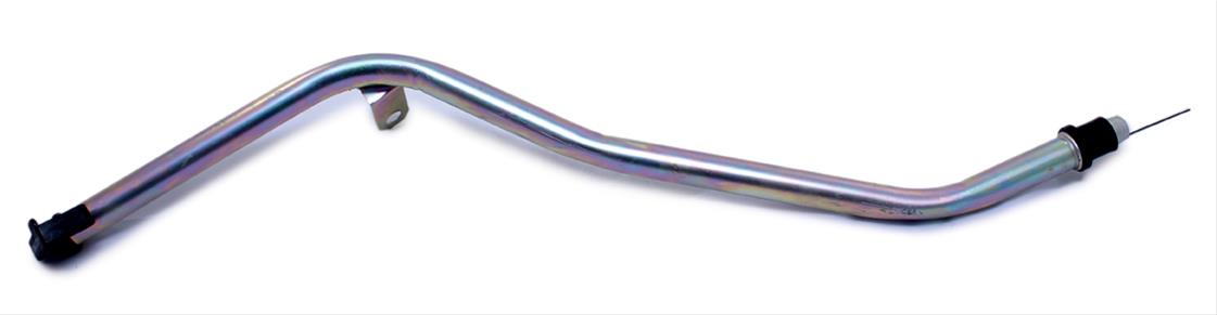

Well, there's this
I do have a chrome 24"ish stick and tube. Might see if it will fit in leiu of hunting down the proper unit. Hey, the tool box/bread truck has a th400..... hmm. I'm off to see the wizard....

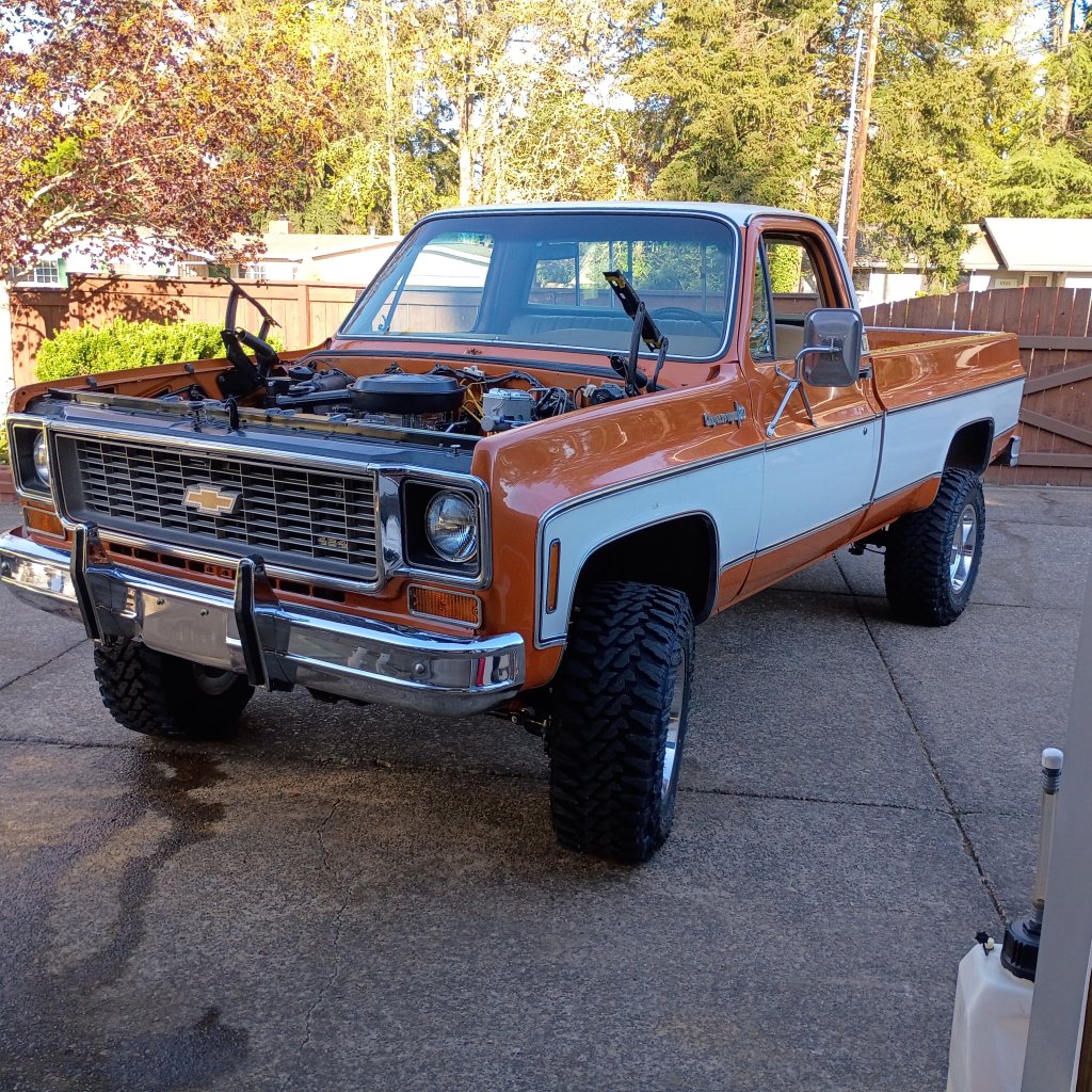

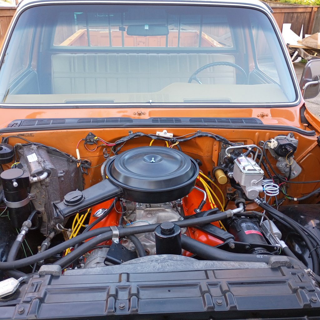

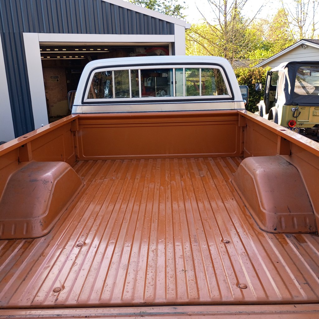

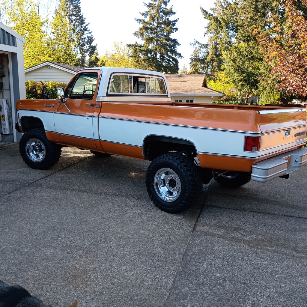

FINALLY got the '73 out for a test drive. Pulled it out of the garage for the first time under it's own power in 10 years, then crawled underneath to check leaks, loose stuff, whatever......and as blind as I am, I noticed the c-clp at the base of the sector shaft on the steering box was dislodged. WTF!! I rebuilt it with an Edelmann kit a few months ago. Removed the pitman, pushed the seal back, and re-installed the clip, but it just didn't feel tight enough. Dug the C20 box out, removed it's original c-clip and noticed it was at least 1/16" bigger in diameter and the spring steel just felt better. Used that in the K20 box and we're back in business. Ran around the block, breaks work well, hydroboost functions as it should, no squealing, a bit of an exhaust leak at 1 doughnut, a huge success!!

WOW that’s a gorgeous truck! Congrats on getting to take her for a long overdue walk, even if a short one. Had to feel GREAT!!

Thanks for that. Taking a rig out for the inaugural run after a body-off is always stressful, lots to be on top of. I find I manage it much better when I'm by myself, keeps my focus inline. This was the first big block I built from scratch, and the first hydroboost I've installed and honestly the first 4x4 I've put together. That, and the trans and transfer were transplants with 0 familiarity, only the fluid to gauge condition. Both are without issue......so far. The Dana 60 front was also a first, and started out as a dually front, which was a pretty expensive piece to go through, even though I essentially got the core for nothing. Biggest issue I have so far is I assumed my rear out of the C20 was a 4.10 ratio, and felt great getting the 4.10 geared D60. Turns out that rear is a 3.73, so after going through the front, I now have a choice to make, change gearing in the front, or the rear. That decision will be made after I get it on the highway and make an informed decision. An overdrive isn't in the cards at this point.

Wow! Stunning truck!
Regarding gears, depends how you want to drive it, IMO.
Big block = enough power to pull even taller gears than 3:73s.
4.1s with 35s is 3k rpms at 70mph.
3:73s better if you’re wanting to put any real miles on at normal freeway speeds. 4.1s ftw for pulling.
