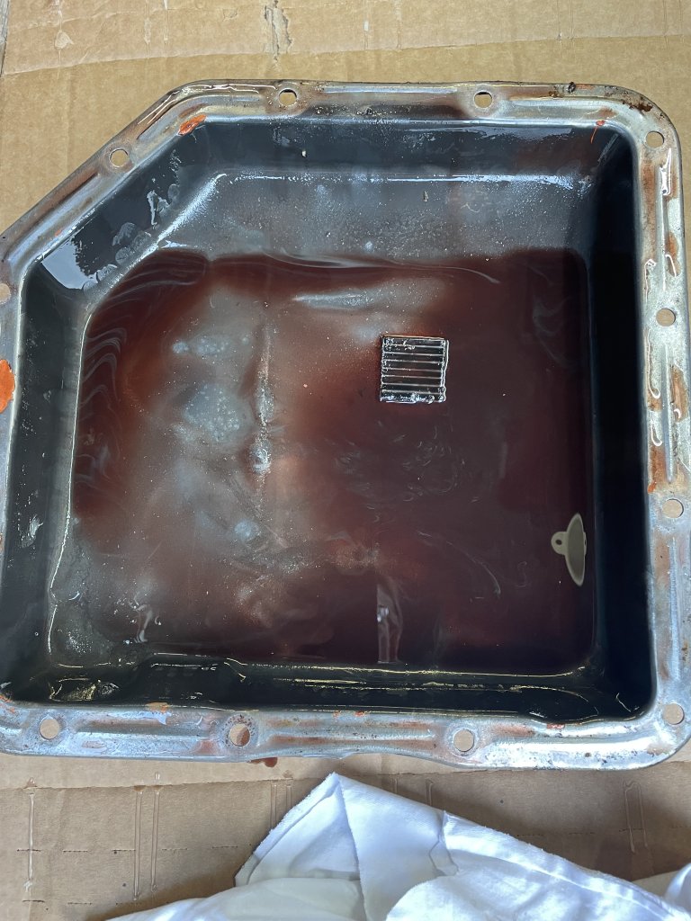

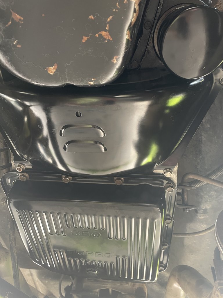

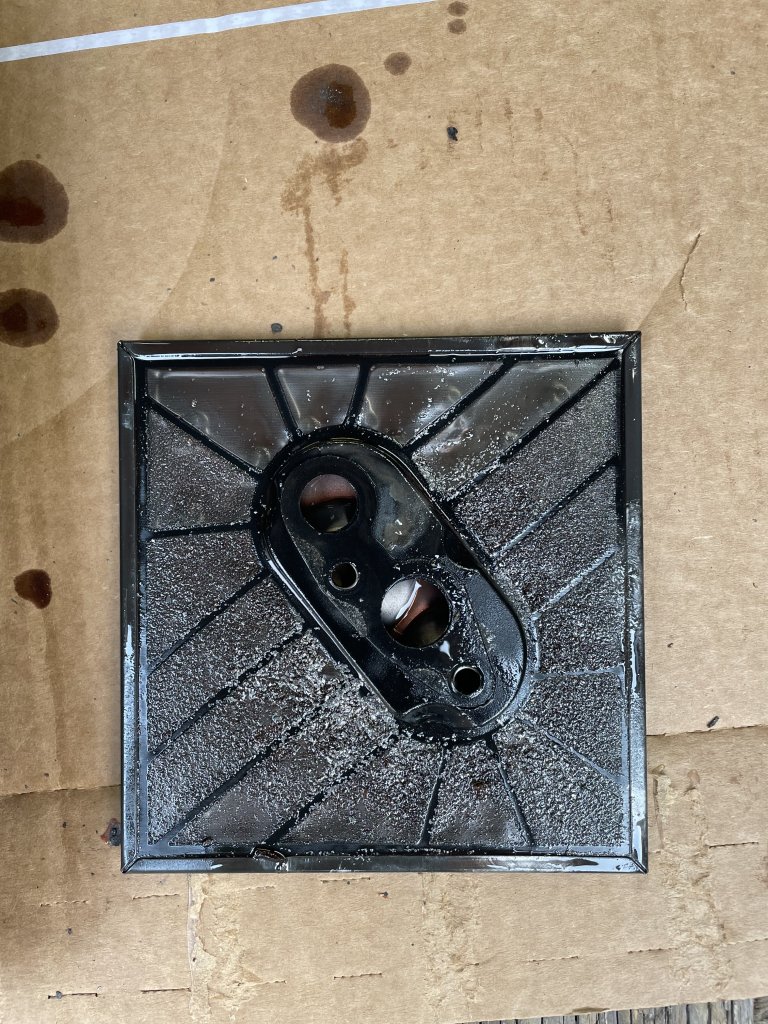

I got around to changing the trans fluid. What I found is not what I expected. Any way I installed the new pan and filled it up. it’s still shifting fine. I figure I’ll drop the fluid again in a week or so and see how it looks. Apparently some dumb azz installed the previous filter upside down. Who could that have been! Continuing the black theme.
Ooooofffff... might as well drive it till you can't no more!!

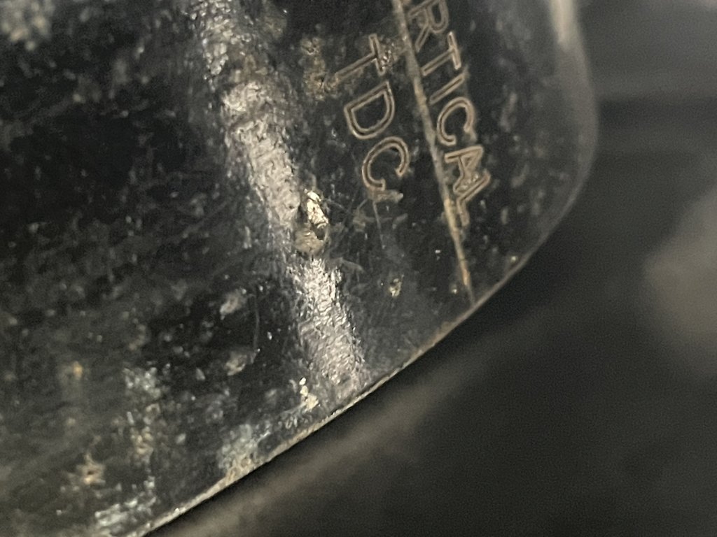

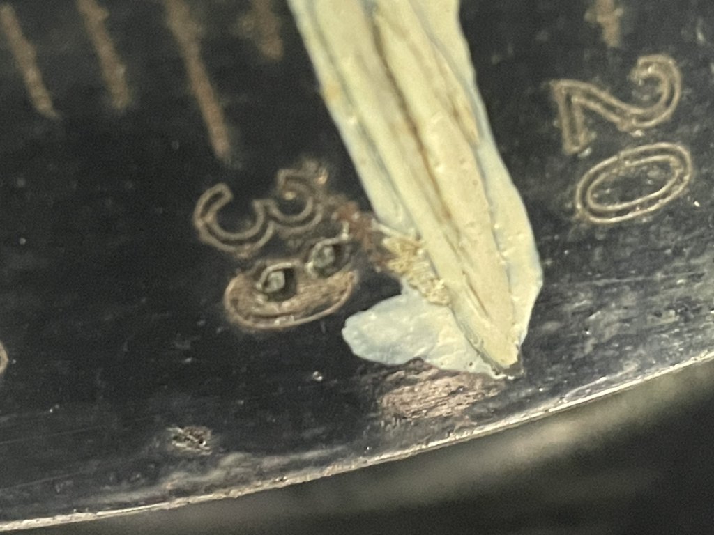

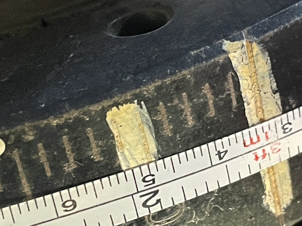

I also finally got around to finding the true TDC on this combo. In the past I have had the timing much retarded, and today it was much advanced. I bought a new piston stop lost my old one somewhere. This engine has an aftermarket balancer,a different cover , and a different timing tab. I think the original timing tab was lined up at 12 o’clock and it had the tube looking down behind the H2O pump. I found that at 4 degrees on the balancer the engine is at TDC . My timing was set at 8 degrees advanced with the new mark it was 12 with me using the zero mark. I connected the vacuum advance and it went to 40! . I disconnected the vacuum advance and checked the mechanical. It also went to 40! This is a Vortech headed 350 with the ramjet roller cam. I bumped the initial down to 4 and am going to send it, and see how it runs. It looks like I will have to do some dizzy work to get the mechanical where it should be. I’m thinking 30 to 32 , total on the mechanical. I would like 8- 10 initial. More to follow.
I had to modify the piston stop. You can see where the piston just touched the screw. It was almost all the way in. I was afraid I would drop it in the cylinder!! The piston is way down in the bore. You can see my old paint marks I was off with both of them. 4 degrees using the zero mark and 6 using the 10 degree mark. My using the stop you can see a mark on the 30 degree mark and the other one close to the vertical line. It was 3” inches between them. At 1. 5 inches the mark is at 4 . Hope this helps someone understand how to find TDC on a unknown or non stock build.
