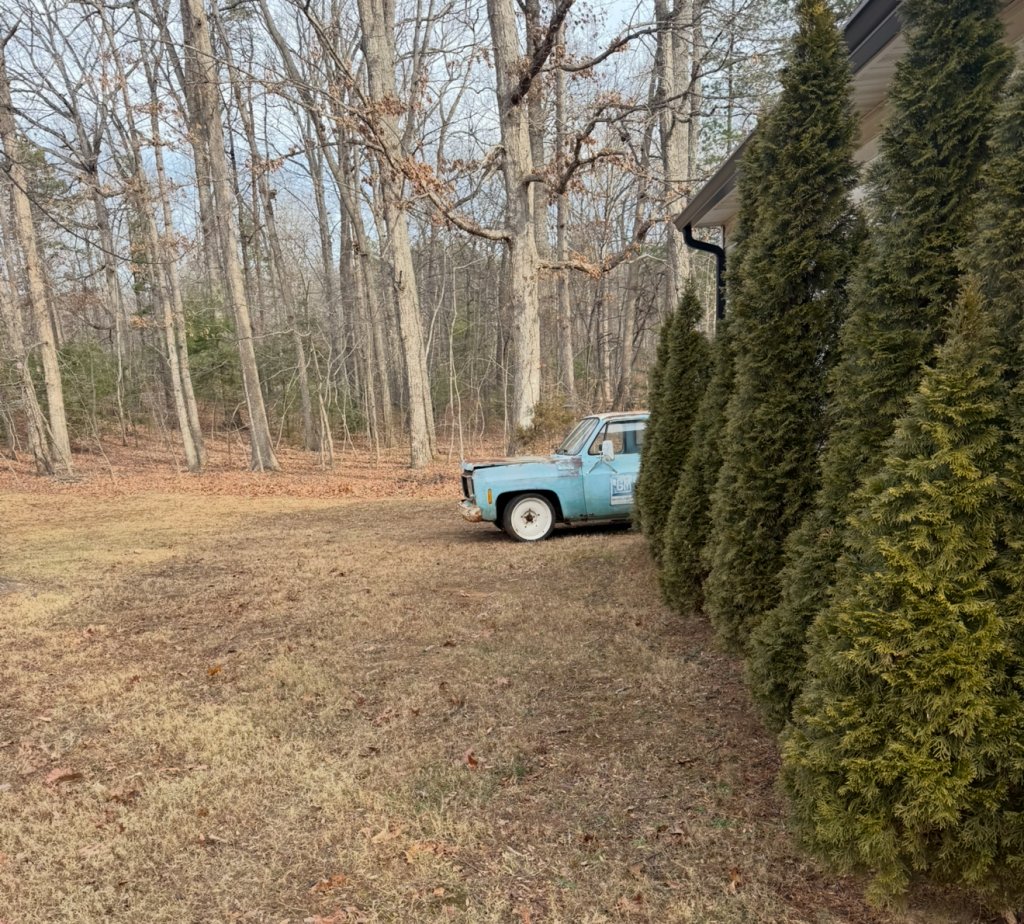

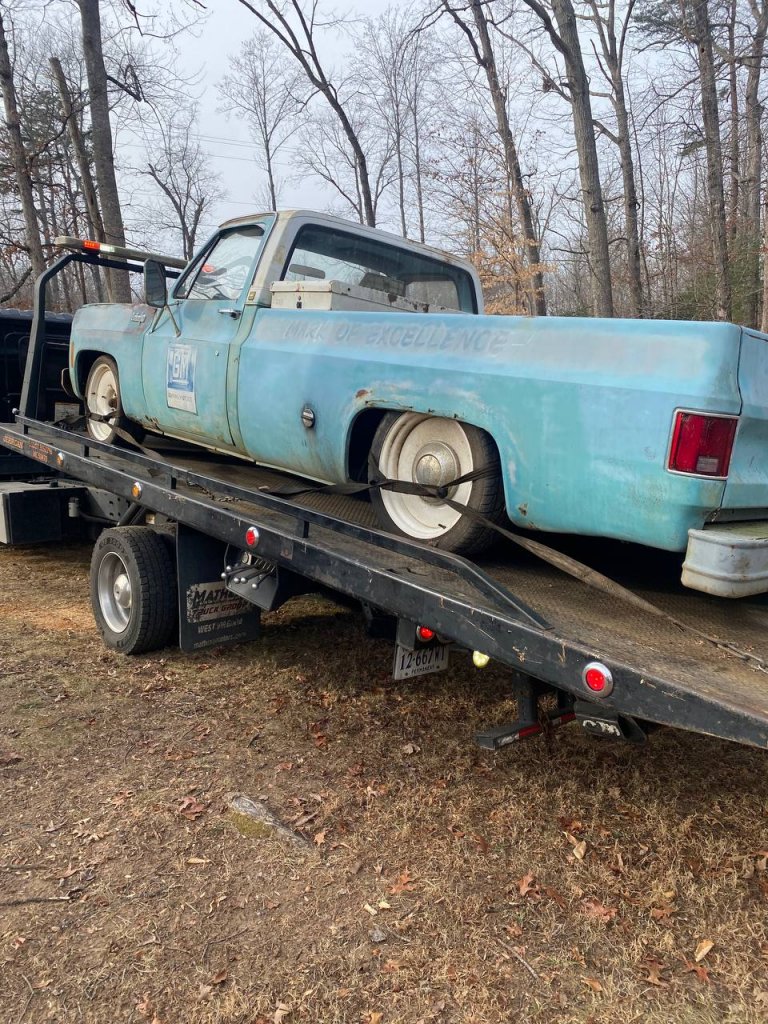

Got her moved and loaded between yesterday and today. Finally after 3 years of sitting it’s off to the shop. Where my buddy will redo the air ride and I’ll throw a collection of 7 years of parts at her. Big excited lol
