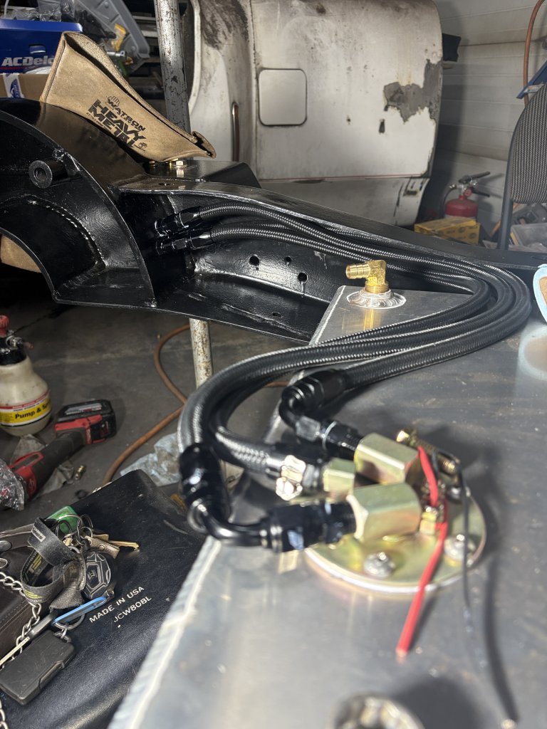

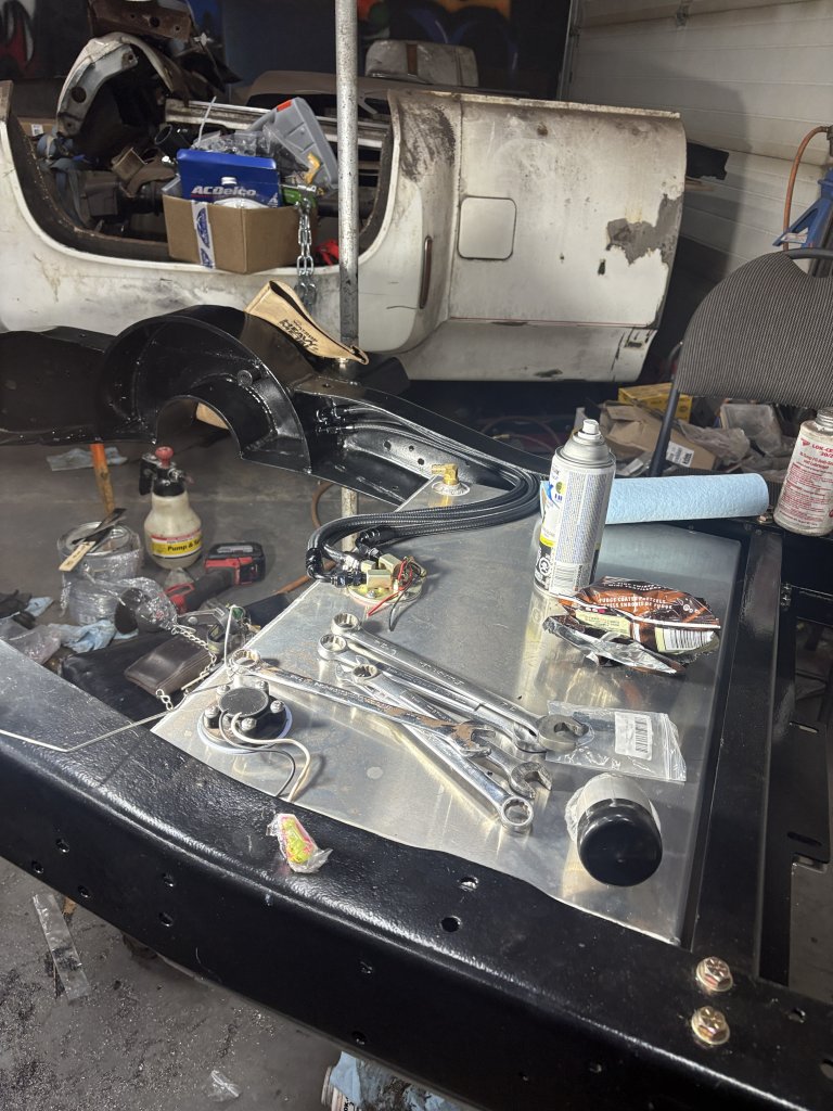

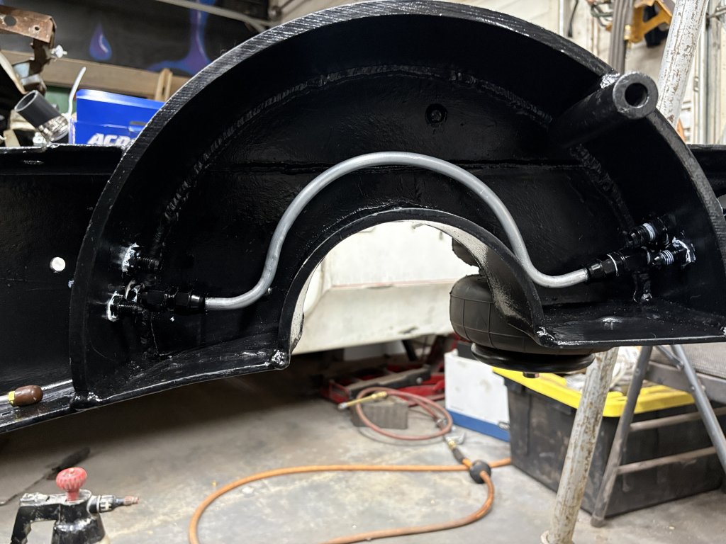

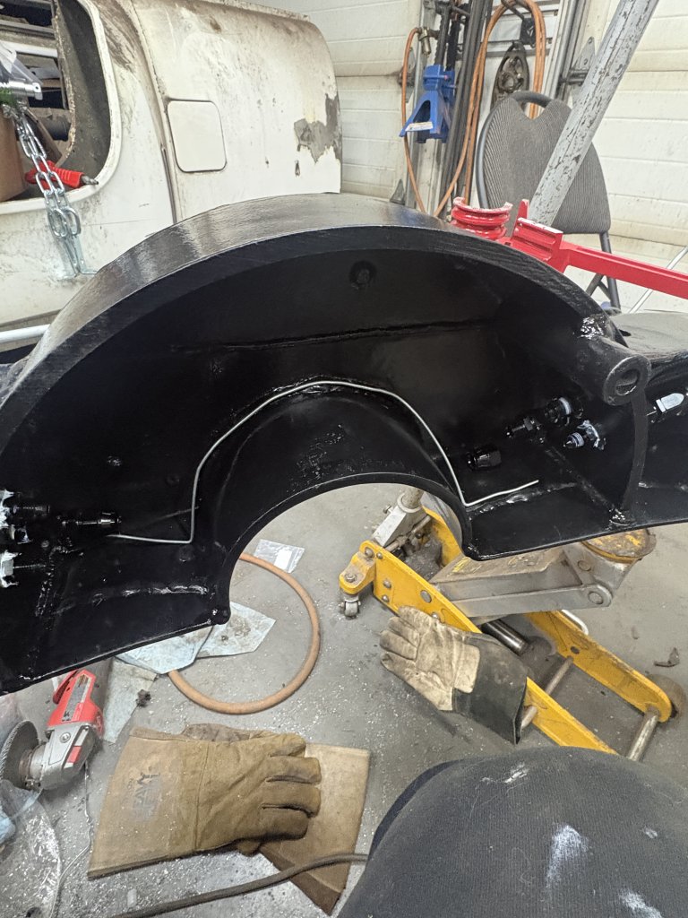

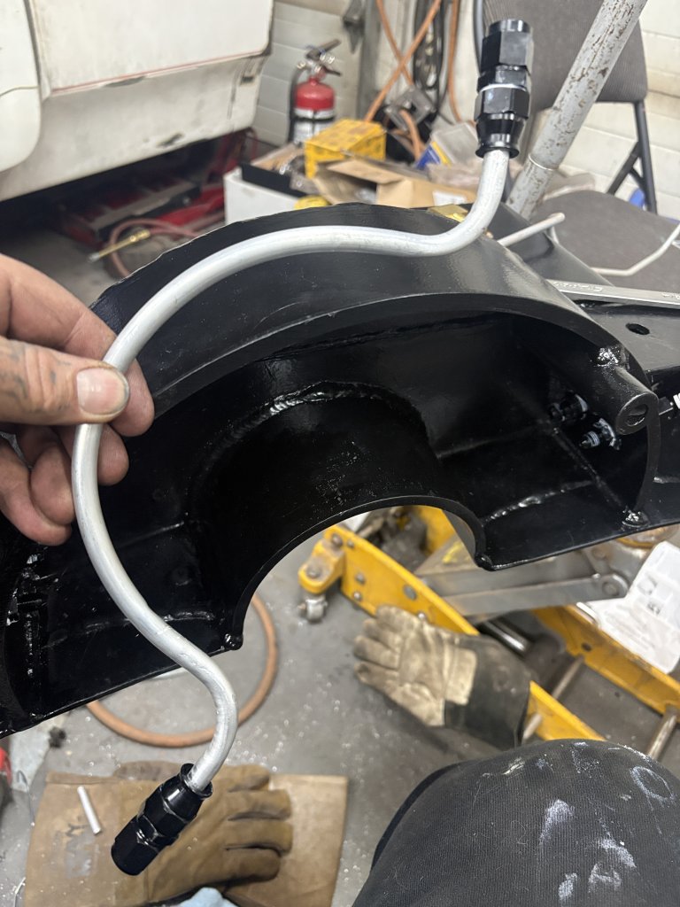

Installed lines to the pump and fabricated hardlines for pass through on the c notch

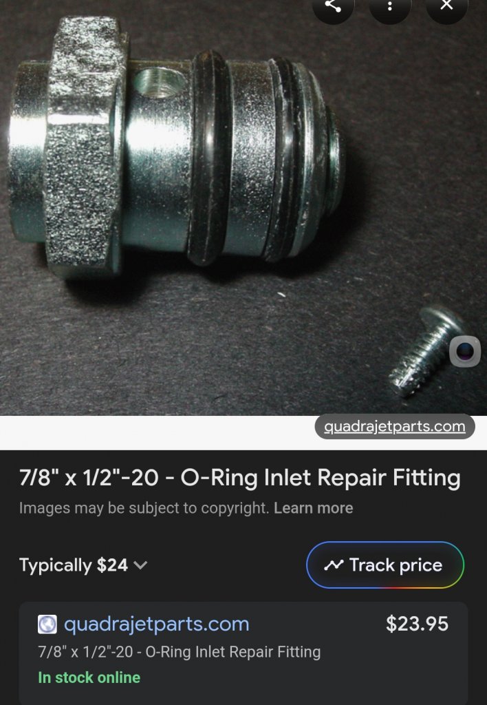

What is wrong with rebuilding the 454 carb? Okay I read back 900 posts and found the issue. I thought I had already suggested an oring style,pinned repair fitting in the past. But depending on how bad the crack is. I stop drill the crack. JB Weld the crack and used a pinned fitting. The don't screw in and are retained with a set screw.

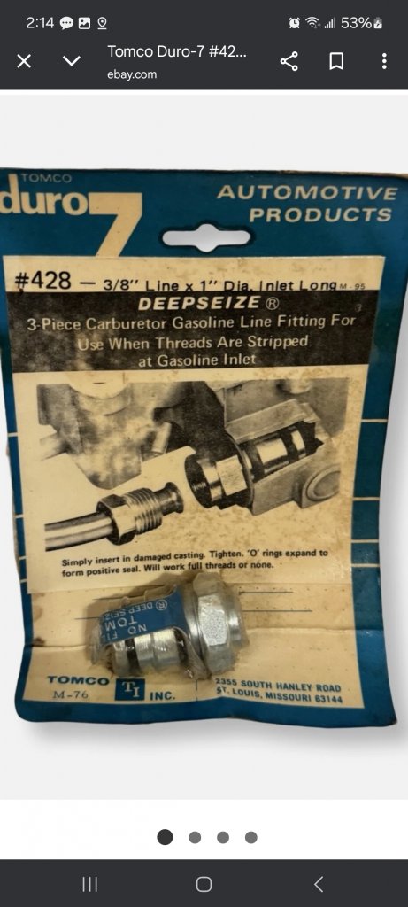

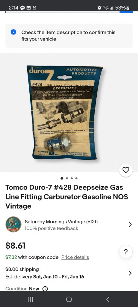

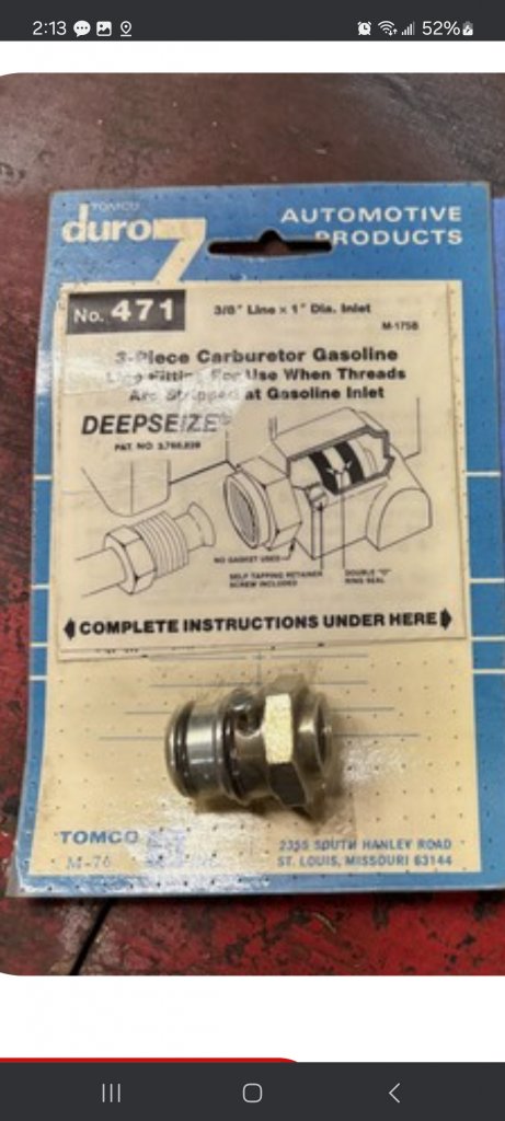

I just went looking for the aforementioned fitting and this is what I found
Chit
10,171
19,666
Look for the correct one that was just the first one I found for the pic. Call quadrajet parts. Maybe a deep sieze fitting would work. Driving can't look for a pic they are expanding oring seal no threads. Tomco 466,467,471 etc I don't know which one you need. I think you need a tomco 428
AI is not entirely correct. These are not self tapping oversize fittings. They do make suck a thing but they are a different thing.
