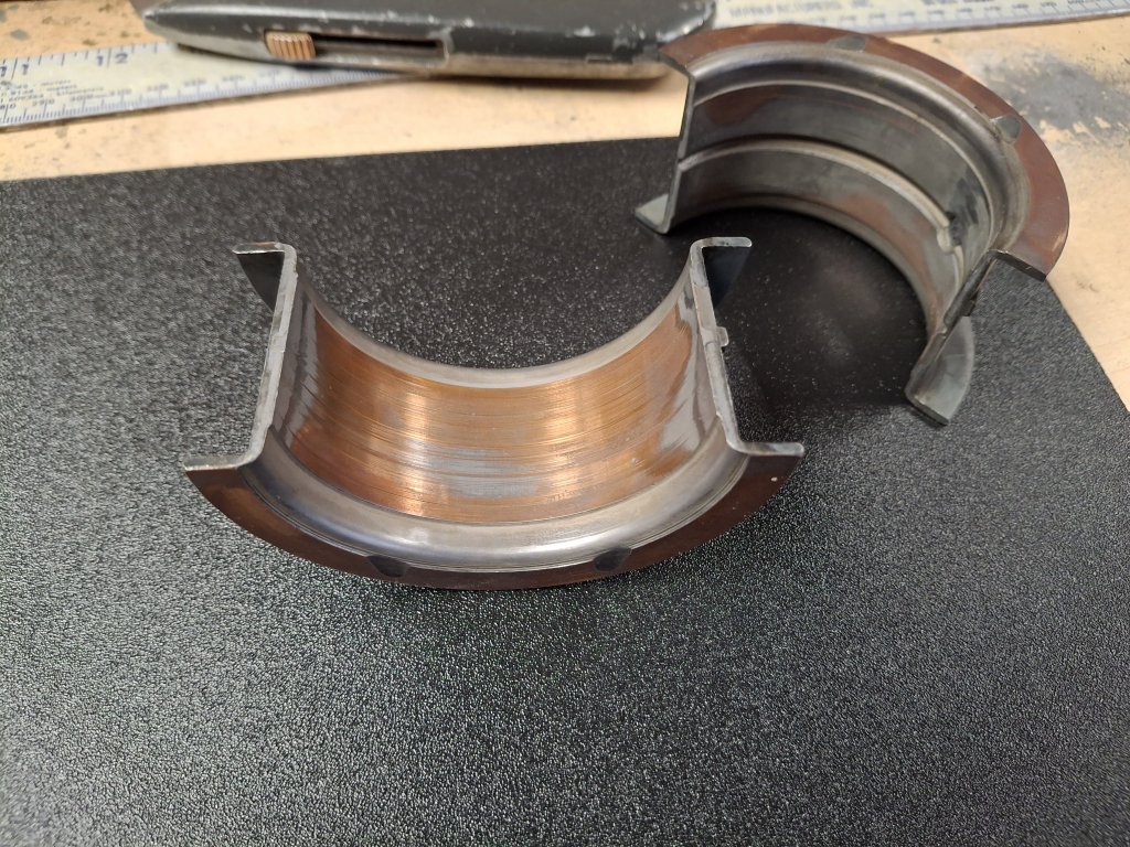

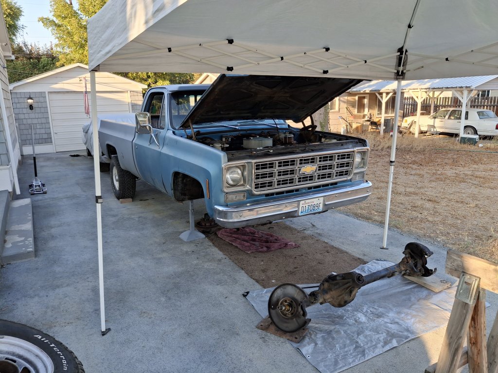

About a week and half ago, I pulled the front diff out my 78 K20 to do a swap with a friend for a 3.73 diff to match my rear end. While the diff was out seemed like a good time to address a few bottom end engine leaks, so I dropped the pan and removed the rear main cap to change the rear seal. Guess what I found? A LOT of copper showing, a bunch of black plastic chips in the oil pan, plus what appeared to be a throttle spring in there? On top of that, the oil pickup tube was LAYING in the oil pan! I have no idea how long that was like that, or if it just fell out as I was removing the pan, but I nearly soiled my britches. The black plastic chips had me freaked out that maybe the engine had one of those nylon timing gears that was about to leave the chat, so I pulled the timing cover, too. To my relief, the gears and chain are newish steel and no chain slop. I suspect one of those damn plastic gears grenaded at some point in the engine's life and someone changed the gears and chain (and possibly the cam) without dropping the pan to clean it out. Which would also explain why the front pan gasket was not seated to the timing cover properly, had about a half inch of RTV on it, and still leaked like a sieve. I have no explanation for the spring except that someone must have dropped it in the oil galley years ago and it went all the way through. It wasn't even damaged. One more thing - the bolt holding the balancer to the crank wasn't tight when I took it off. The bolt wasn't long enough, so the threads didn't bite good and someone had buggered them up so it wouldn't torque down. Got a longer grade 8 bolt, problem solved and torqued properly. Funny the can of worms you open sometimes, but thank goodness I found all that crap now. This all in a daily driver that ran perfectly.
Soooo.....I spent this past weekend under the truck on my brand new asphalt driveway (yay!!!) rolling in new 30 under main and rod bearings in (journals were all in excellent shape), new oil pump (with the pickup tube spot welded to it!), new seals, gaskets, filter, etc. A lot more time and money than I planned on spending and one very smashed finger later, and it's mostly ready to run again once the diff swap is done. On top of that, my spare truck, 2002 Dodge Ram 1500, started smoking periodically like an old locomotive, so that one is on it's way out. It's been circling the drain for a while now, so I suspect it's not long for this world. All the more reason to get the old Chevy back on the road!!
