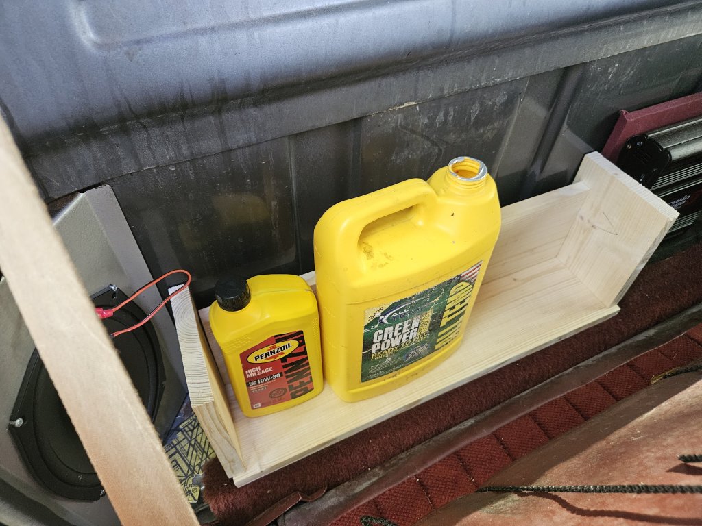

working on something to hold my spare fluilds etc behind the seat. This the mock up/cut stage. I will post a pic when im done.
I like this. I have temporarily fashioned one out of a narrow cardboard box that tapered to the top, kind of like a triangle, that a plant was delivered in to our house. It made sense to do because I keep the fluids back there as well, and the original tool/storage tray from GM was just cardboard made in a fancy way. I have been thinking about making something more permanent with wood and maybe covering with tolex...of course it will have to match what housing I put the big speakers for the bass in eventually lol. Also, it sucks that OEM replacements of the cardboard originals are over $100.00.

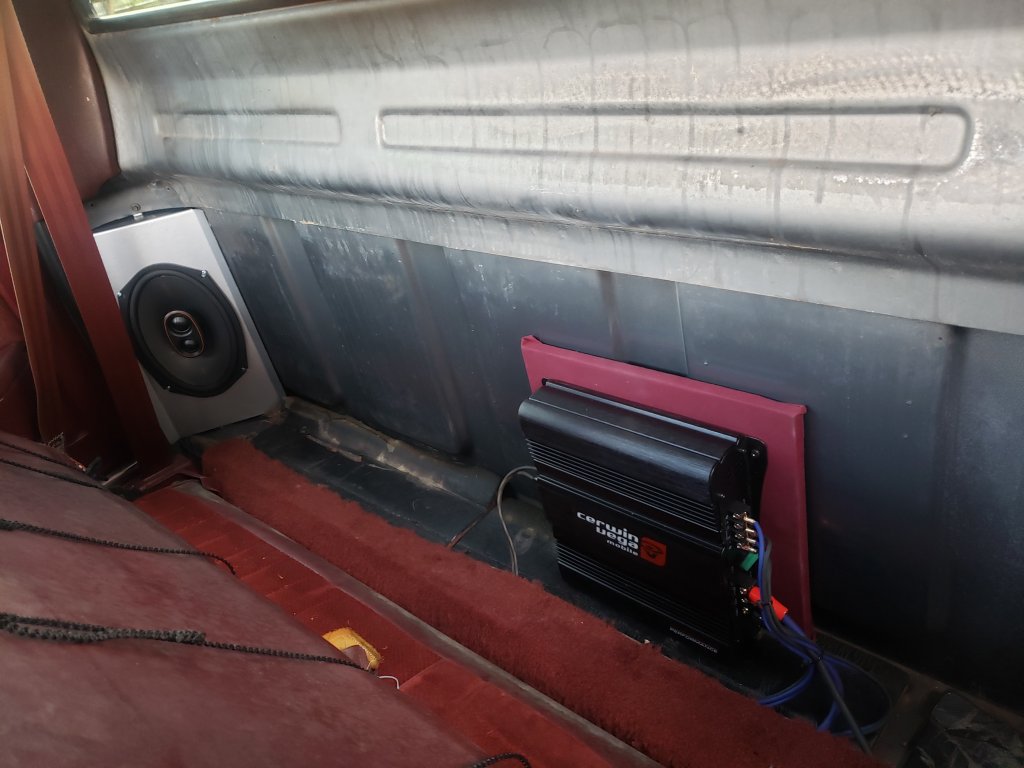

I got the brackets to hold the 6×9 speakers from wheels411. 55 dollars or so for the brackets. A direct fit in.

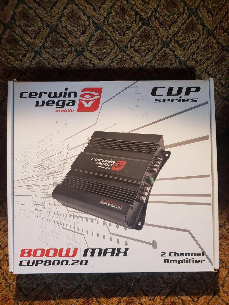

Speakers are Kickers... the highest dollar ones they make. Amp is cerwin Vega. Its a 100 dollar amp. My headunit is a retro sound. No subwoofer for me. Just some better than average 6×9s . Here is a better pic

James- the tolex idea sounds great. I had to look at up to see what exactly that was. I will be running something on the thinner side on the front side of the fluid/parts box. Maybe some type of mesh or something. Not sure yet as im still thinking on it. Every cm matters cause these trucks are very limited on space behind the seat.

That's what you got an eight foot bed for!!
I like my bed mounted tool boxes.

Yup, tolex is a fabric that Fender and other makers used to cover amplifier and guitar cases. Has a nice pattern and it's pretty durable.

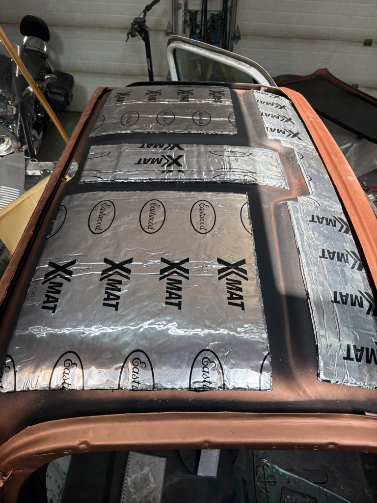

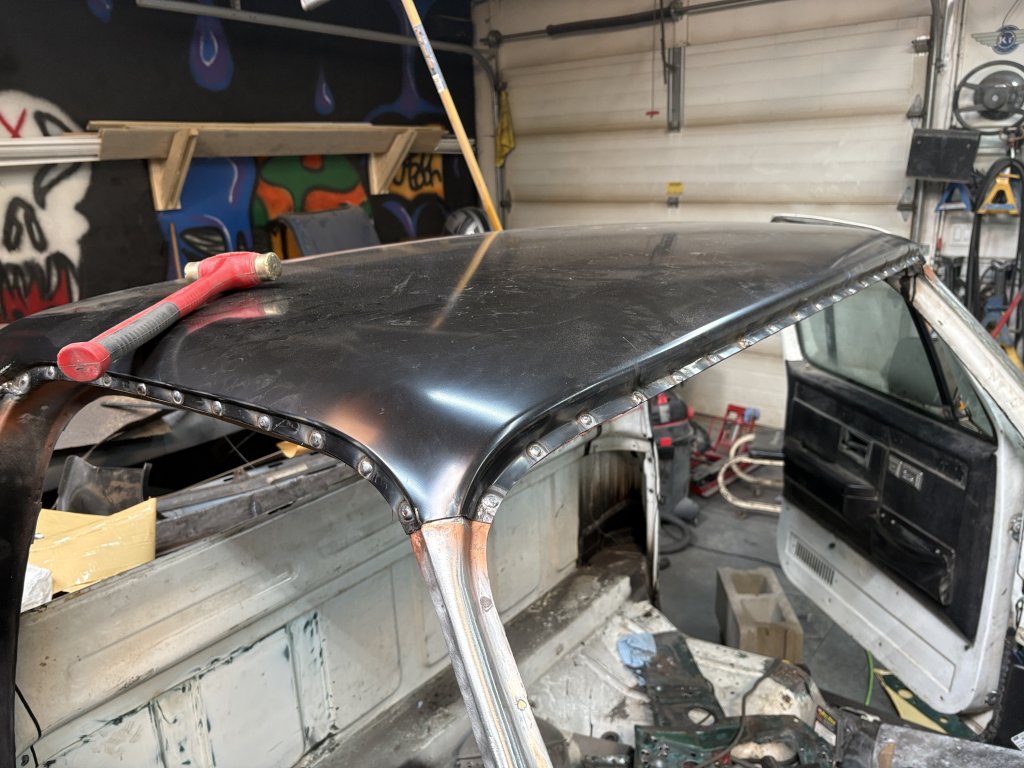

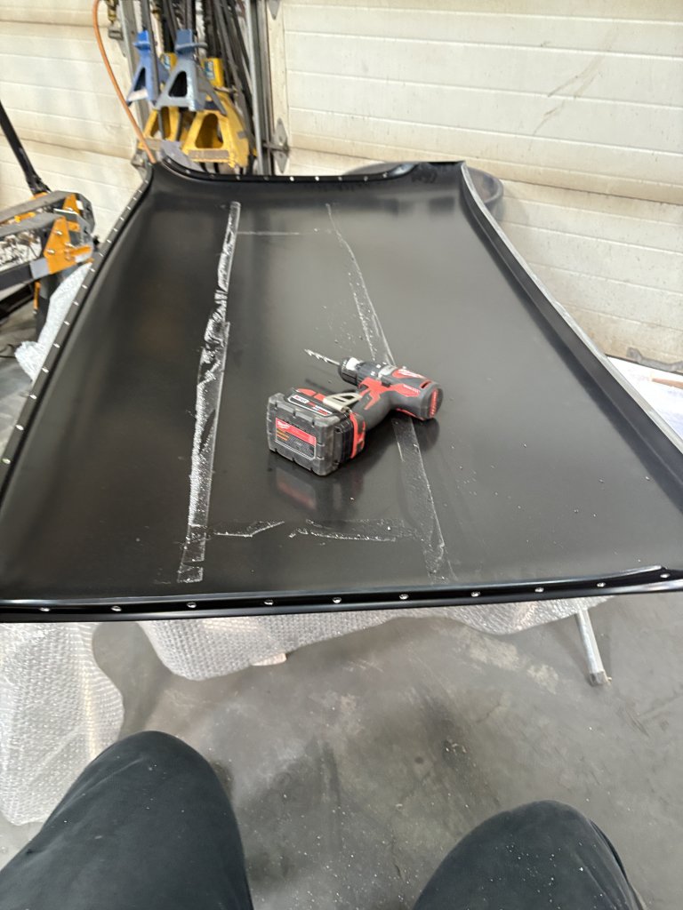

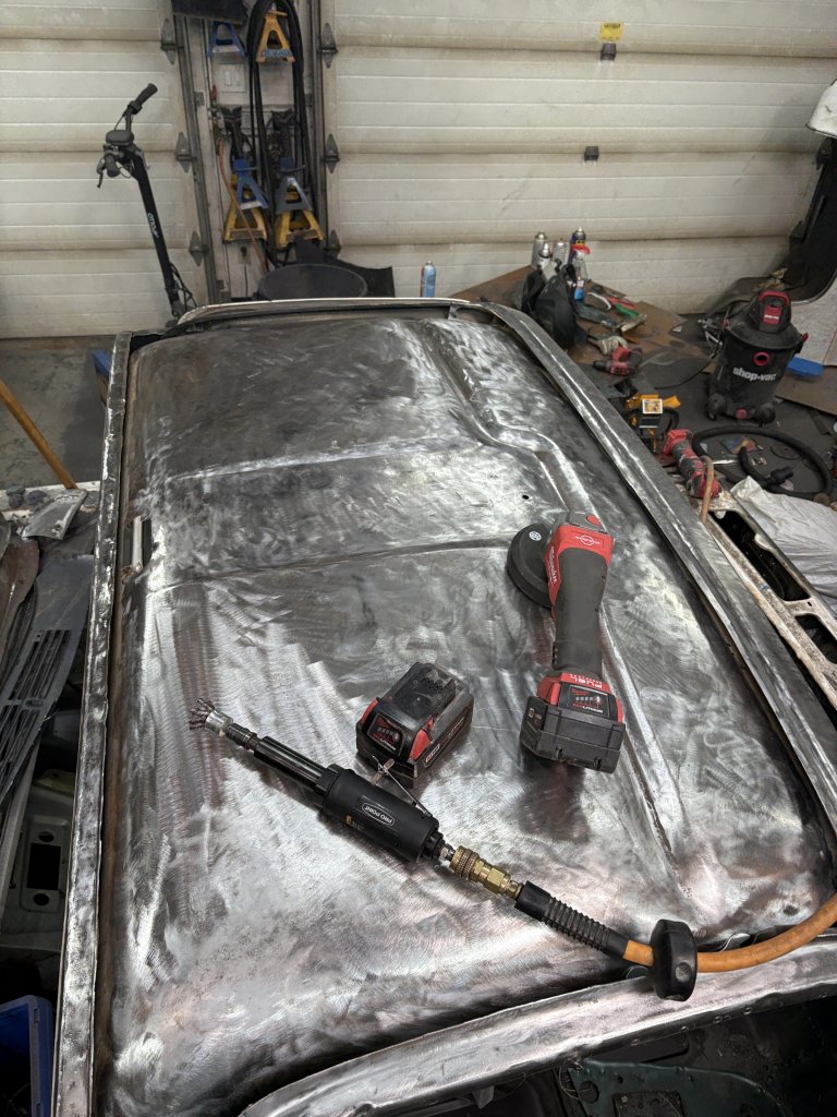

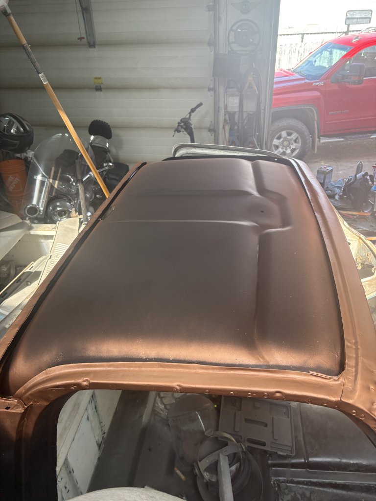

Outer Roof panel primed, sound deadened both to replace what was there originally and have a touch of sound proofing, the AMD panel pretty well set it self in place with the odd tweak and spot welded solid along the front and side edges, just going to spend some time with the back edge welding it solid.

I've done quite a bit of work with tolex. The best way to attach it that I've used is regular old Tightbond wood carpenters glue. Type 1, 2, or 3 wouldn't really matter for a box inside the cab. Works way better than any contact cement, super glue or glue sold especially for tolex. Fender used hot hide glue, which is basically melted dry unflavored gelatin powder. Tighbond dries to a very similar consistency. The only downside is holding it down until the glue dries, I use masking tape to hold it down while it dries. You can also you a straight pin like the ones you get when buying a fancy shirt or pants. Straight pin pushed in far enough to hold it down, but don't leave a noticable sized hole when removed.
