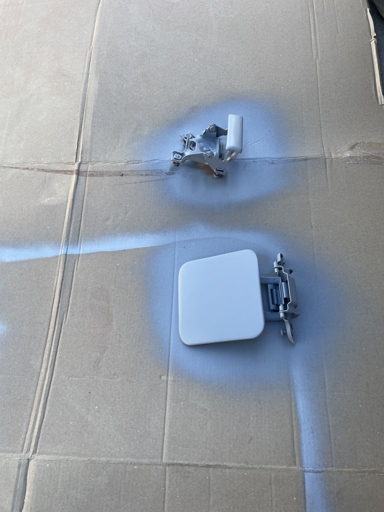

no magic. i didn’t tell you it took 4 times painting them. Waiting two weeks before putting them on. Then they still weren’t fully cured and then yesterday this happened from the tonneau cover. Stripped them all the way down,now using an adhesion promoter, and repainting again today.
I feel your pain. :(
If those are metal, I've had good luck with pre-heating pieces to about 80° before spraying, and then cooking them at around 110-120° afterwards.
Baked enamel finish. You just have to be careful with temperature control. You can end up with a wrinkle finish if you're not careful.

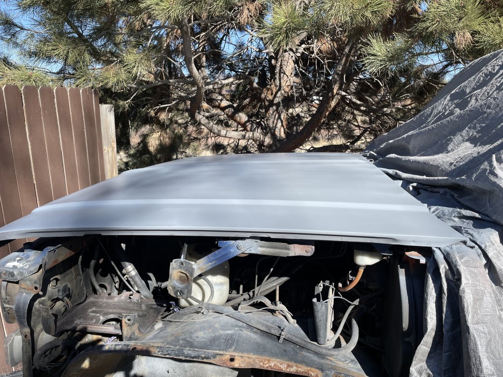

Sanded the hood, epoxy primer again and the two more coats of high build primer. Also sprayed the tailgate handle and fuel door.

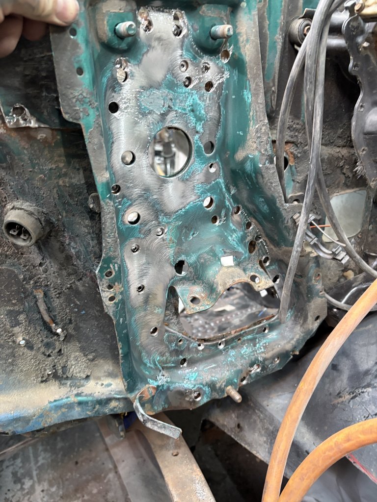

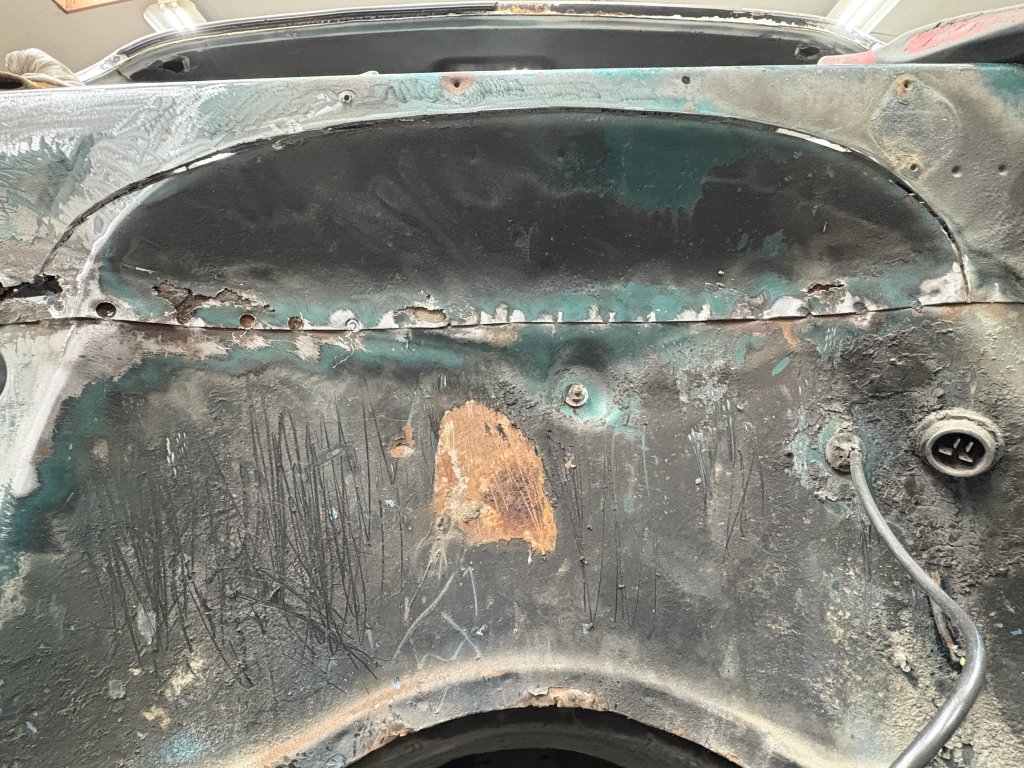

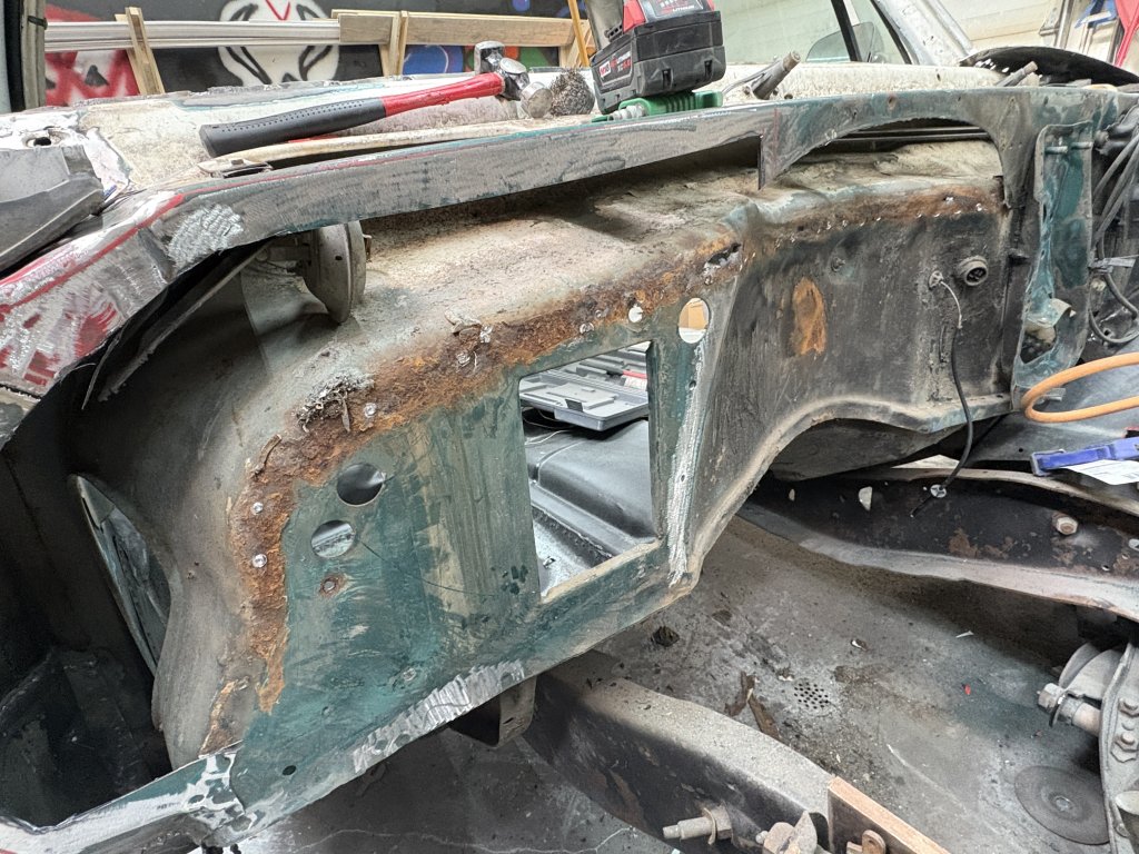

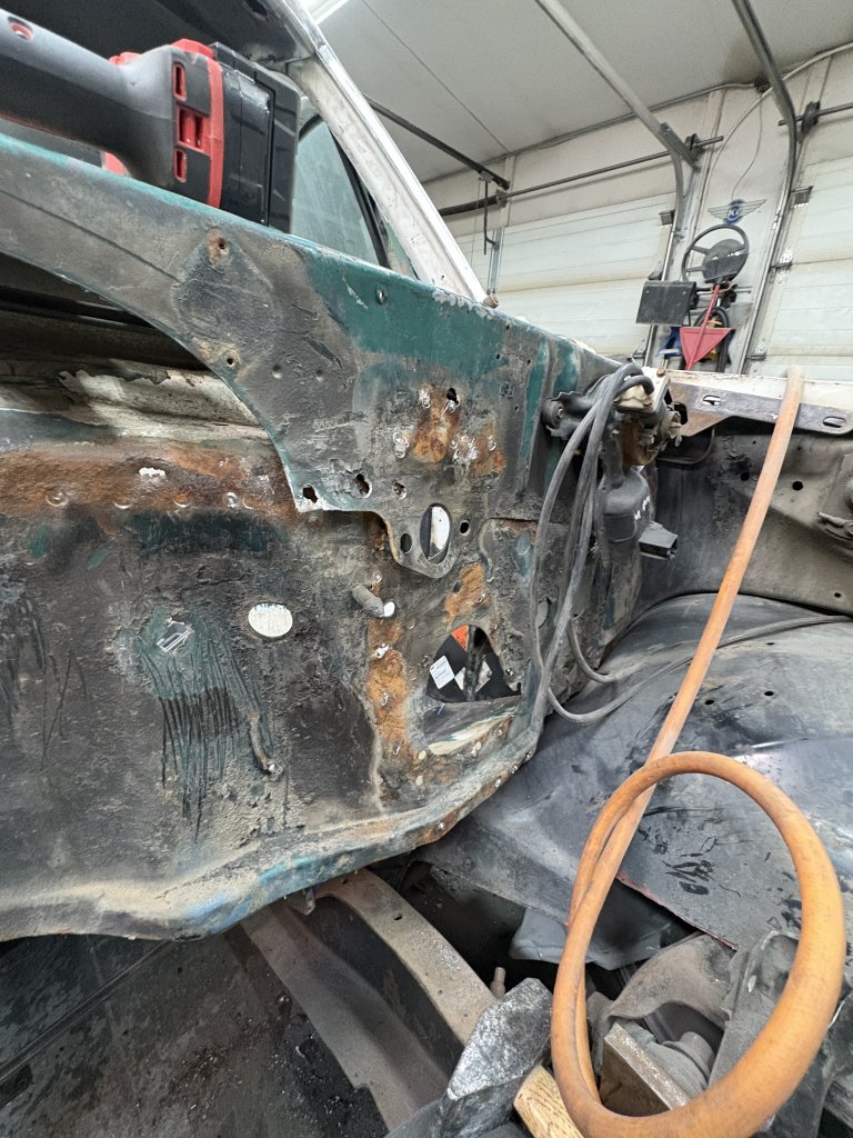

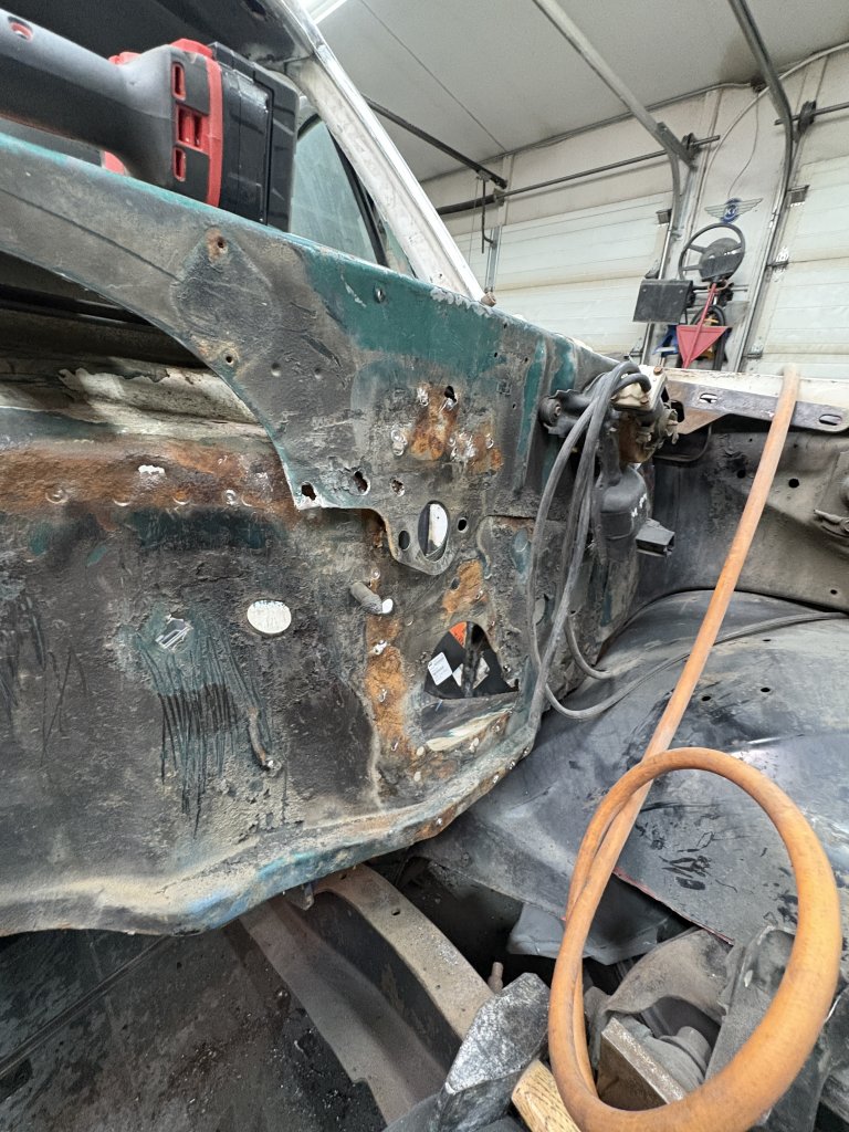

In the process of smoothing out the firewall, commonly found in the rain trays water dirt like to freeze in behind the seam sealer and create a few weak spots easily punched through with a flat screwdriver - lead me to a question - where does a guy get new AM firewall grommets for the wiring/ cables/ harness - or is it going to be all at the wreckers?

they are plastic. i’ve shot them again today. looking good. going to give them a month in the sun before installing them.

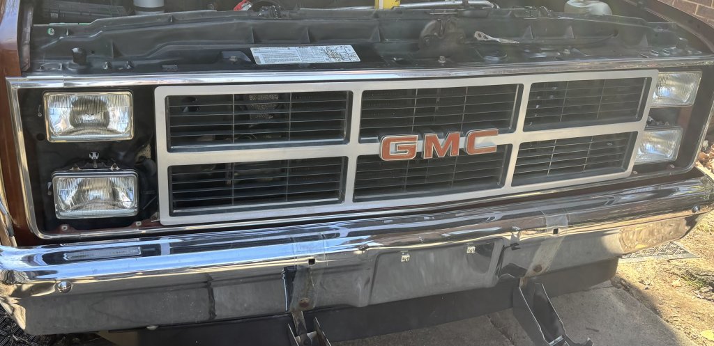

Tightened the valve covers, new 94 amp 12SI alternator, all new v-belts, new headlight adjusters, aimed the new LED headlights.
