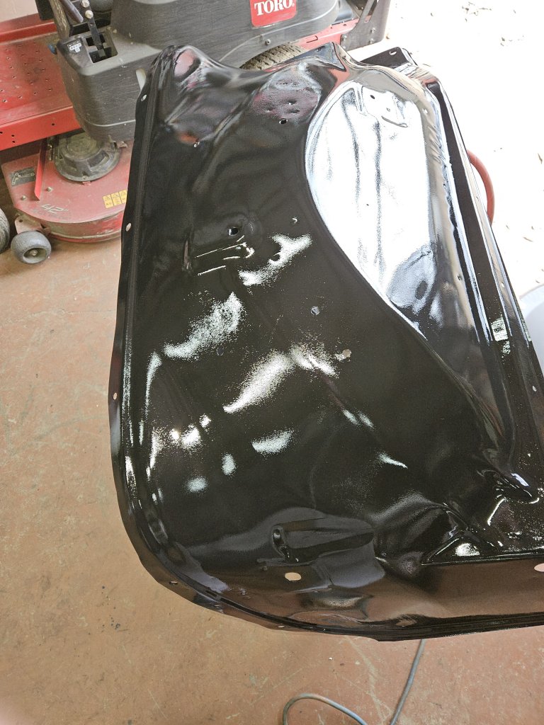

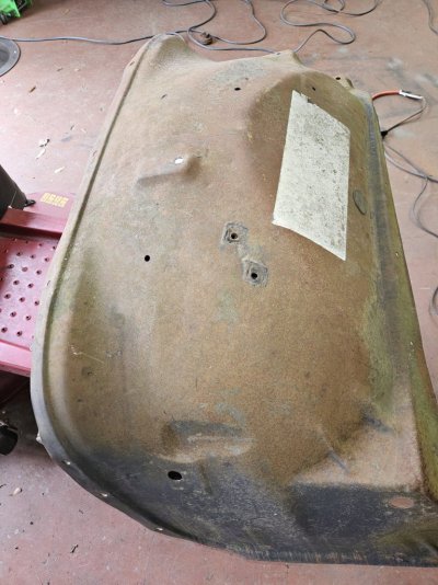

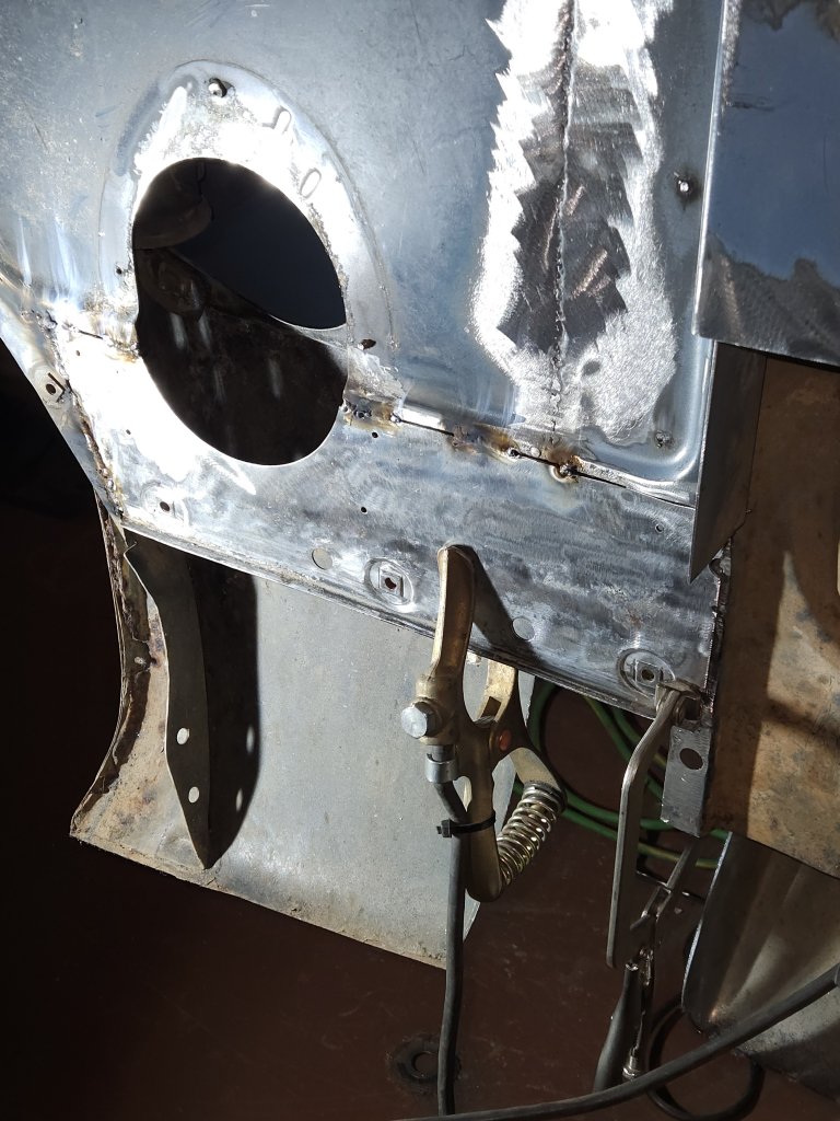

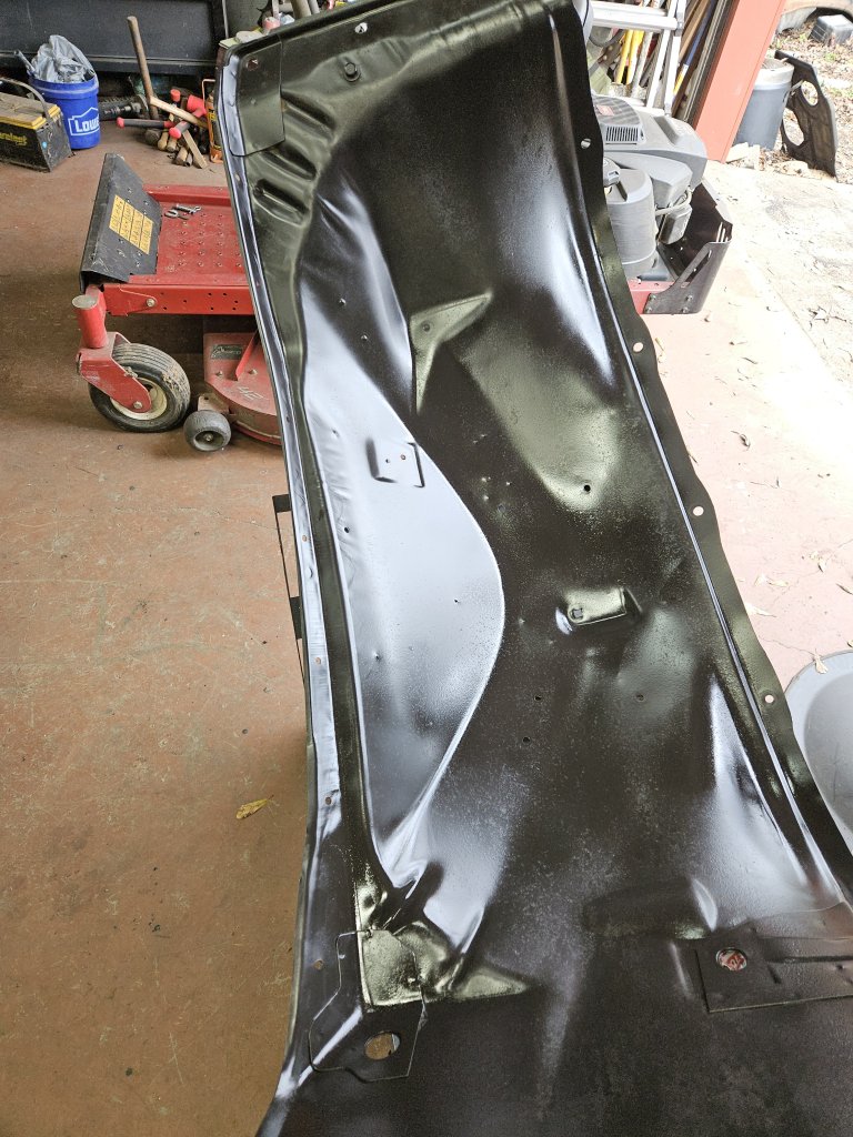

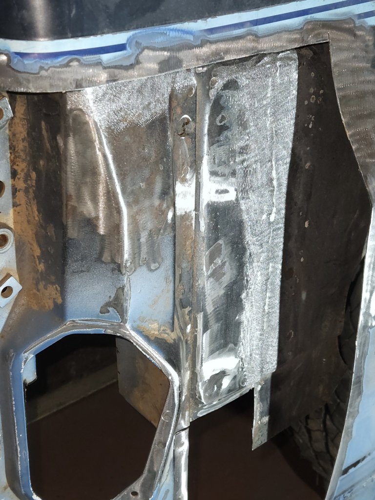

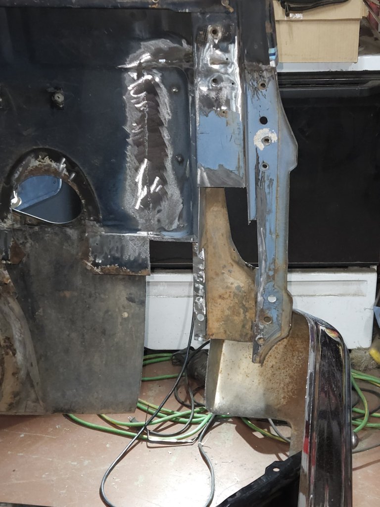

Got a bunch of welding done today. Got quite a bit of the rear put back together. My welding game has improved a bit. Still have some welding to do, but it's coming back together. Also started another project while I waited on welds to cool. Started cleaning up the inner fender wells.
Marine Corps Moderator
11,315
13,896

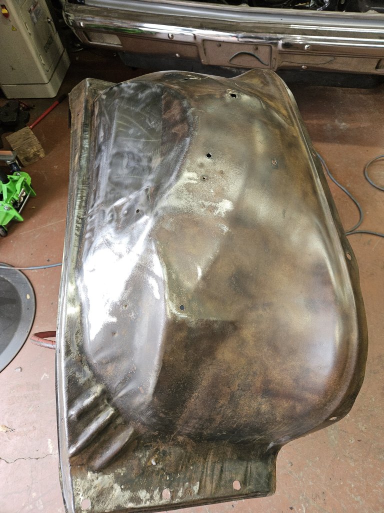

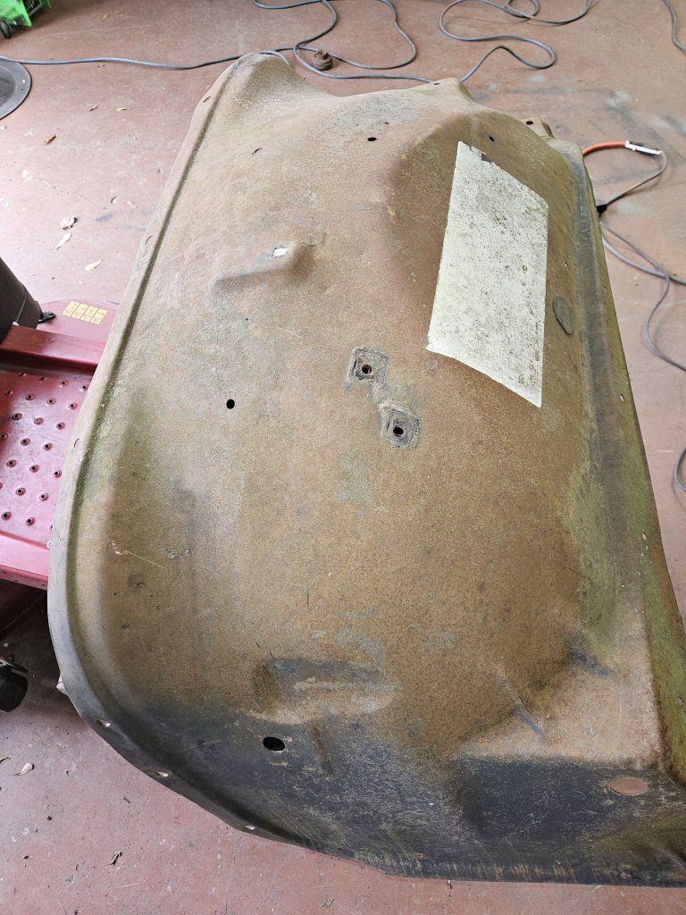

Inner fener well pics...
