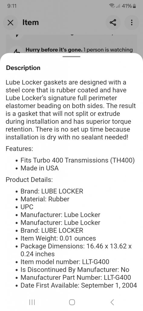

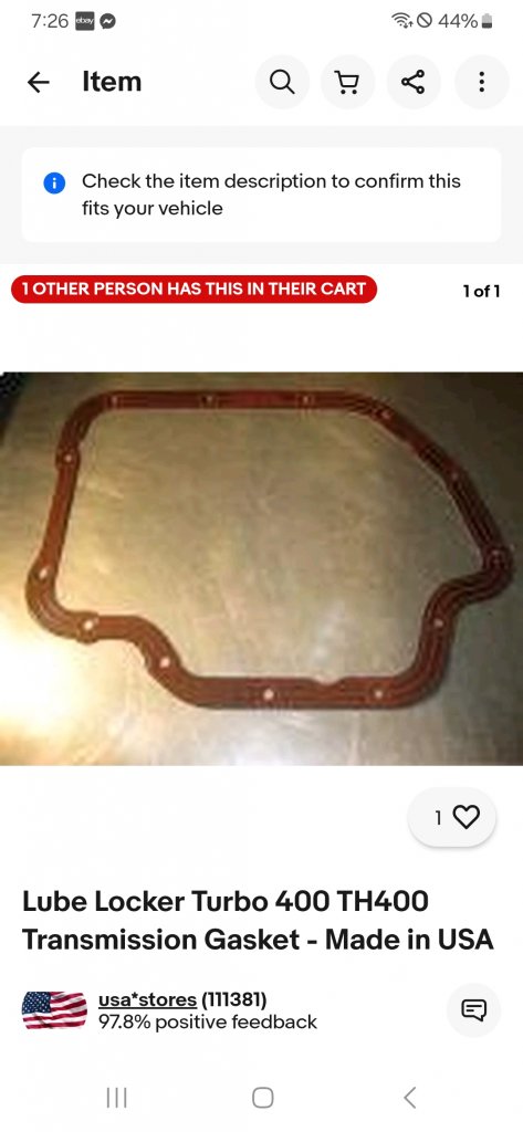

Lube locker gasket if one is available. Have been very pleased with all of the ones I have used. Somewhere around 6 of them, and have two more to be installed. Rear ends and transmissions.
Great gaskets. Every day I look at the floor under my two trucks and every day the floor is dry. Plus you can reuse them if you need to drop the pan for something.
Found one!

It's important to not overtighten the pan bolts too, regardless of the gasket. Steel pans will warp, aluminum pans can crack. I use a torque wrench to make sure they're all tightened evenly to the specified torque.

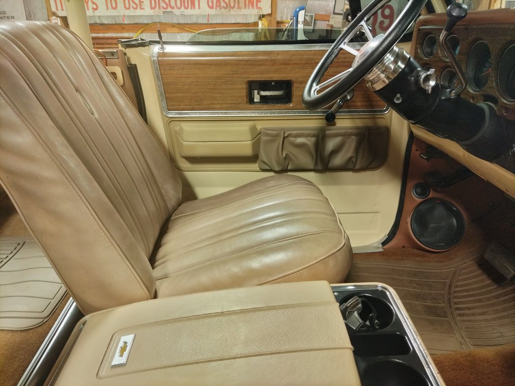

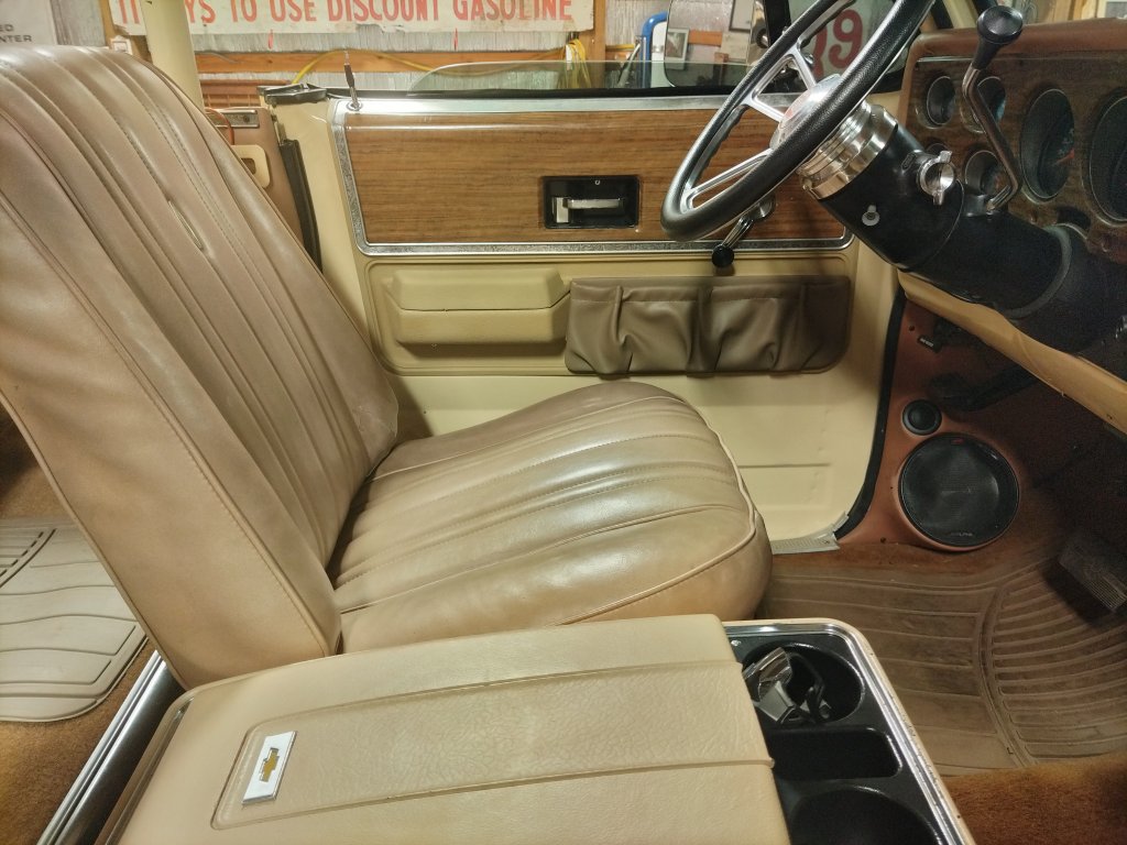

Removed both door panels, lubed the window regulators and dyed the panels and arm rests. Need to do something about the the map pockets. I suspect dyeing won't work on something so flexible so may get wife to make new ones in the correct ( or more correct ) color. Saw a great How To thread here on making new ones.
