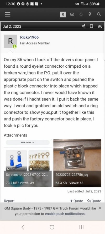

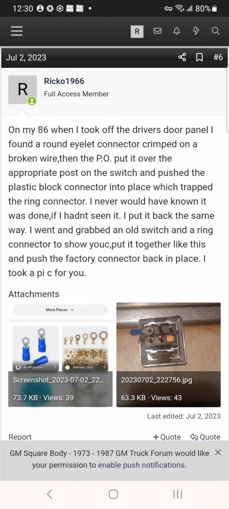

I started snipping wires out and removed the old switch connector. Started stripping the plastic from new wires, then my kids got home from school and my son and I had a date at the new skatepark. I had to pause. Tomorrow I will likely get started before everyone wakes up. Has anyone had to do this with their power windows? I am just not familiar with splicing wires. This connector came with 6 connecting tubes and it seems pretty self explanatory but I also worry I could screw up something relatively simple. Is every strand of copper wire absolutely necessary or would it be ok if a few were snipped off or folded to the side? Getting the exposed wire in the connecting tubes is a little more intricate than I was anticipating. Still feeling optimistic...:emotions34:
Dude you got it. Right wires spliced together, well crimped splice and no bare wire exposed is 90% of the procedure.
Did it come with solder tubes or do mean it came with crimp connectors and maybe some shrink tubing?
Either way unless the connectors are also heat shrink I’d heat shrink all the splices for water resistance. Because inside the door gets wet.
If you lose a few individual strands that is not an issue. Think of it this way. You’re making an extra large wire at the splice. So the length of lesser gauge wire (missing strands) is basically zero. And heat/resistance is a function of length of wire.
Good luck. I gotta tear the door back open on the 77 and replace the window motor. Not looking forward to it. Been procrastinating it and now the weather is cooling down so maybe I can wait til next year…lol.
Are your connector plugs wore out or broken? Just wonderin why they need replaced.

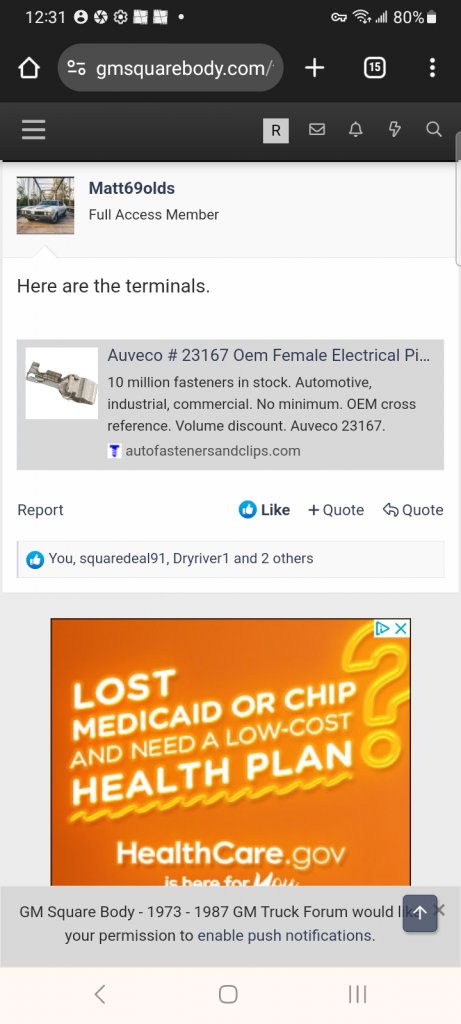

I thought it was the power window motor after trouble shooting so I found one in stock at Advance bought it only to find a wire completely severed leading in to the connector switch. So probably not the power motor but rewiring needed. I ordered a connector switch that I could wire in and replace.
