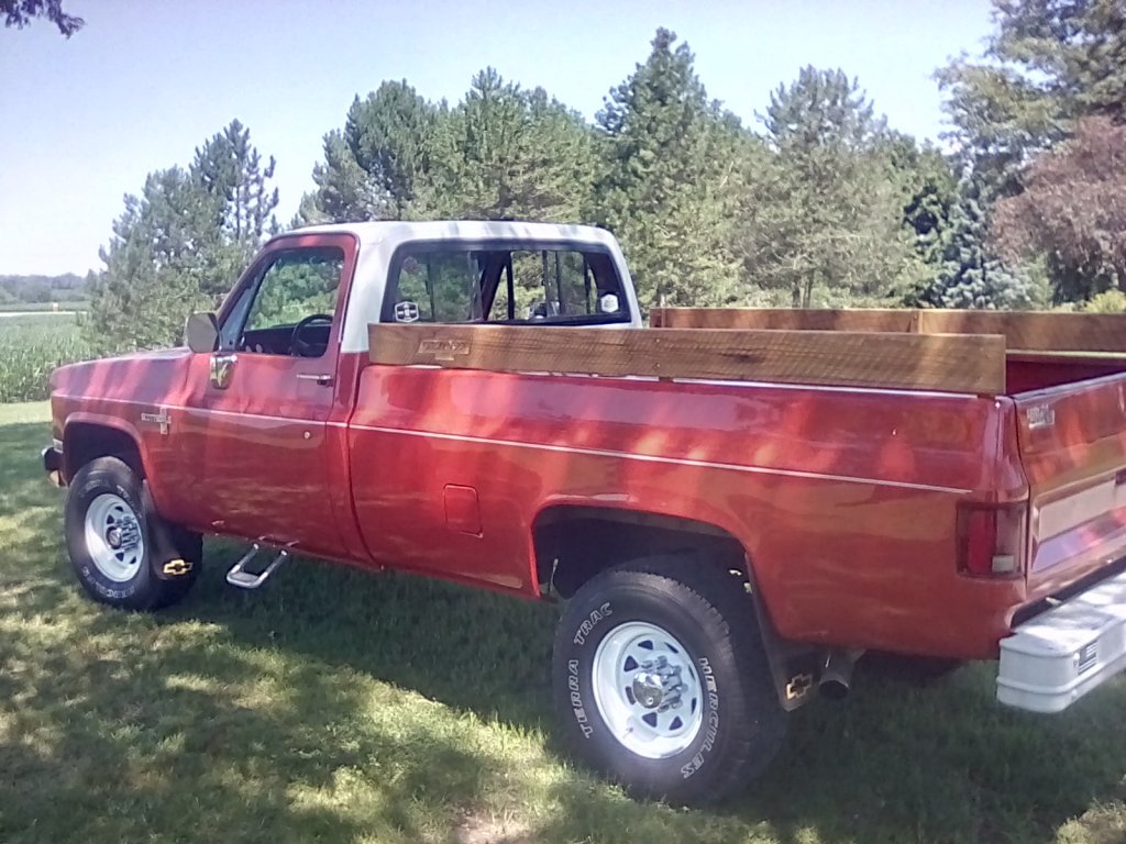

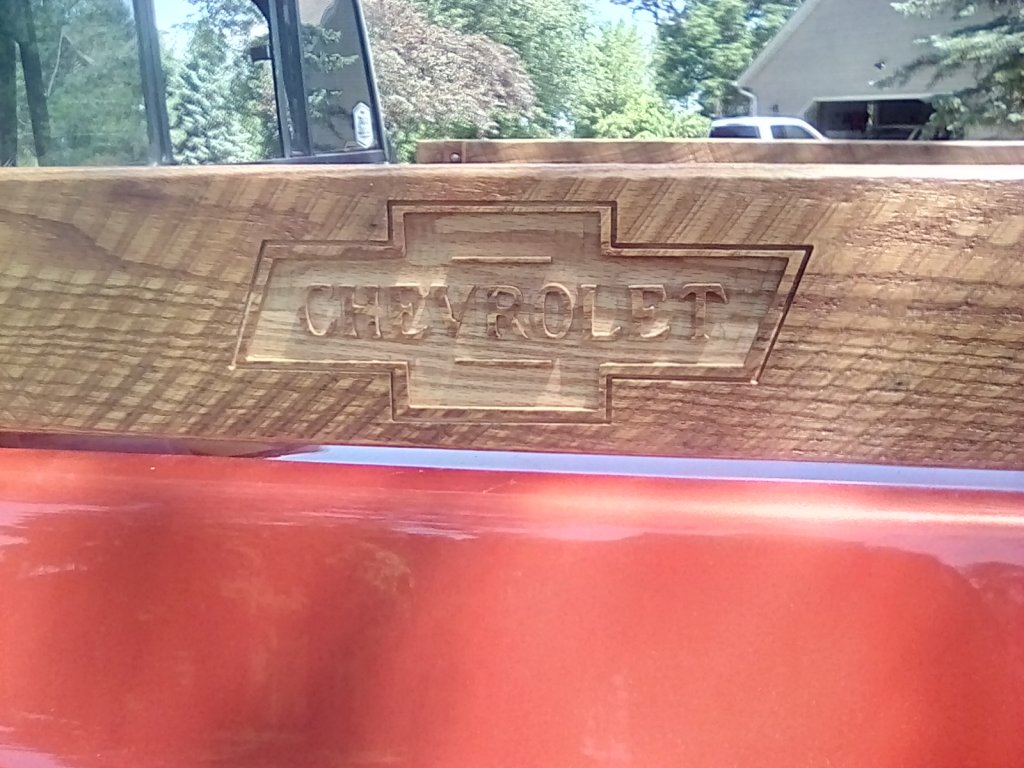

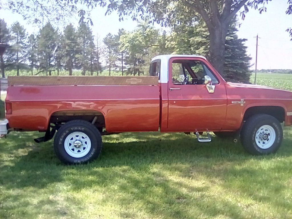

Made up some hardwood side boards. Then, hmmm....fired up the cnc for an added detail.

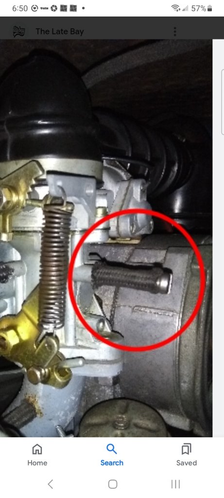

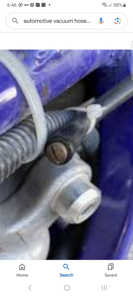

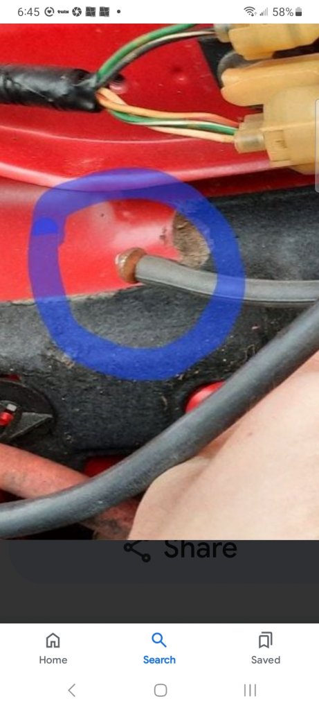

Took care of another little issue today the vacuum plugs on my carburetor keep drying out and cracking so I finally got some silicone one’s supposedly rated for high temperature. Will have to wait and see if that’s true.
10,175
19,679
If they don't work,use 1 inch long pieces of vacuum hose,with 1/2 long machine screws screwed into them,some vacuum hoses are the right size you can plug the hose with a crossman BB or checkball. They will last as long as vacuum hose.
