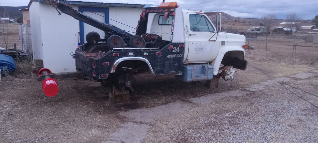

Bought this beautiful piece of crap a while back too. 75 C60 stubby wrecker. Bought it from my friend that runs a junkyard. Was his dad's.
Got it running right there at the yard and drive it a couple miles to my buddies house on tires that we're going flat and no brakes.
Has the nicest factory seat i think ive ever seen in a squarebody. Super clean and comfy.

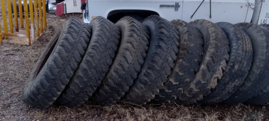

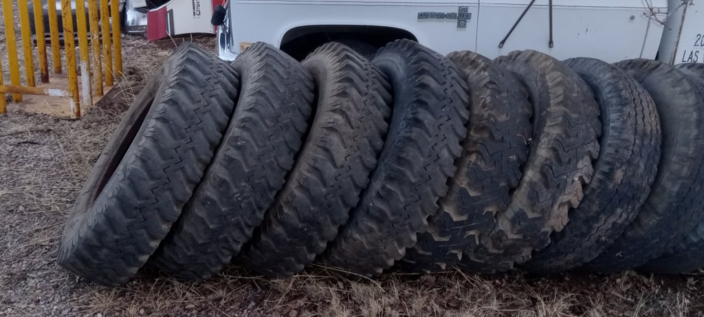

Blocked it up, put it in hover mode, stripped all the wheels and tires apart, and luckily found 4 nearly new tires at the scrap yard.
And yes those are spilt rims. 20in firestone 3 peice split wheels.

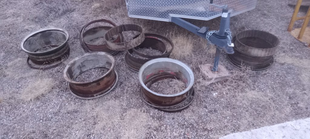

Took all the rims and rings home. Pressure washed, and wire wheeled, and sanded, and ground, all 6 rims, bead rings, lock rings, and 2 rear spacers, down to bare metal, and repainted them. 4 coats of primer, 2 coats of black, 4 coats of silver, and a coat of clear....
Came out pretty nice..
