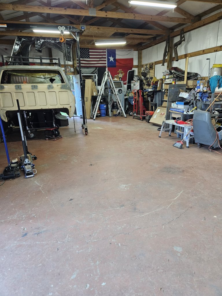

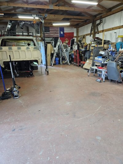

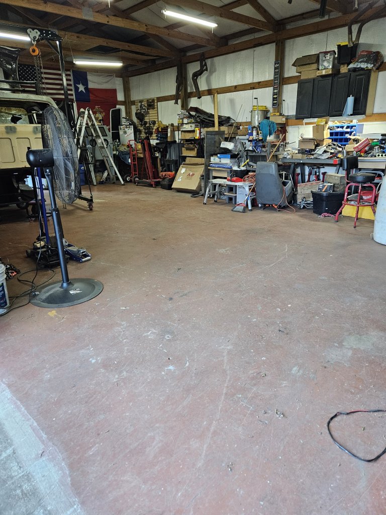

It's not anything I did to my squarebodys, but it's what I did for them... cleaned up the shop rearranged found stuff I forgot about.... yeah BBC parts. Look there is so much room for activities!!!

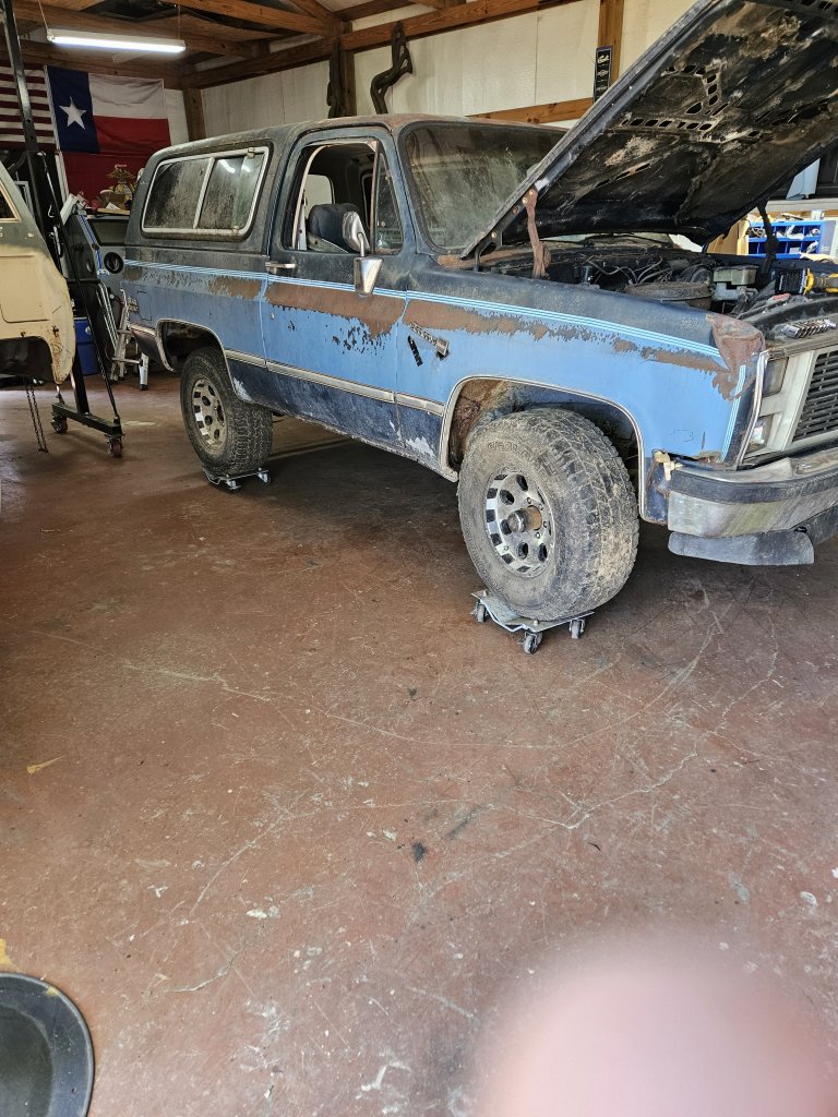

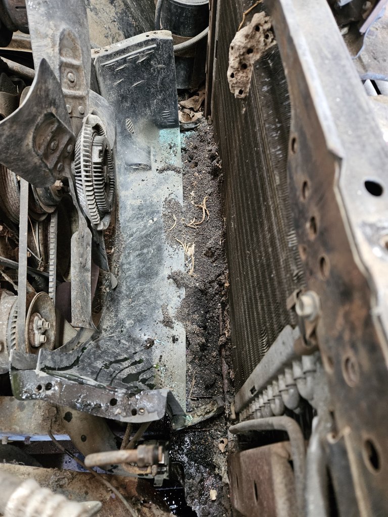

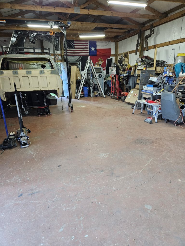

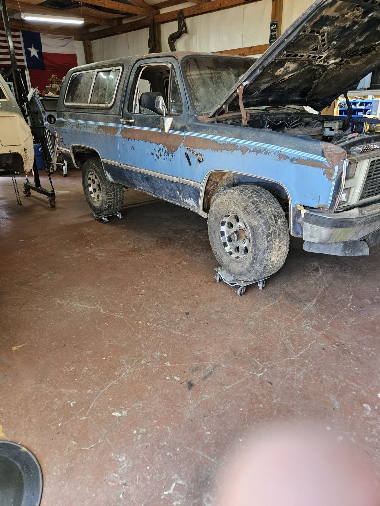

Got the doner Blazer in the shop today. Started disassembly. I forgot what it was like to work on a unmolested truck. There were things I haven't seen in years. The two bars on the transmission dust cover that go up to the motor mounts. Trying to take off everything with care instead of the way I usually do it. Cut all the wires get the motor out. Did find a few things that were disturbing to say the least. All the mouse poo in-between the radiator and the A/C condenser. It seems weird working on a stock hight truck. Mine have always been lifted, or lowered. Hopefully I'll get the transmission out tomorrow.

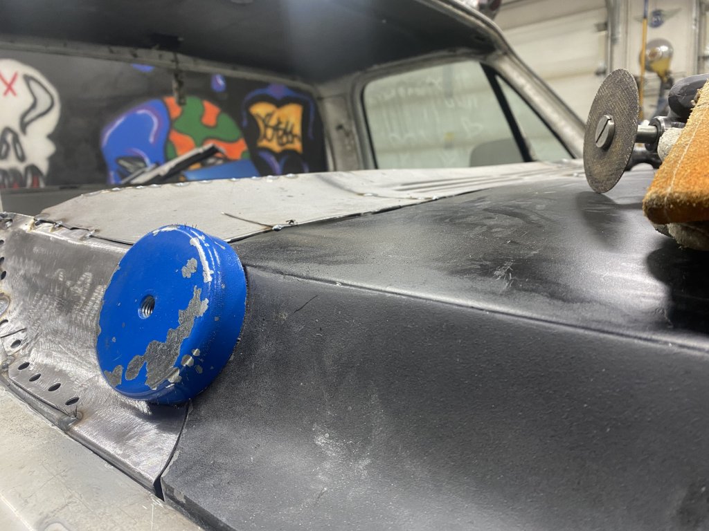

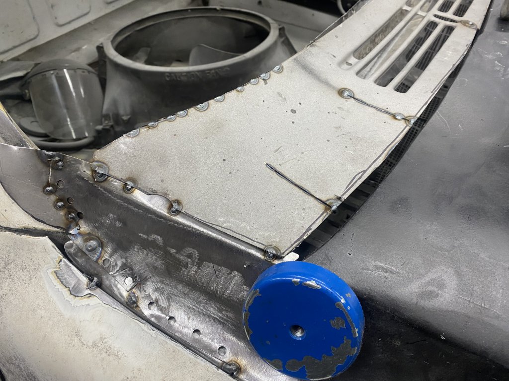

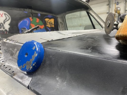

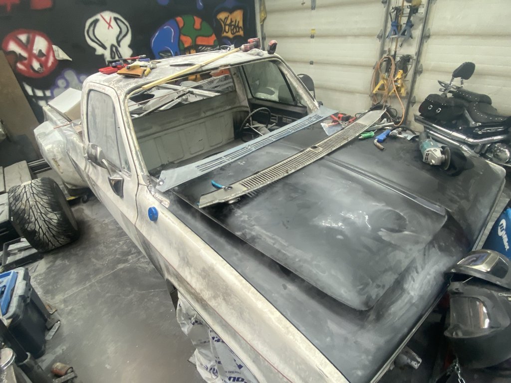

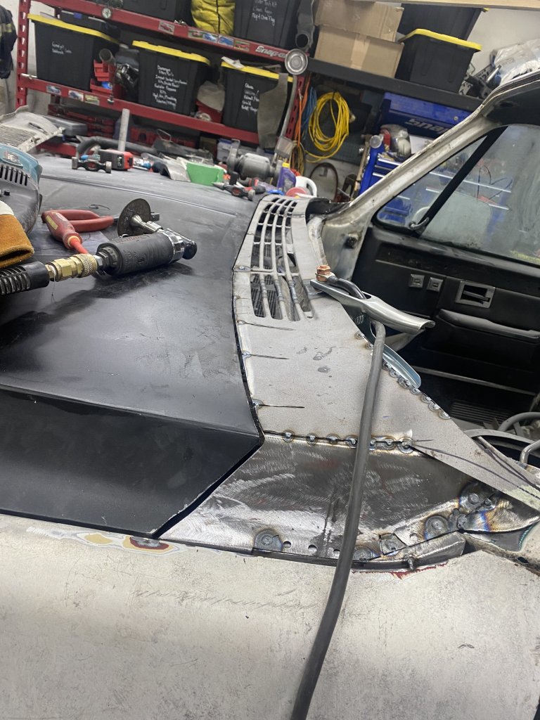

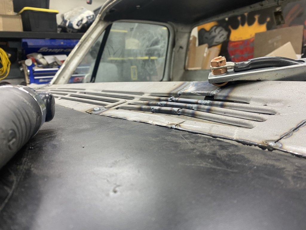

Soon as I started cutting into it twisted, guy I picked up my second cowl from media blasted it before I ever touched this. Some relief cuts had to be made to get the right curvature to the cowling so it followed the hood. Cuts are at the points, I’m glad I smoothed out the wiper holes that have made it a nightmare to untwist this thing.
