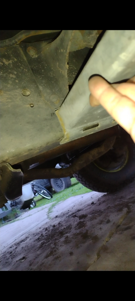

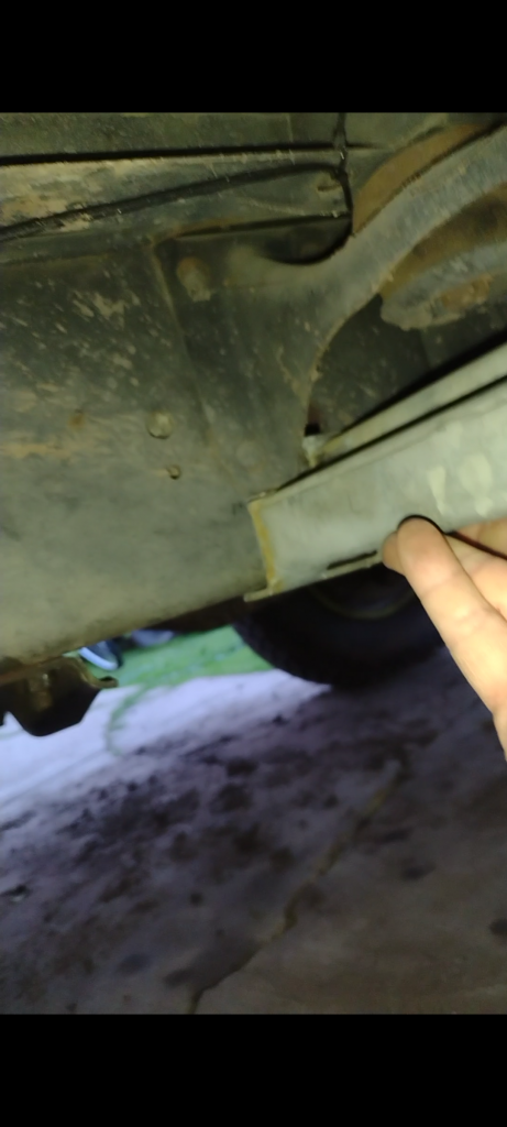

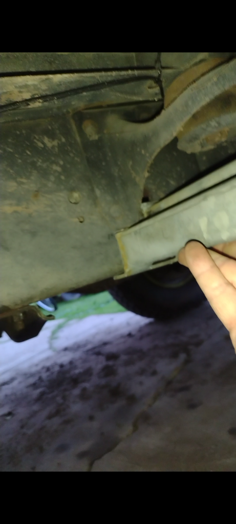

Junk into different junk part 2 rails and outriggers each rail will have 3 points attached to the frame plus 2 braces(one up to the headache rack other to cross beam on the flatbed) plus the fender bars will attach to the bumper and tie everything in, it will basically be a partial exo cage at this point lol before someone says ain't strong enough here's deflection calculator of this box tube vs standard roll cage tube(.120wall dom would bend like a pretzel in comparison) I no doubt it will be stronger than a Toyota or dodge frame lmao

Here's a comparison per ft

Front outriggers will fit nicely under the front body mounts following the frame back just before the frame turns up another outrigger rear one will go under the fuel tank and will have a 90 up to the frame rail(plus the 2 supports from the flatbed/front fender bars) 6points of contact overall)(also I'm not building a rock crawler this is mainly for fuel tank protection with extra steps lol)

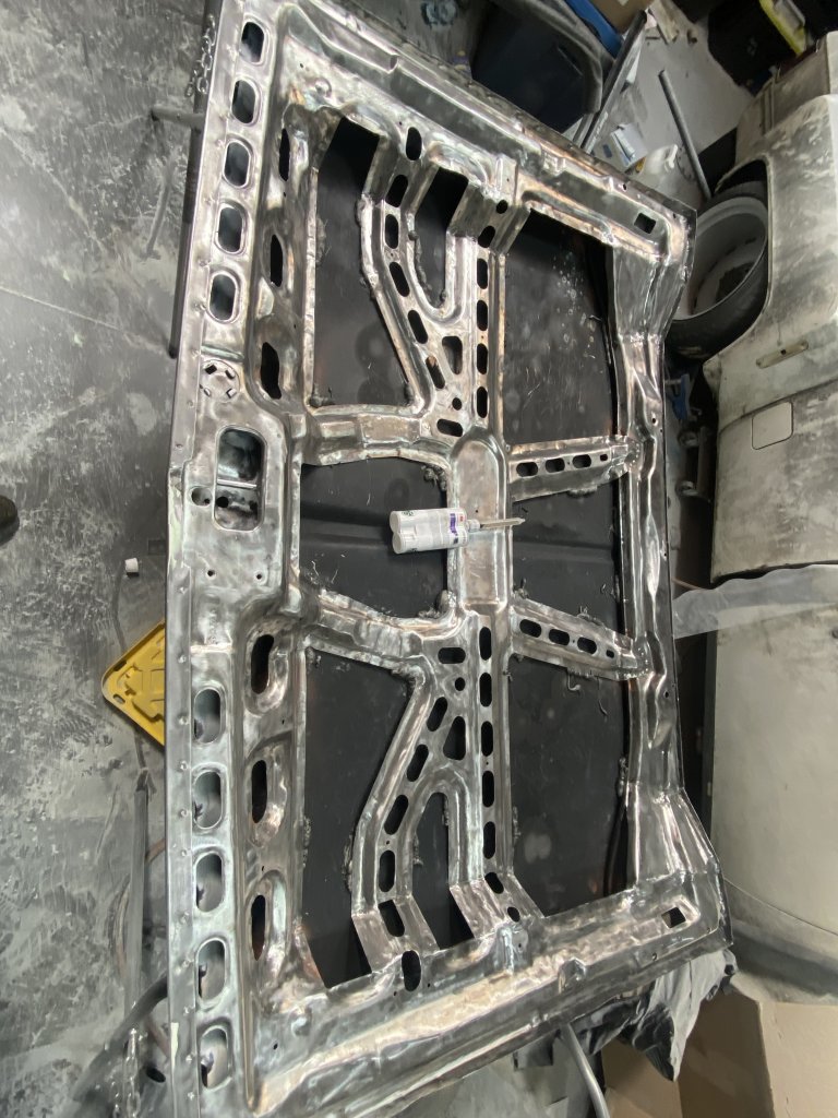

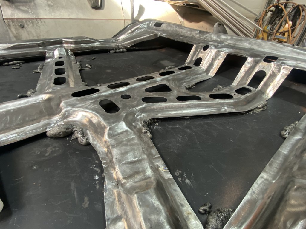

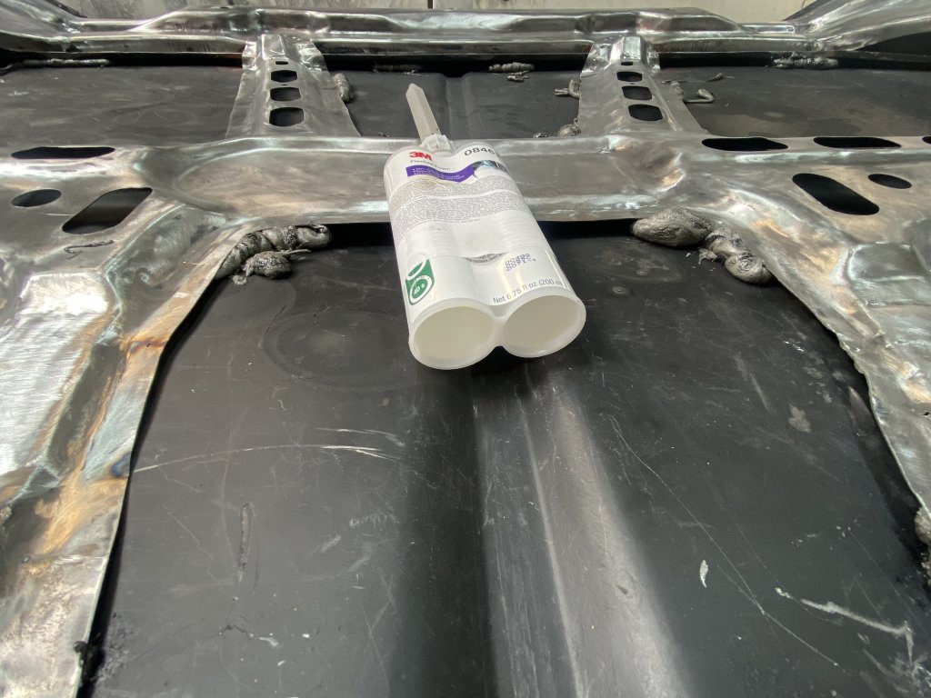

Took some flex out of the hood today with 3m flexible foam
